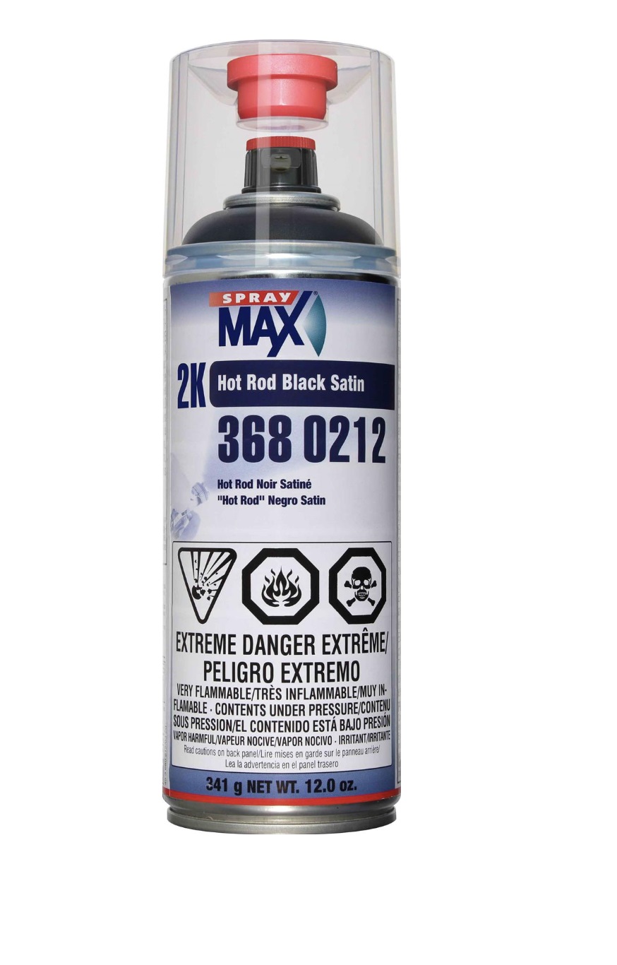

Try a magnet on the bright trim to see if it's steel or aluminum. My recollection is that Porsche used both over the years, though I don't profess to know which they used in '78. If it is steel and chromed, painting can be a challenge, and would push me toward getting a matching bright one for the black piece if your primary goal is just to get them to match. There are primers that are said to work over chrome, but I can't vouch for them. If they are all aluminum and easily paintable, I'd encourage you to use a catalyzed automotive paint. Wurth makes excellent products, but catalyzed paints are way more resistant to chemicals and fading. Paint something with the Wurth and then spray a little brake cleaner on it to see what I mean. They now sell catalyzed paints in spray cans to make it easy. The catalyst is in an internal compartment that you break open to mix and activate the paint before spraying. I have a local paint shop that mixes any color you want, but for black trim, lots of retailers stock it. See, for example....
https://www.summitracing.com/parts/sym- ... IAQAvD_BwE
