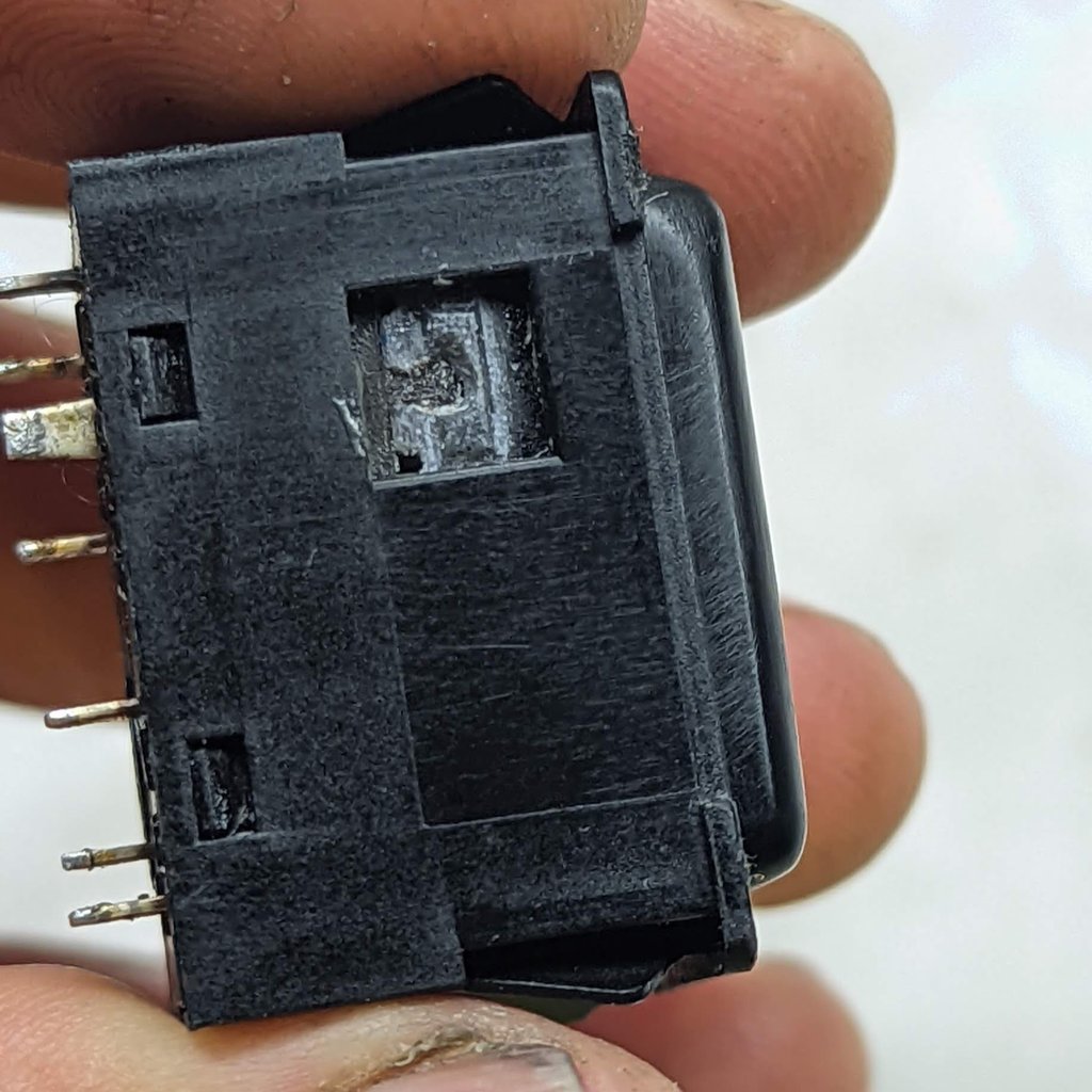

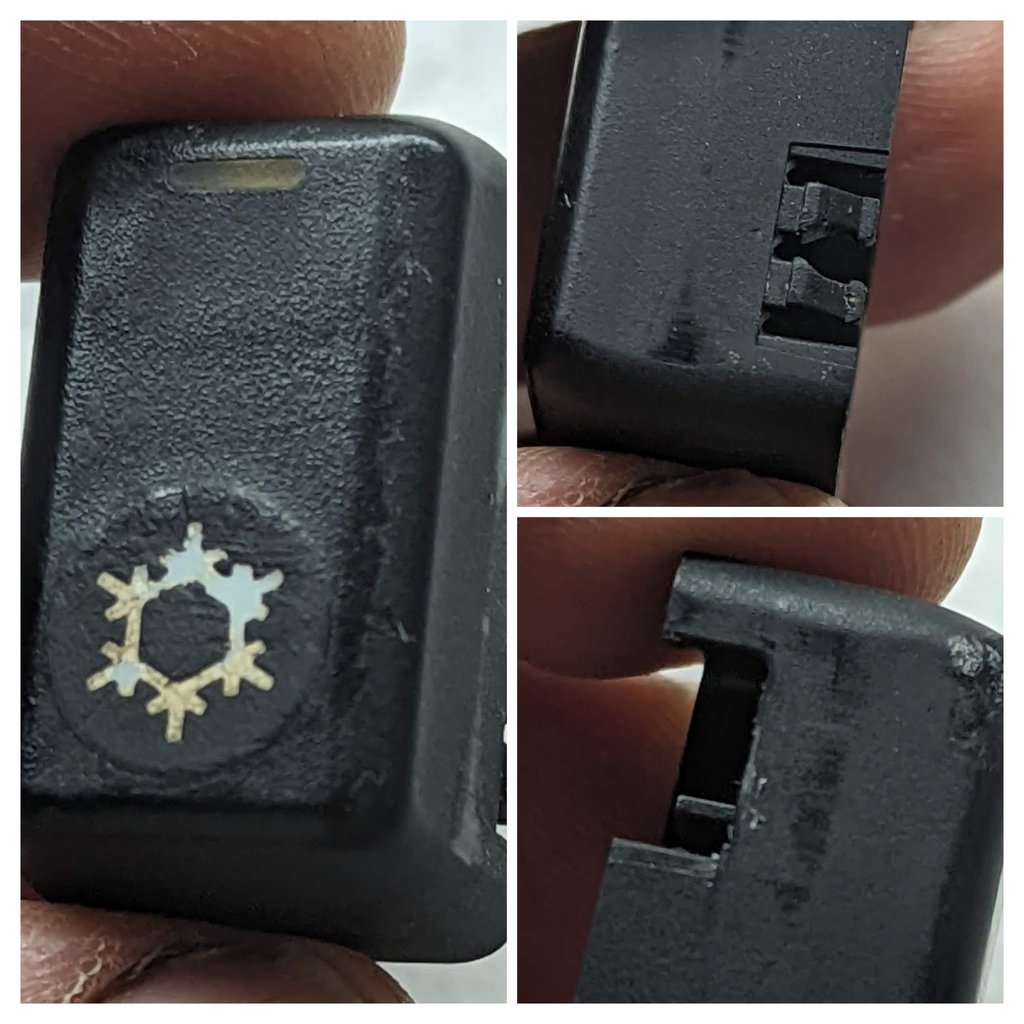

Over the years I have accumulated several climate control units. Many have broken switches. More correctly, the little integrated tabs that hold the button to the switch assembly have broken, making the button/cover come off.

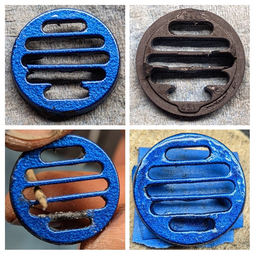

Also, some of the defrost/footwell slider knobs have broken internal tabs, which means those knobs simply fall off.

Broken Snowflake Switch Tabs, and other Climate Control Buttons
Broken Snowflake Button Tabs
Broken Climate Control Button Tabs

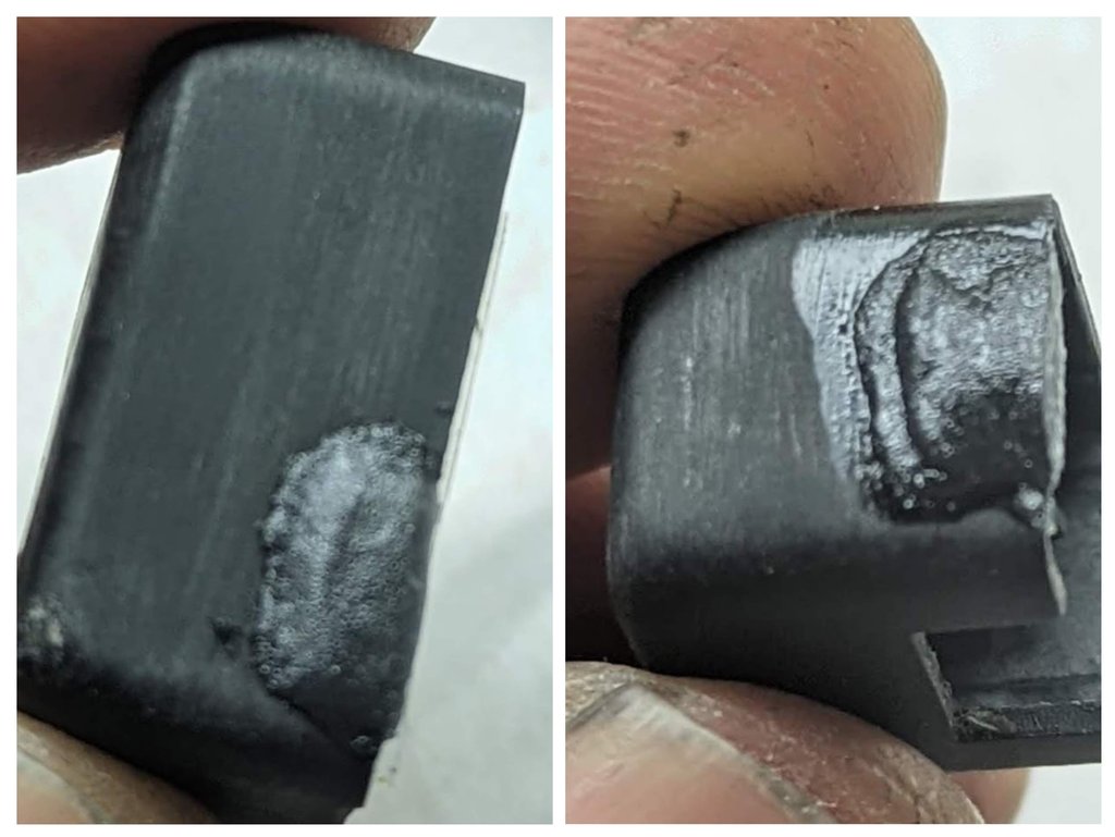

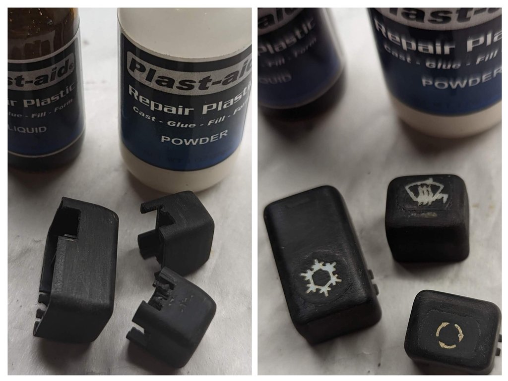

Building Up a Blob of Plast-aid repair
The kit includes a small plastic cup that does not chemically bond, making it ideal for mixing. I put some liquid component into the mixing cup, sprinkled in powdered component, and stirred. I added powdered component until i had the consistency I wanted. Then I colored with a couple toothpicks-full of black acrylic art paint.
You have about 15 minutes of total work time. The product starts out pretty fluid, but not runny. Then starts to become more paste-like, by design. It allows you to make more complicated shaping as the product starts to "kick".
It would be handy to use a small eye dropper or pipette (like from chemistry class) to handle the liquid component, as pouring it from the bottle will ultimately result in using too much or spilling it down the side of the bottle. Take care to not knock the tiny bottle over when working with it on your workbench. The powdered component is useless without it.
Use in a well-ventilated area. The liquid component has a powerful chemical smell that can't be good for prolonged exposure. Never mind flammability.
Blob of Repair
Blob of Repair

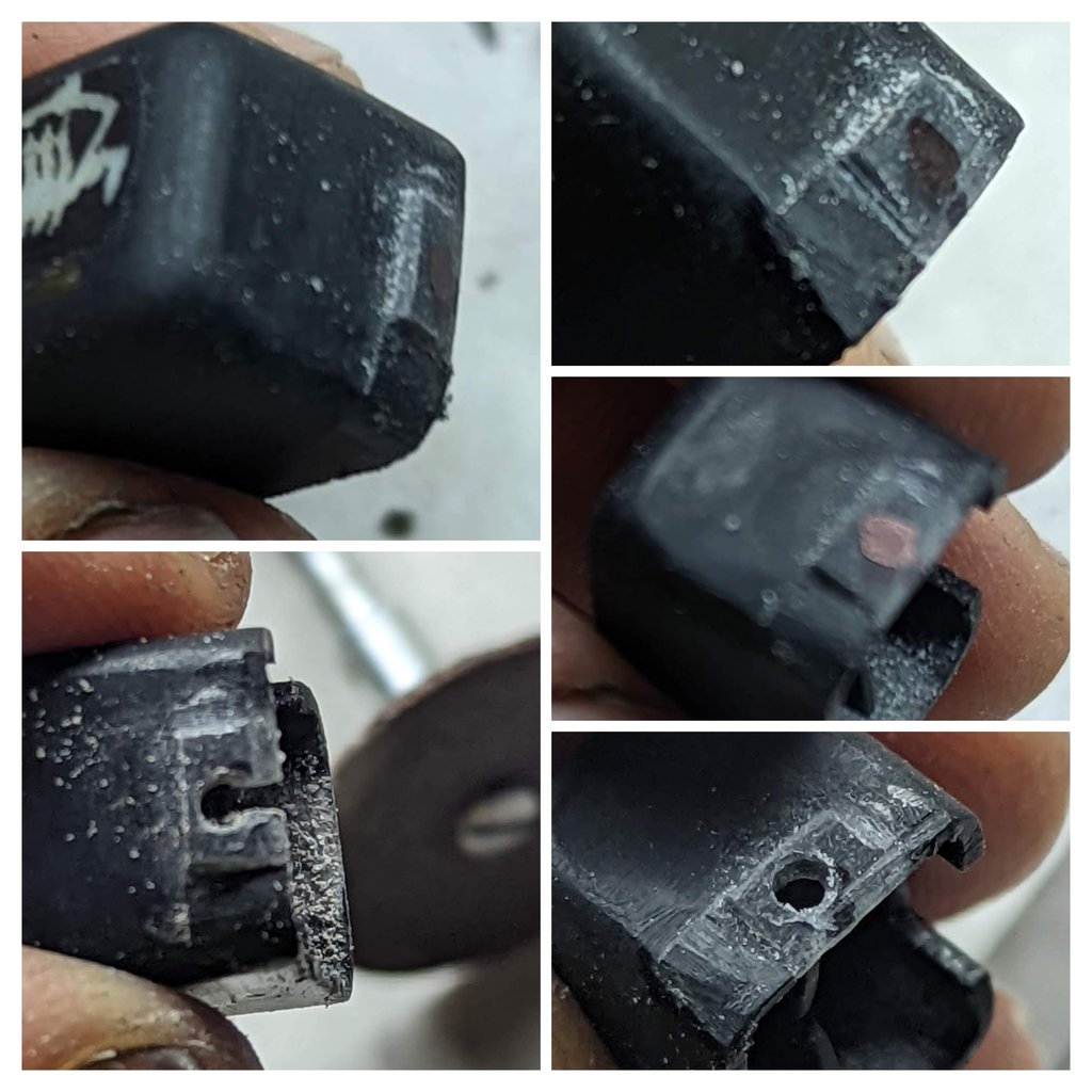

Shaping the Repair
Prior to applying the product, I used a small piece of cellophane tape on the inside of the button to make a flat inside surface.
After it hardened, I used small hand tools to gradually work the outside blob into shape.
Shaping the Repair
Shaping the Repair

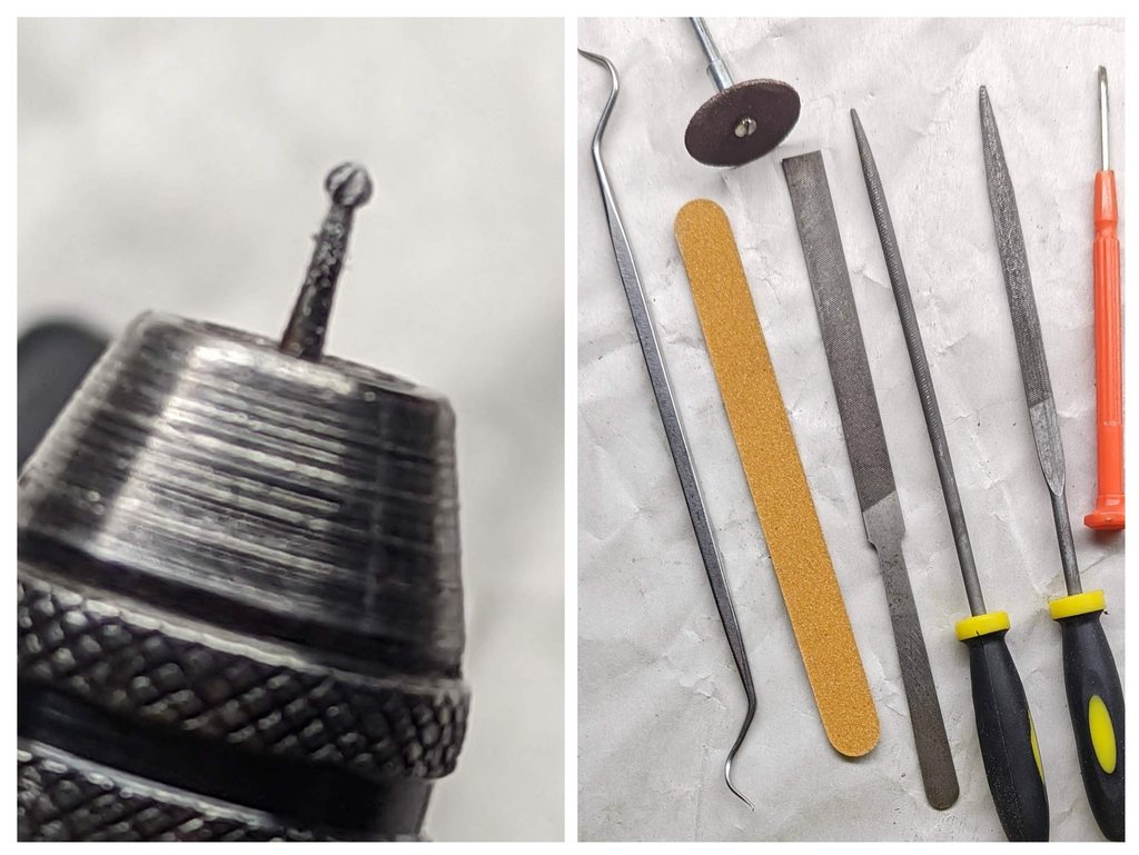

Tools
With the exception of the tiny ball tool in the Dremel, I used only hand tools to shape the repair. I used the Dremel cutting disk by hand to make the slot.
Remember, power tools are great - they allow you to make mistakes faster.
Tools
Tools

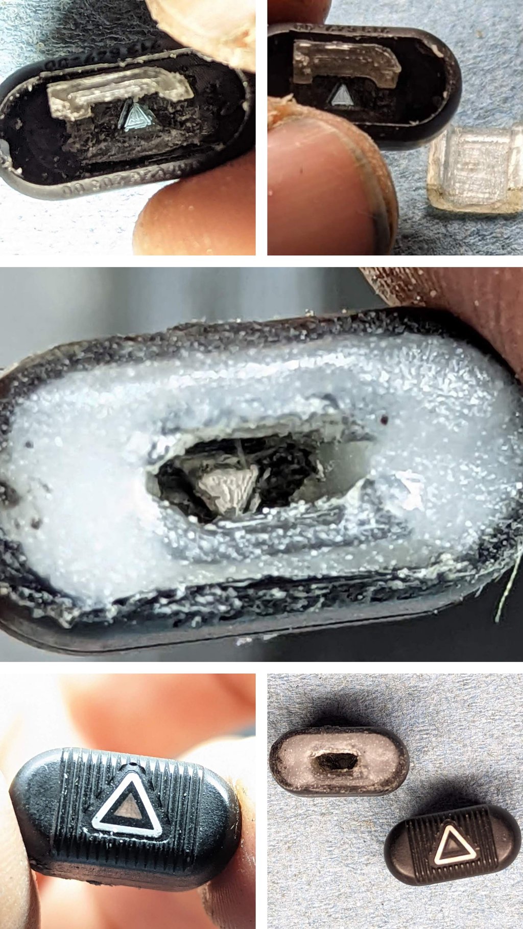

Finished Repair
Even though I showed a different climate control button in "Shaping the Repair" section, the snowflake switch is shown below. The idea is the same regardless. I worked the repair until it fit properly inside the switch outer housing and latched onto the little nib where it engages with the moving portion of the switch mechanism.
This is fussy, tiny work. But it it do-able.
Finished Snowflake Switch

Climate Control Slider Knobs

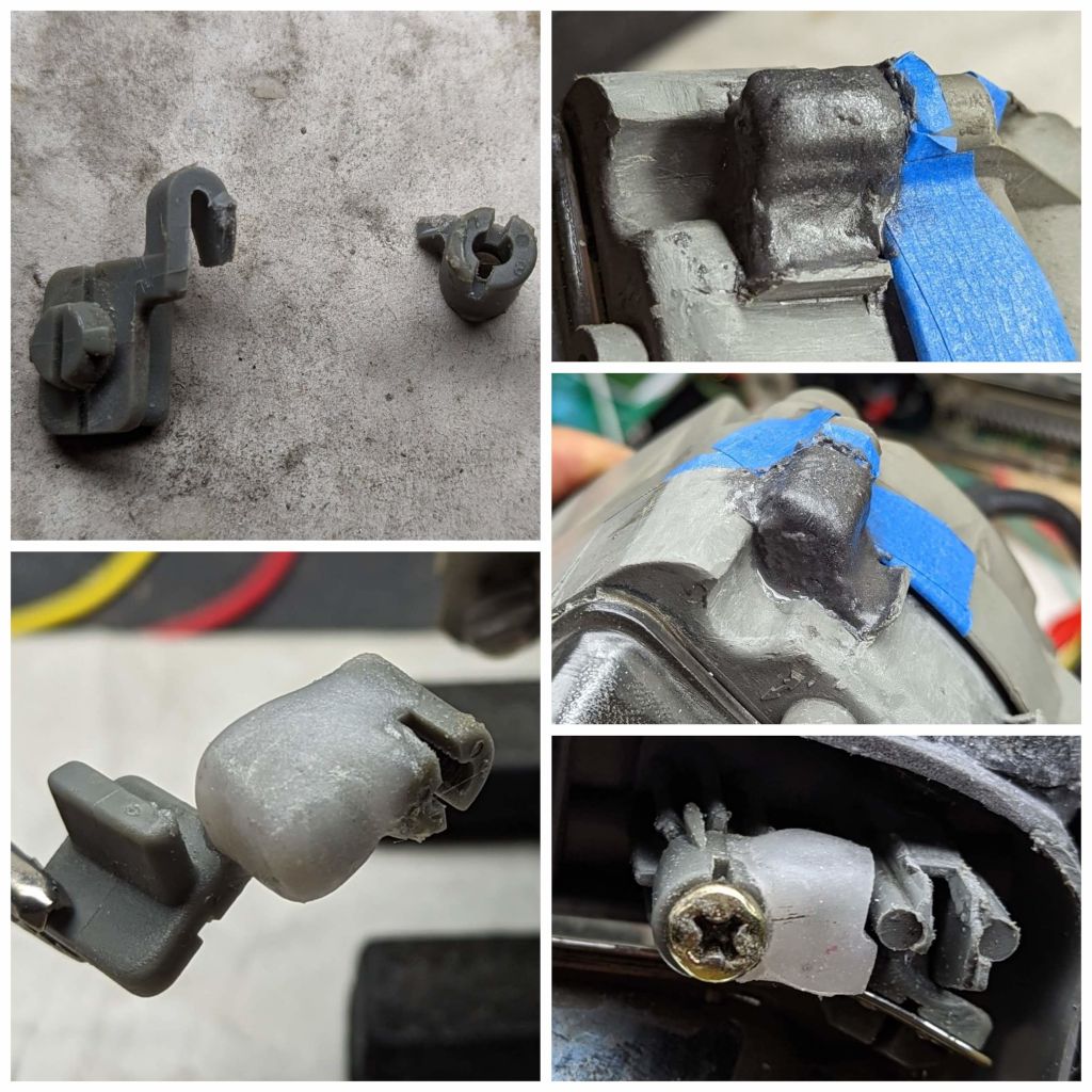

Turbo/S2 Fog Light Reflector Adjuster and Outer Housing
Tinted gray using acrylic art paint.
Fog Light Repairs
Fog Light Repairs

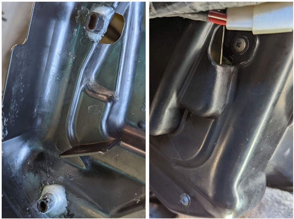

More Uses for Plast-aid
HVAC Flap Motor Cover

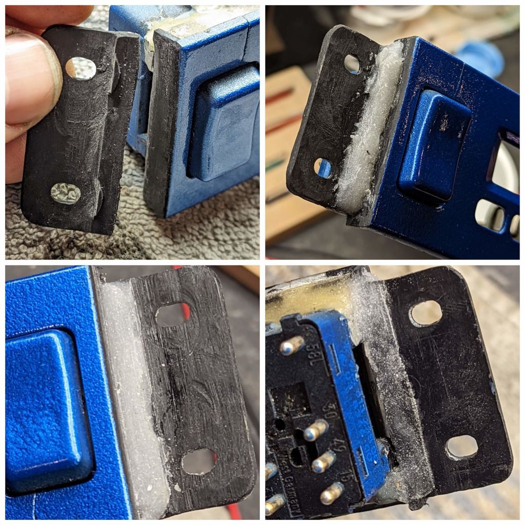

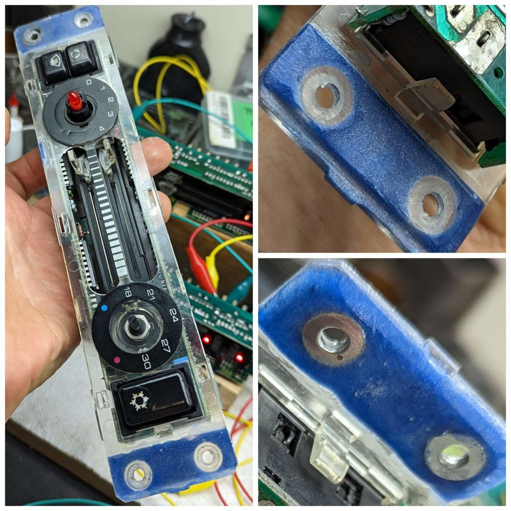

Dash Plastic Tabs
Removed oval ridges that originally accepted back side of fragile screw holes on climate control unit acrylic face plate.
Dash Plastic Tabs
Dash Plastic Tabs
Climate Control Module Face Plate Screw Holes
Captive small stainless washers where hole was broken and missing. Thick for reinforcement. Blue because I felt like it.
