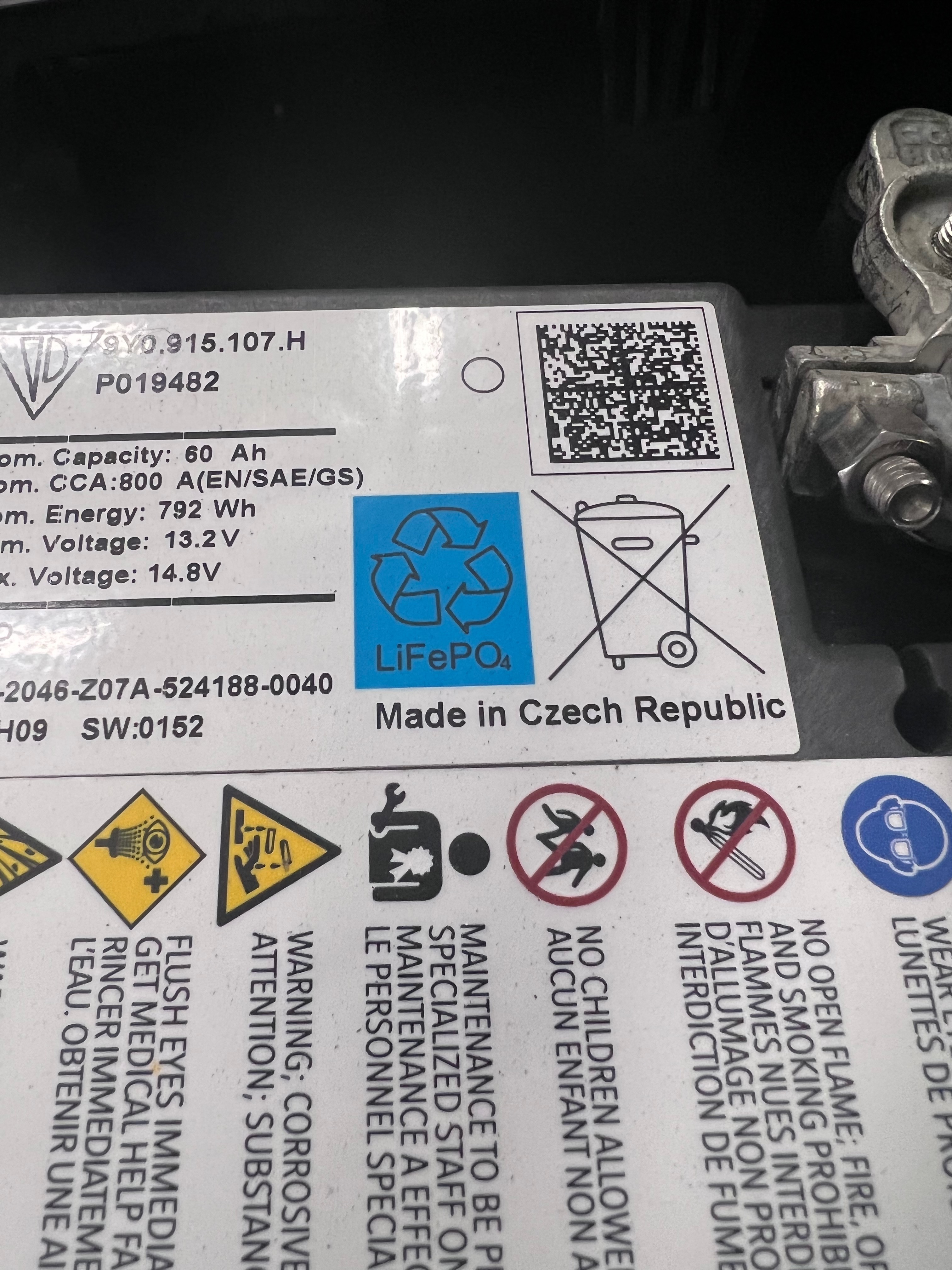

Well, you are in good company thinking those would be good batteries for a Porsche. When you first mentioned it this morning, I started wondering about my 992 lithium battery and, sure enough, it is a Lithium Iron Phosphate battery!

I have documented and shipped a lot of DG by air over the last 20 yrs. Tom, 792 wh's is pretty damn healthy. The most powerful LiFePO4 I've ever shipped was four 488 wh drone batteries from Scott Base, Antarctica to NZ. The limit per battery by air is 160 wh IIRC so I needed high-level waivers to permit carriage.

Not an expert by any means, but I think that's why '12 volt' lithium car batteries have the complicated Battery Management System (BMS) built into them. I learned the hard way with my 992 that, inside the battery, there is a full-on computer/processor that manages the lithium batteries inside. If the charge gets too low, it just cuts off all connection to the batteries inside, in addition to managing the charging process. Lithium batteries without protection from a BMS are not well-suited to the auto charging system, based on everything I've seen -- partly for the reason you bring up. They also don't like heat very much, so my rear-engine 992 is probably a better environment for a lithium battery than the engine compartment of a 944. Needless to say, there are companies marketing Lithium Iron Phosphate batteries for cars, including some that fit the 944, but they are not cheap, and some in my opinion are little more than salesy-middlemen with questionable ethics. Take a look at the lithium batteries sold by Summit Racing. They have several group 48 lithium batteries set up for automotive use, and they ship straight from the supplier...
