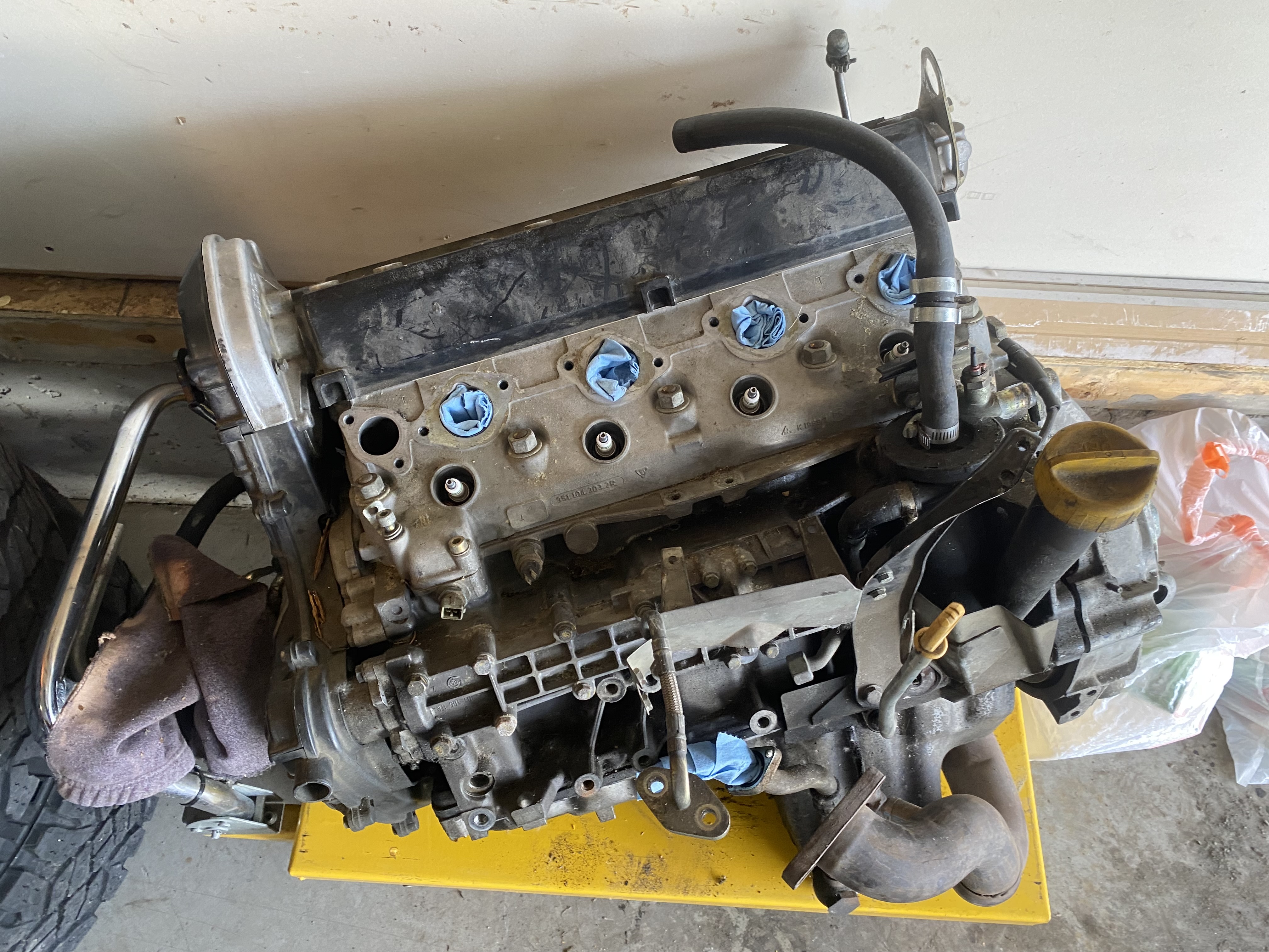

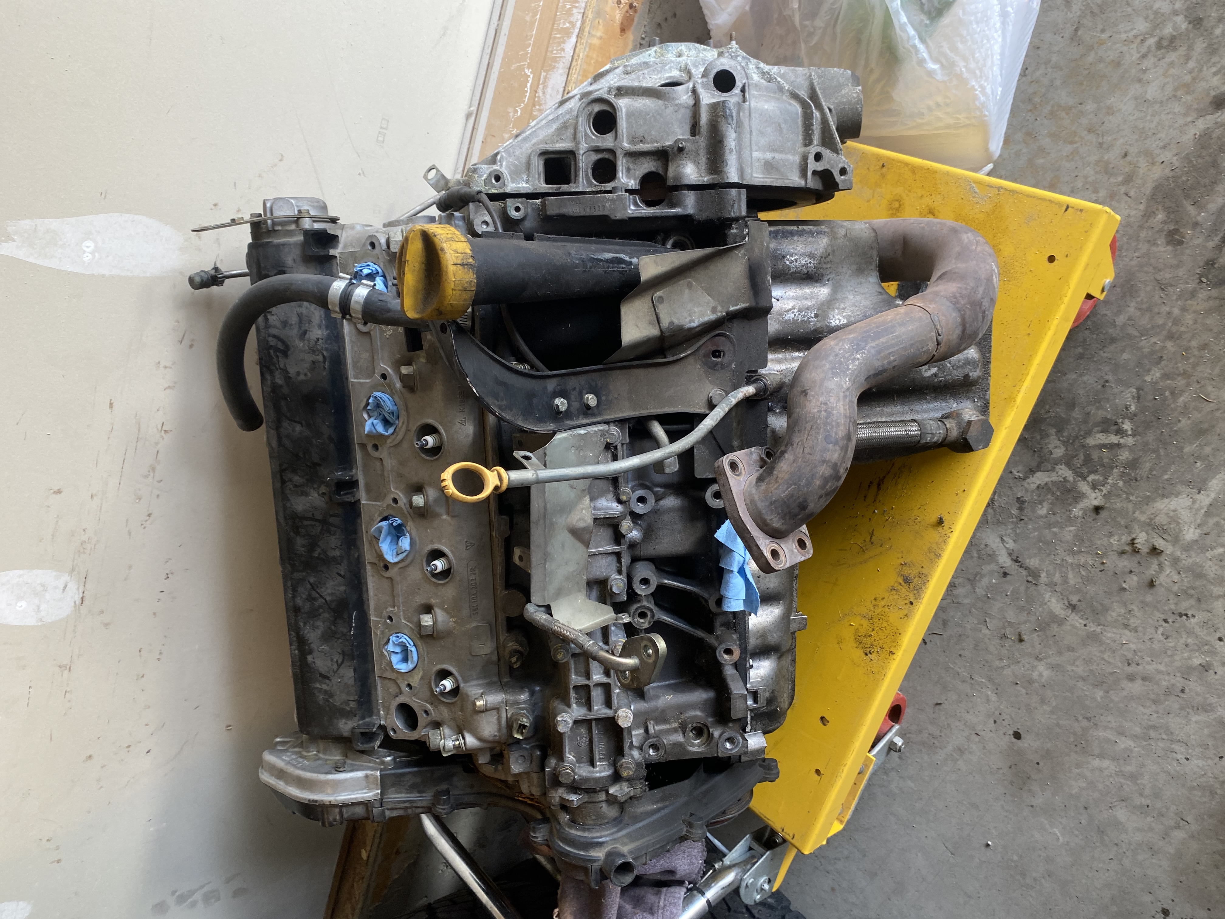

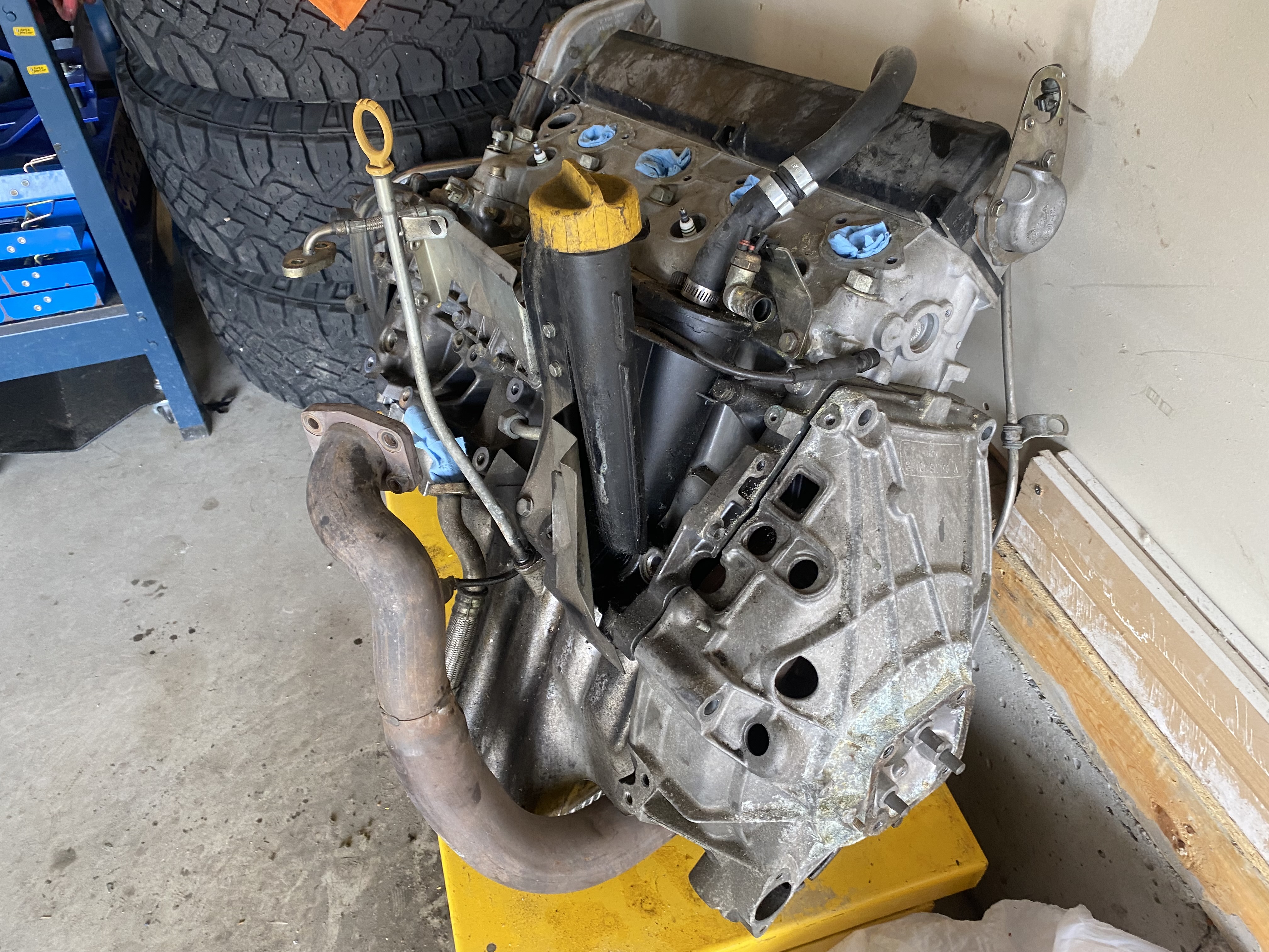

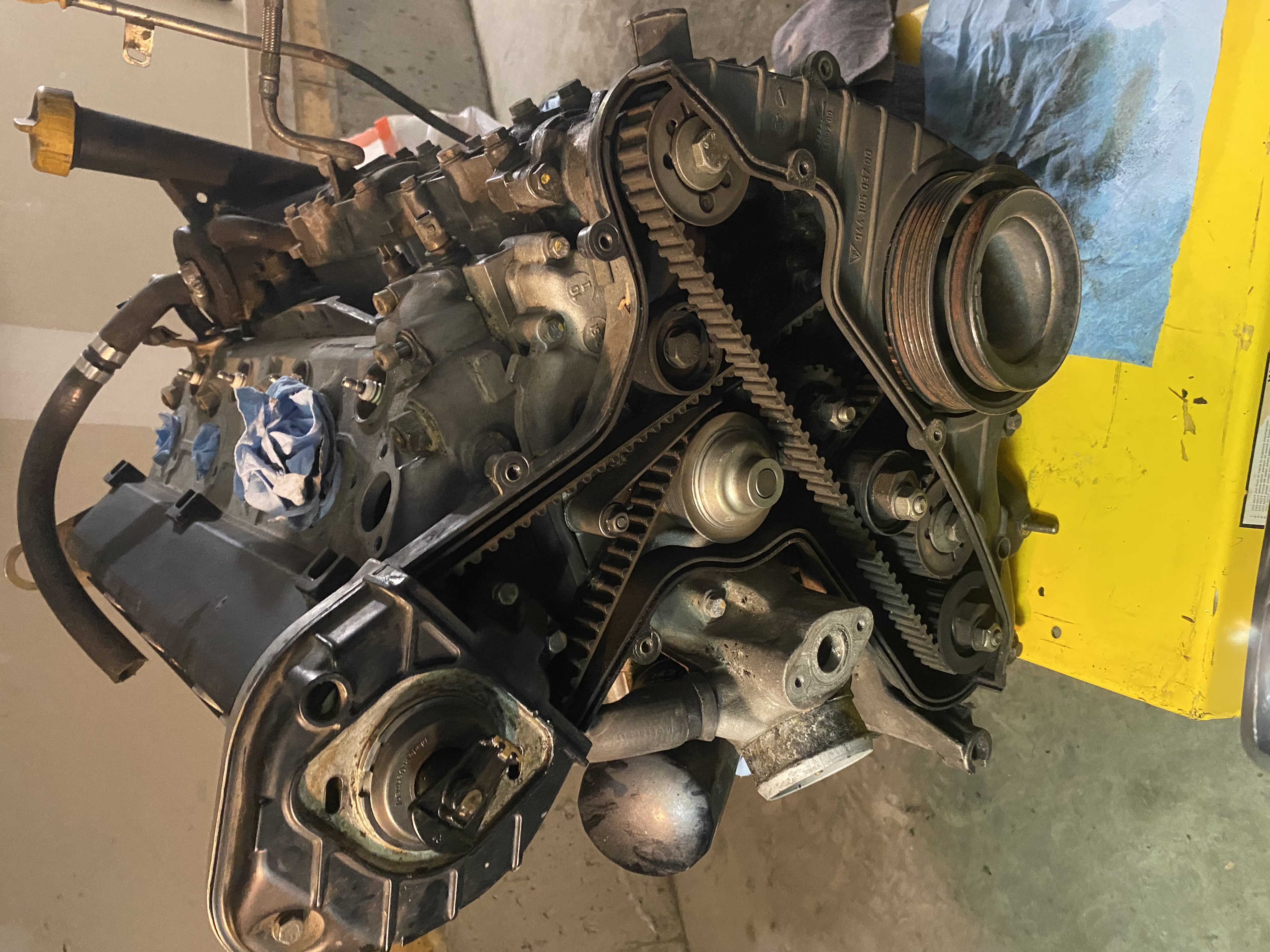

More project progress.
This is a friends engine that needs fixing.
I have to clean the hell out of it as it’s the dirtiest engine I have come across.
Not opening it up until it’s cleaned.

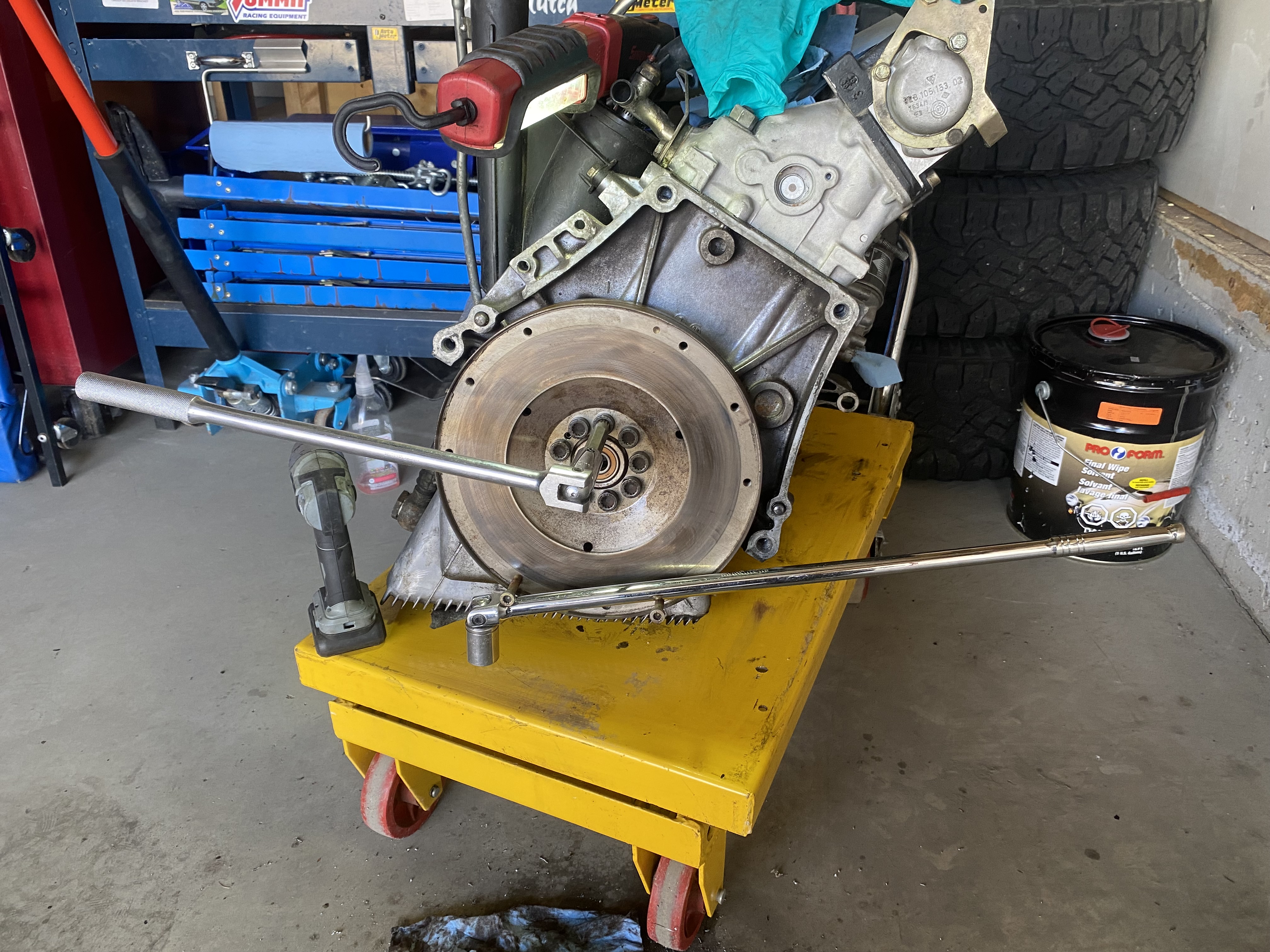

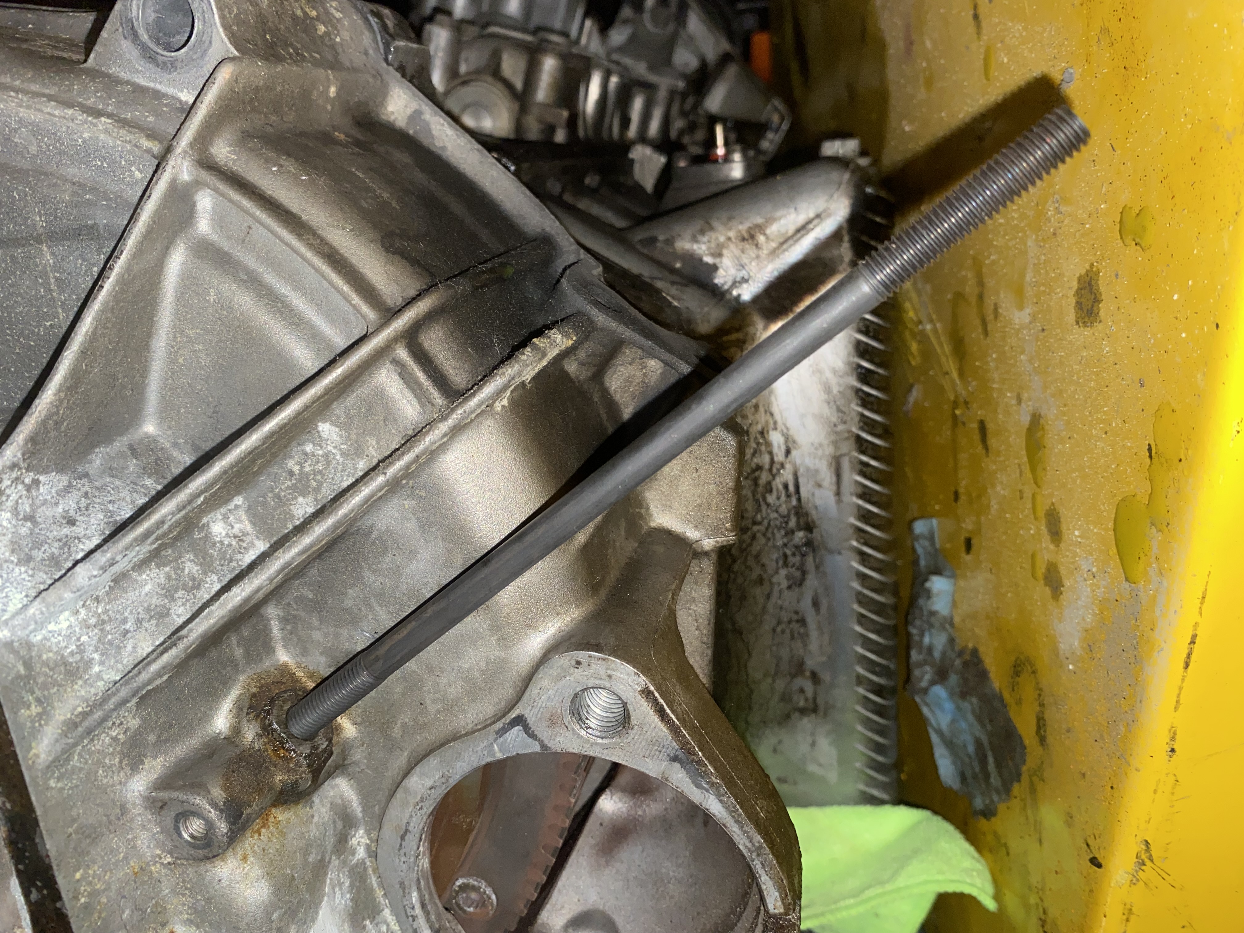

Been thanked: 81 times

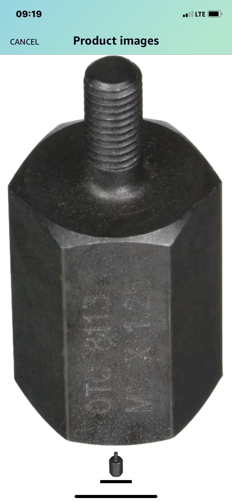

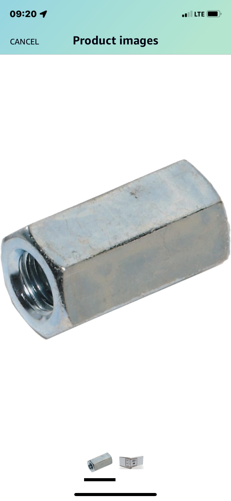

Had to buy a carbon steel ready rod extension.
Waiting on coupler to joint to my slide hammer attachment to the rod.
This OTC M8 x 1.25 is too fat to be able to thread into the clutch fork shaft pin.
Heads up to anyone ordering an attachment for slide hammer.
You need one with more thread length.
This is my work around.
I couldn’t find a longer M8 attachment.

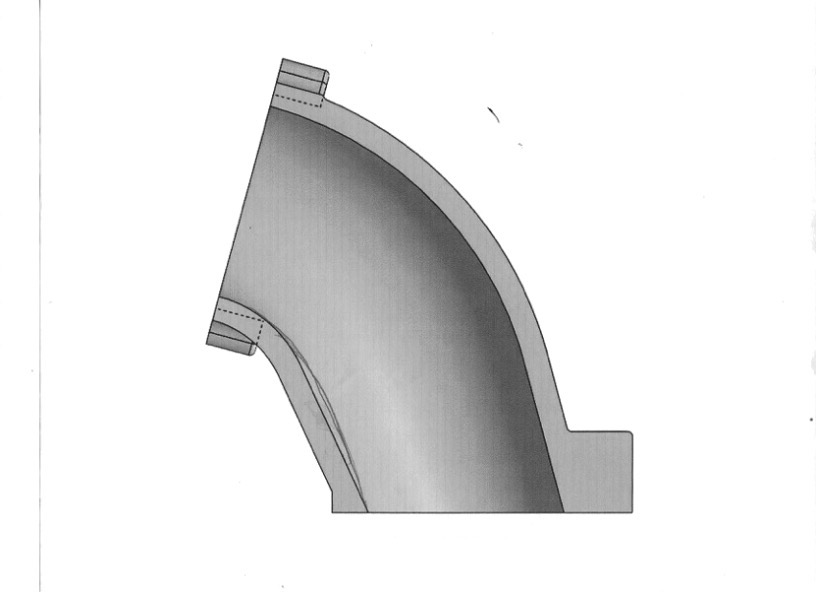

Jason,
Just a reminder to change the short side on the intake manifold to a more gentle radius. Here's a drawing that shows the altered radius drawn in with a pen:
4V Intake.jpg (39.35 KiB) Viewed 889 times

For sure👍
I spoke with Joe and change is already made to scan.
They are getting another new machine and he wants to try make it with that.
There will be a bit of a delay however.
Very sadly Joe’s son just before his 5th birthday was diagnosed with Leukemia.
The focus for him the next few months will of course be on his son as he isn’t at the shop.
michaelmount123 wrote: Thu Apr 13, 2023 11:36 am Jason,

Simple solution.
