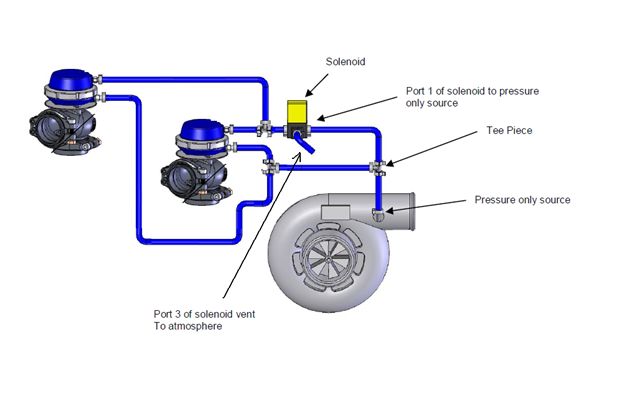

Re controlling the wastegates, I suppose you have seen this diagram already?
dual wastegate compressed vacuum.jpg (24.83 KiB) Viewed 2586 times
How early in the rev range do you reach the wastegate spring pressure?

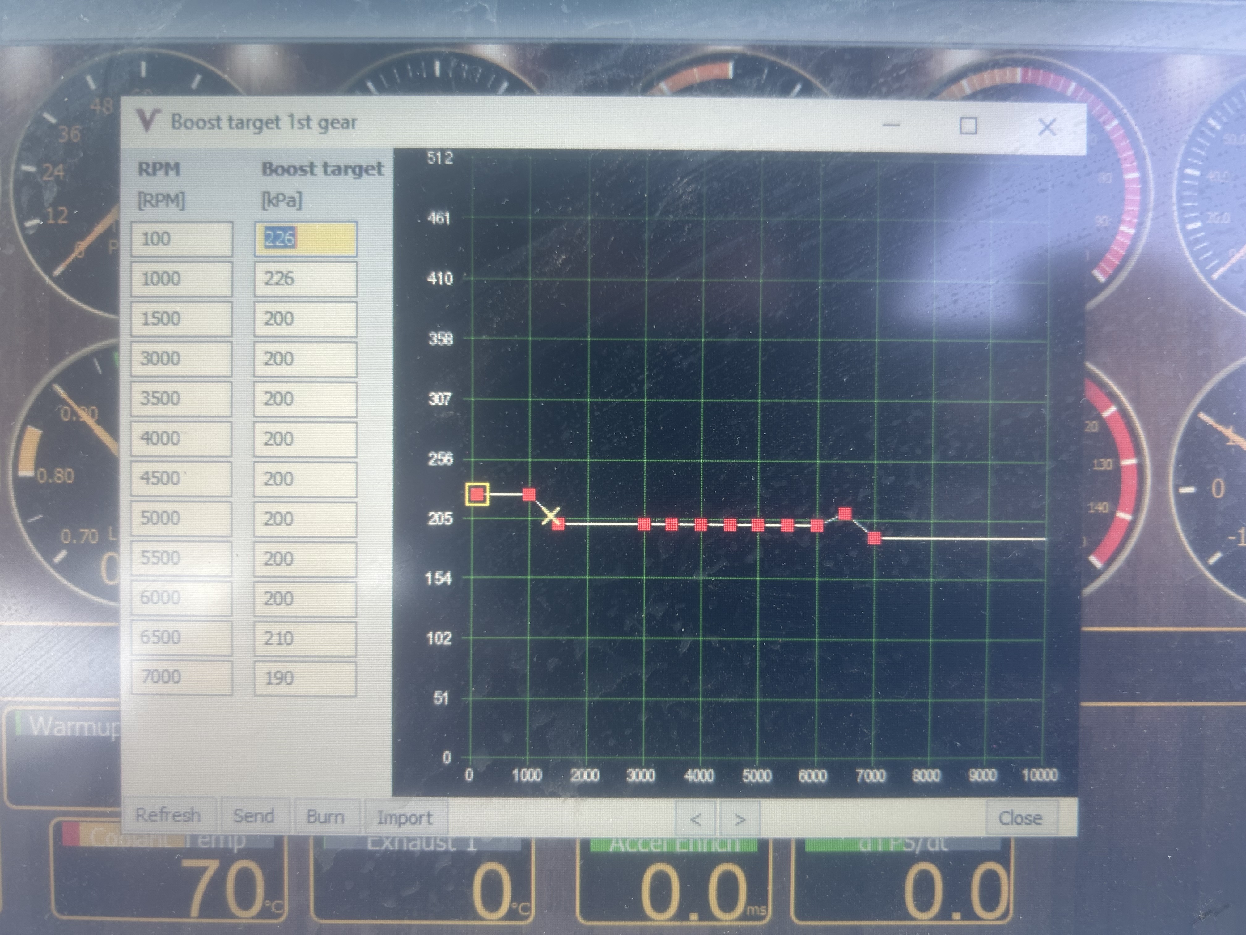

I did a run with it a couple of weeks ago with a mechanical gauge plumbed in to monitor the boost pressure (I’m working alone most of the time and I’m not that familiar with VEMs to log the boost readings yet)
So makes 0.7bar (wastegate pressure) fairly early on, then stays at that untill about 4,000rpm then shoots upto 1bar boost and holds that untill max rpm.
Boost graph request (which I’ll take a picture off) is pretty flat - calls for 1bar boost from early on.
My suspicion is that the N75 valve is not “active” below 4,000rpm because the previous car the Ecu was on had a bigger turbo and standard internals so would be more “sympathetic” torque wise.
If any of your are a whizz with VEMs and have team viewer and are happy to spend half an hour having a look at the boost control PID’s I’m fairly confident the issue can be solved

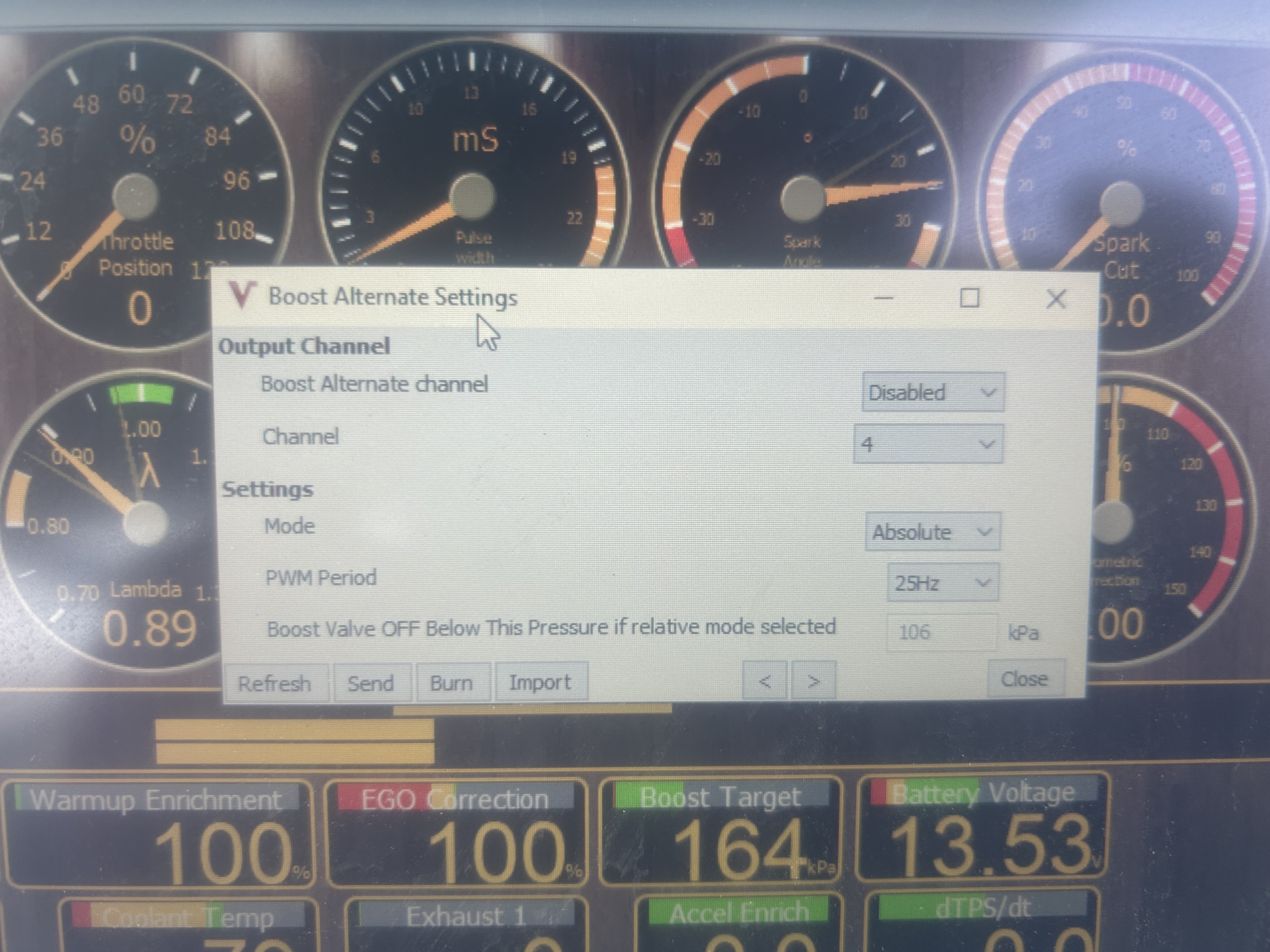

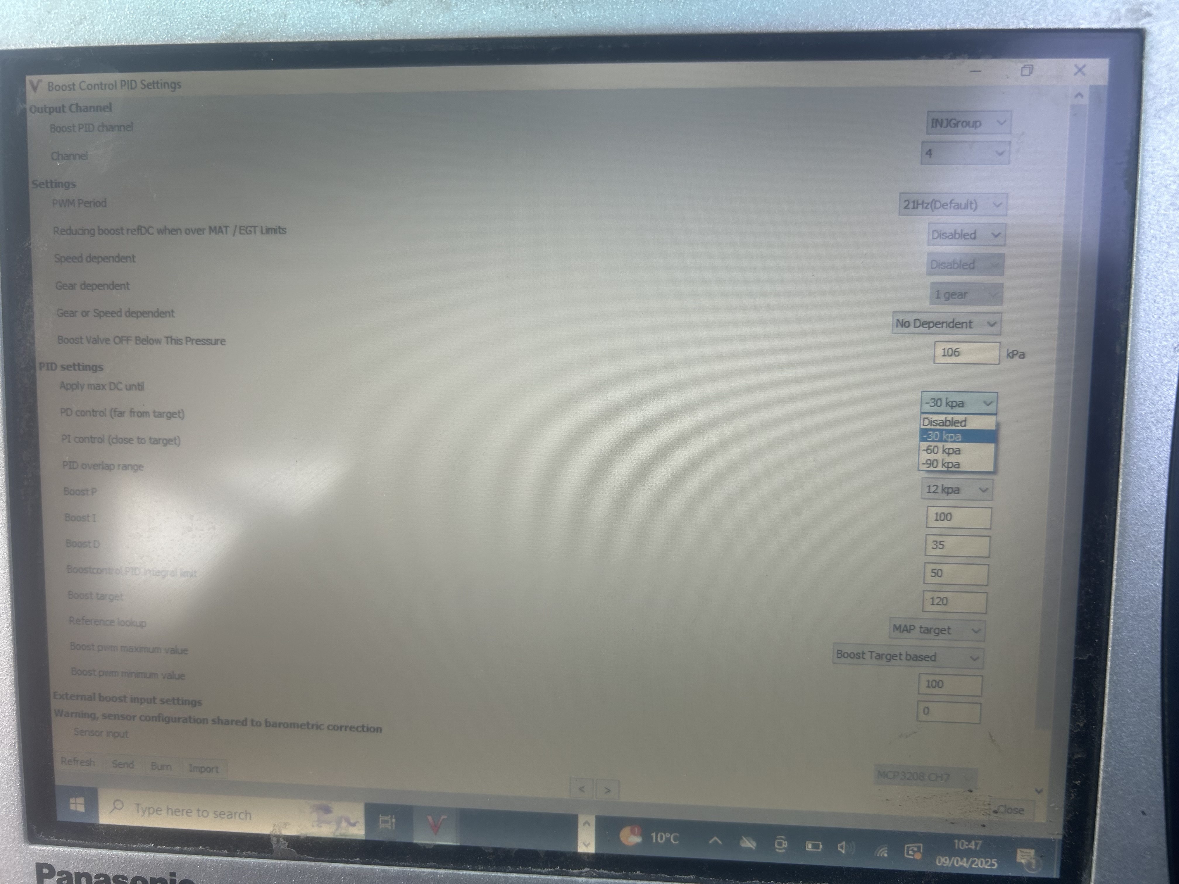

Where do you have the "Boost Valve OFF Below This Pressure" set at?

Hi Thom, I emailed David the config file, I found this in the boost PID’s which may or may not be relevant-
So the boost control valve is “off” untill boost pressure reaches 1 bar ?
