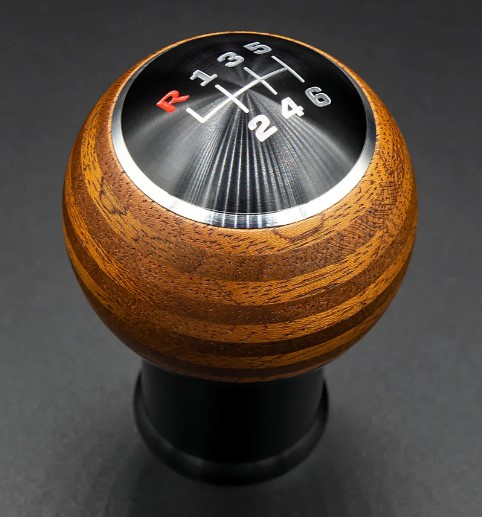

I'm either going to to love this or not love this. I like the idea of a modern but vintage look. The black rod will blend nicely into the black boot and the white lettering on the black "coin" will match the console buttons. Red was chosen for reverse to match my hyper-speed dial. I went with the polished edge around the coin to tie-in to the silver trim in the cockpit. I'm hoping the Mahogany will compliment the Burberry seat belts and the crest on the wheel.
...or this is just me trying to justify a bad decision :crazy:
GT3-M Mahogany shift knob × 1
Fitment GT3M: Porsche 991/981/992/982/718
2. Color & finish Top Coin: Black - Brushed - with polished edge
3. Color & Finish Rod: Black - Brushed
4. Custom engraving Rod: None
6. Shift pattern: 6 Speed
7. Color shift pattern: White (pic below is just machined)
7b. Color shift pattern R - reverse: Red
9. Weight GT3M: Medium (>350 grams) - Sport

I think it will look great! That's a sharp-looking rendition of what you're going to be receiving. Besides, if you like it, then it's perfect. :D

JUST WHAT I NEEDED TO HEAR.
Thanks :)

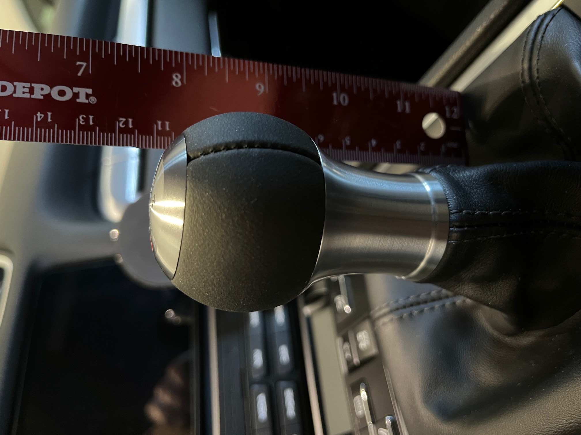

@JodehFoster As requested plus bit more.

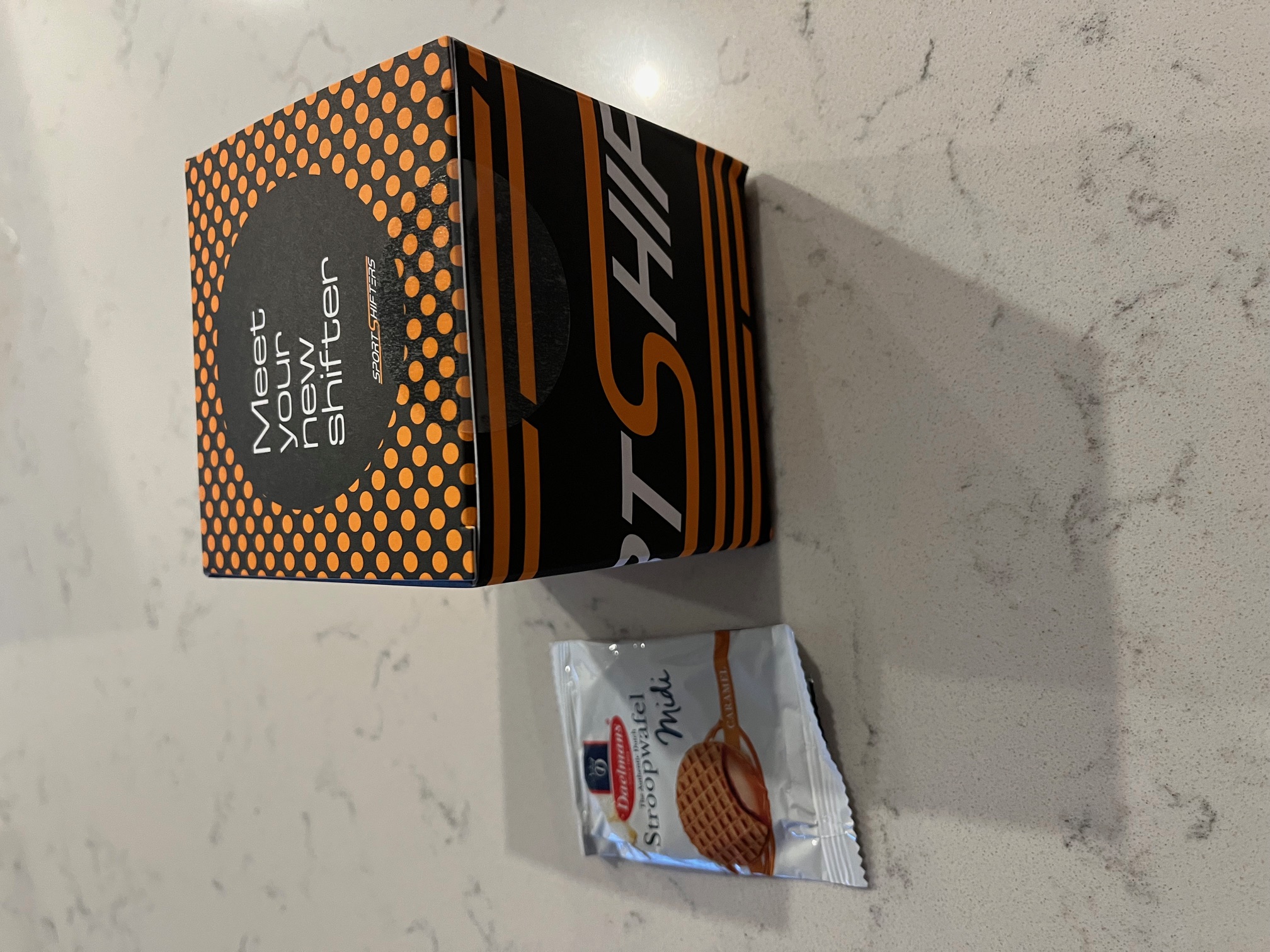

The Sportshifter came this week - from time of order to receipt it was 12 weeks. All along major milestones were communicated by emails. Shipping from the Netherlands to US (Colorado) was about 1 week. I had to pay approx $23 in duties due to the tariffs in place. UPS made it easy.
In short, the knob was easy to install. Most time spent (aside from drooling over it after it arrived, opening the box, etc. - it came with a stroopwafle!) was removing the OEM shift knob from the boot - not wanting to break the plastic tabs during the process. After that, the install was very simple. There are some videos about the removal on a 718 like this one https://youtu.be/Q7ou8llkJ38?si=qtRSLNtVxwE6tHJX but they do not go over the the bit of releasing the 4 knob tabs. I needed to do some more twisting and careful pulling once the knob was off of the rod.

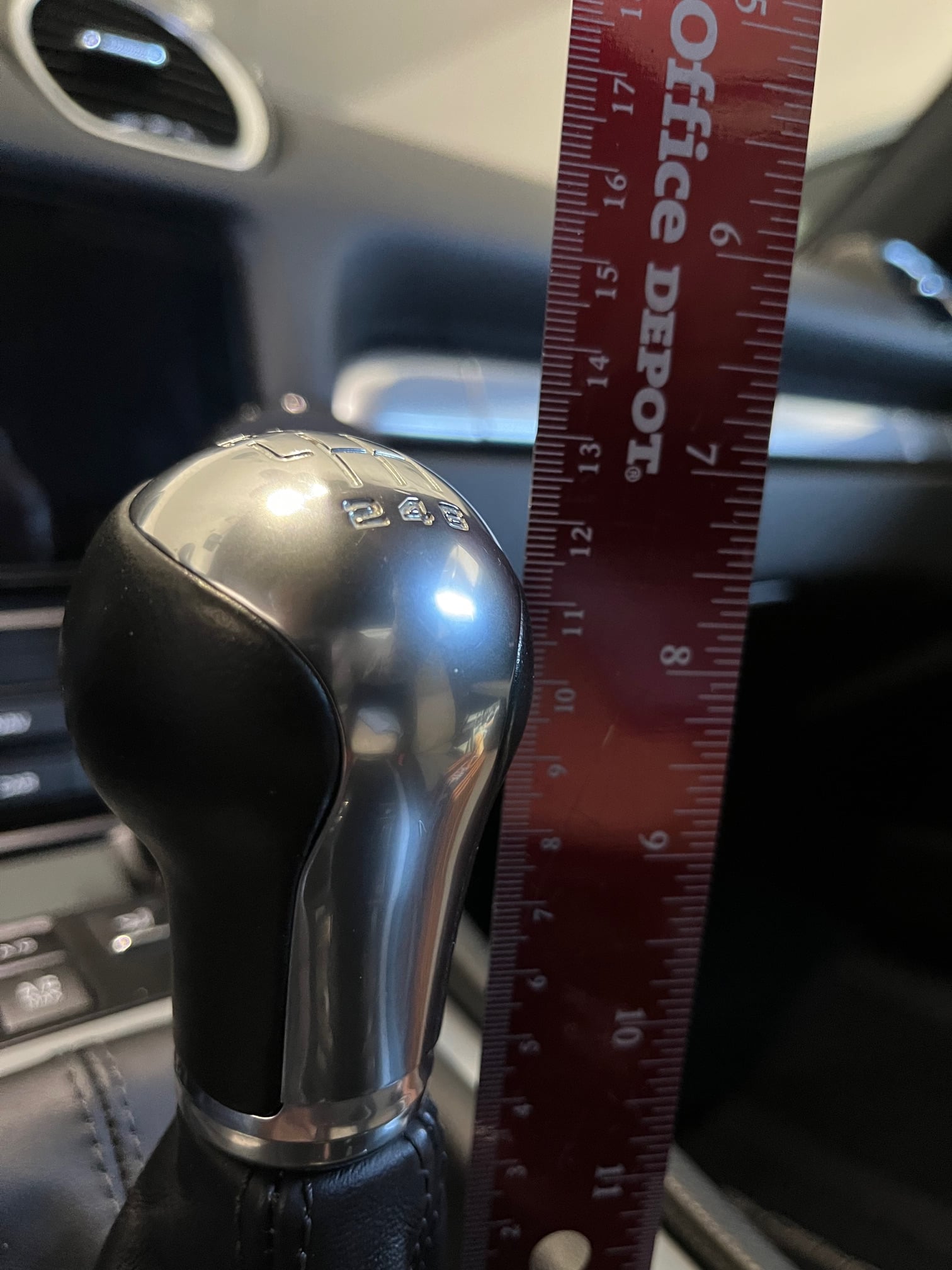

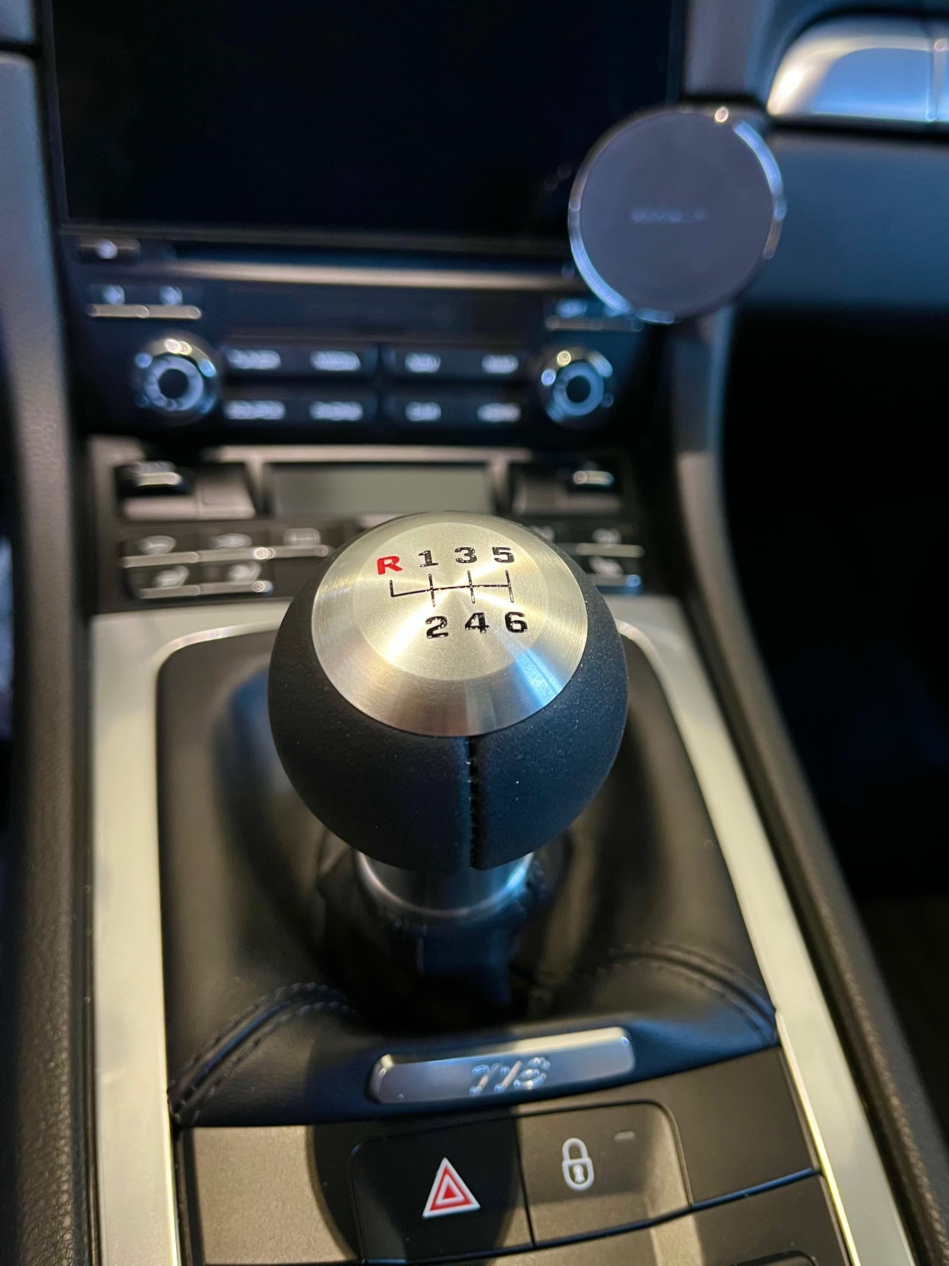

I got the GT1 - for me a noticeable diff in diameter, although the diam is only smaller by 1 mm by my approximation. Nothing bad just different.
I mounted the adjustment ring so the 3 set screws sit in the notch that is in the shifter rod. My thought was that it will not slip and I could push firmly down on the new knob while tightening without any slippage so the boot would stay put when sandwiched in-between the knob and the adjustment ring. With this position the height different was approx. 20 mm (a little less than 1").
From a driving experience, the shifting felt more crisp, most likely due to the shorter height and the slightly heavier weight than stock. I felt more connected to the shifting - this is most likely a placebo effect on my part. More driving today.

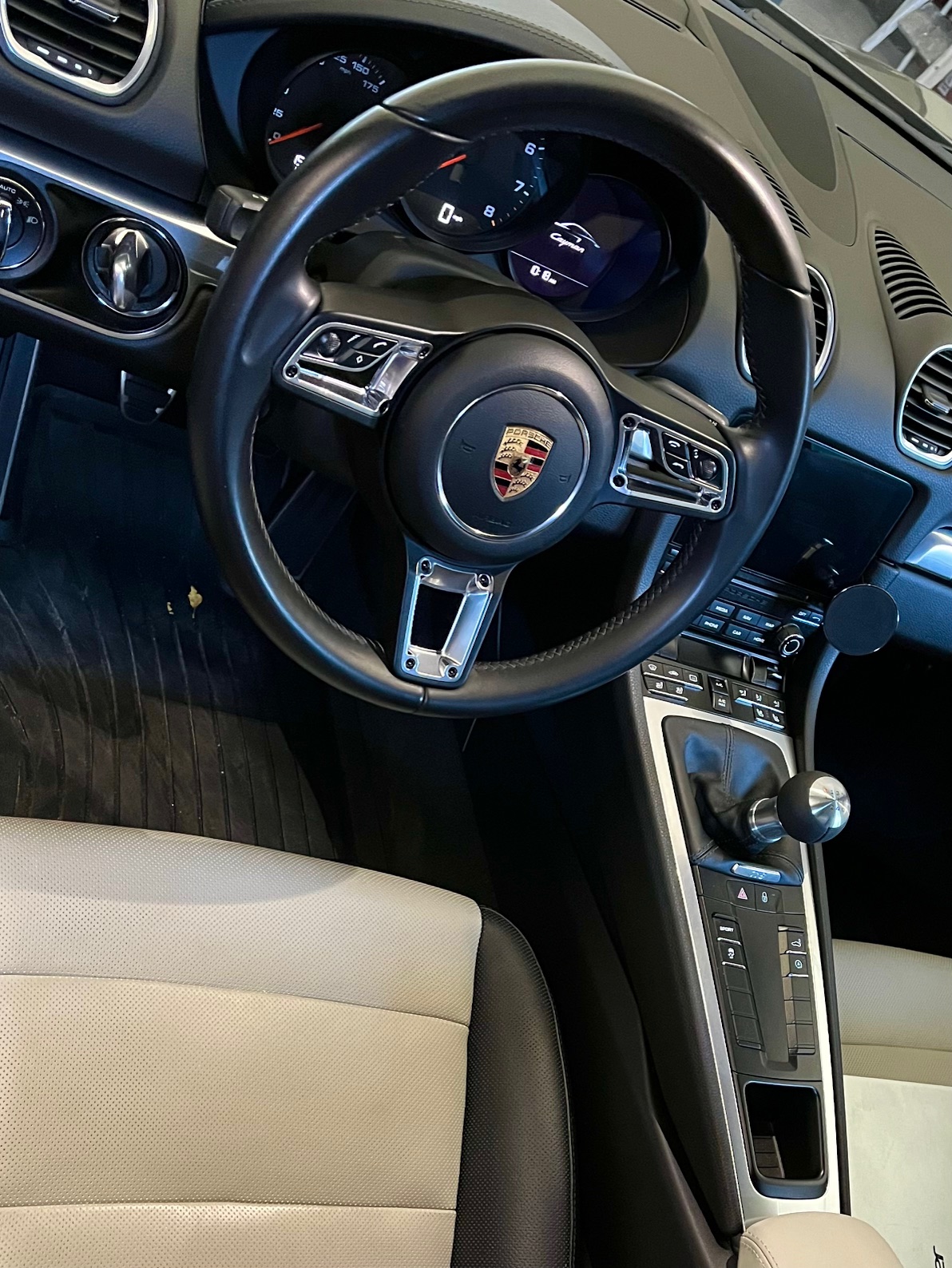

Overall, it looks great, matching the interior well - much more refined and P-car-like than the stock. My wife just rolls her eyes and pats me on the back like I am a 5 yr old getting a new toy....wait...... perhaps I still am........ha ha.

Marvelous! It looks so very good and the quality shows! Thanks for the update and install info!
