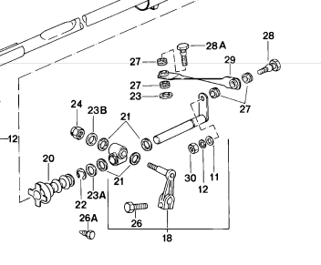

Yeah, the best I could find was $215.
What I want is sandwiched between both #21s. All you can buy is the #18 assembly.

Renn937 wrote: Thu May 01, 2025 11:53 am Yeah, the best I could find was $215.
Yes you can get that piece.
I bought a new nylon shift block like the one in the video above and it completely eliminated all freeplay in the shift linkage. In fact, the new shift block fits a little tight, I had to push and twist to install it on the pivot shafts. It loosened up after a few miles of stop-and-go driving.
FYI I got it from from PartWorks. de Just search for artikelnummer 1266. The kit also includes a little packet of grease, new hardware and extra shims to eliminate any freeplay.
https://partworks.de/partworks/7261/lag ... -umlenkung
