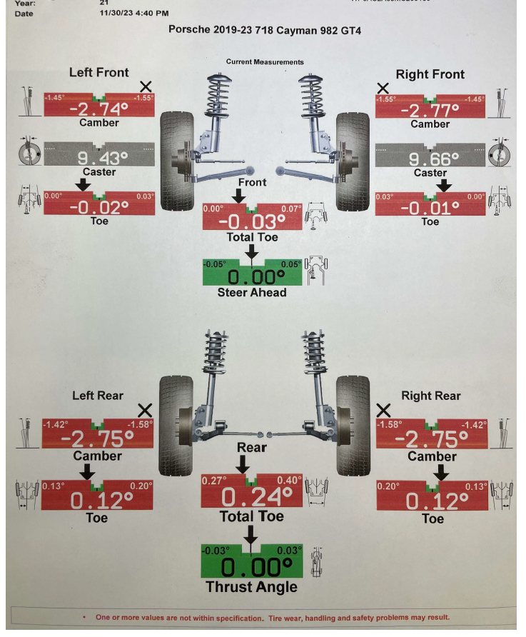

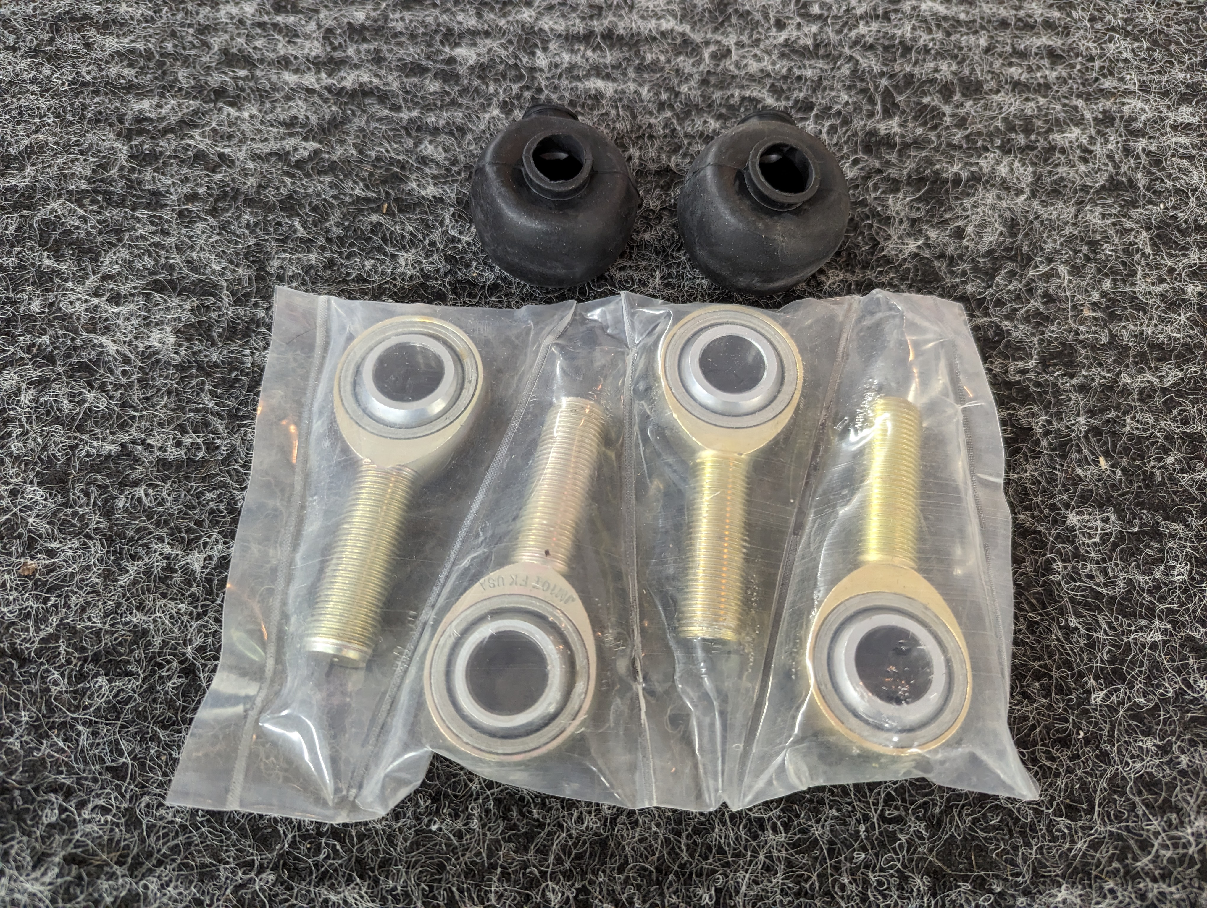

Replaced the Tarett rod ends for the rear toe links. All four are now new - inner and outer, both sides. (There was a very slight bit of play in the inner passenger side rod end. That was after about 1,850 track miles on the original Tarett setup.)
I think the new Tarett ends are somehow better than the originals - something about being tighter. In any event, they are inexpensive and it's best to replace all four as a set.
The rod end replacements required a fresh alignment. Nick was able to eke out a bit more negative camber all around to -2.75 square. (He does one heck of a job. Perfectionist.) That's all the negative camber there is out of the current setup but I think it's about perfect for my needs.

Bill, with stock components, the max negative camber I could get in the rear was -1.71 (left) & -1.73 (right). For the front, the max with stock parts was -1.78 on both sides.

Also, this older emailed info from Nick (lead Gold tech/shop foreman at PoN) June 2021:J-Dub wrote: Sun Dec 03, 2023 9:19 am Bill,
On my GTS I am at 2 deg rear camber, 2.5mm per side toe in and the eccentrics still have more room to go. I am not sure why this differs between the GTS and the GT4.
“I’ve got your car up on the alignment rack and the most camber I can get out of the front is -1.8 on each side. I was going to look into using control arm shims like on a GT3 (they are GT3 lower control arms) to achieve -2.00 or -2.50. However, I found this detail in the [Porsche] workshop manual:”
Front-axle camber setting: The camber adjustment on the front axle on the Cayman GT4/Spyder is performed only via the supporting mount. The intermediate plates -Arrow- on the 2-part wishbone must not be changed, as this can result in an impermissible wheel overlap at the wheel housing.
(This is a straight quote from Porsche tech svc manual.)
