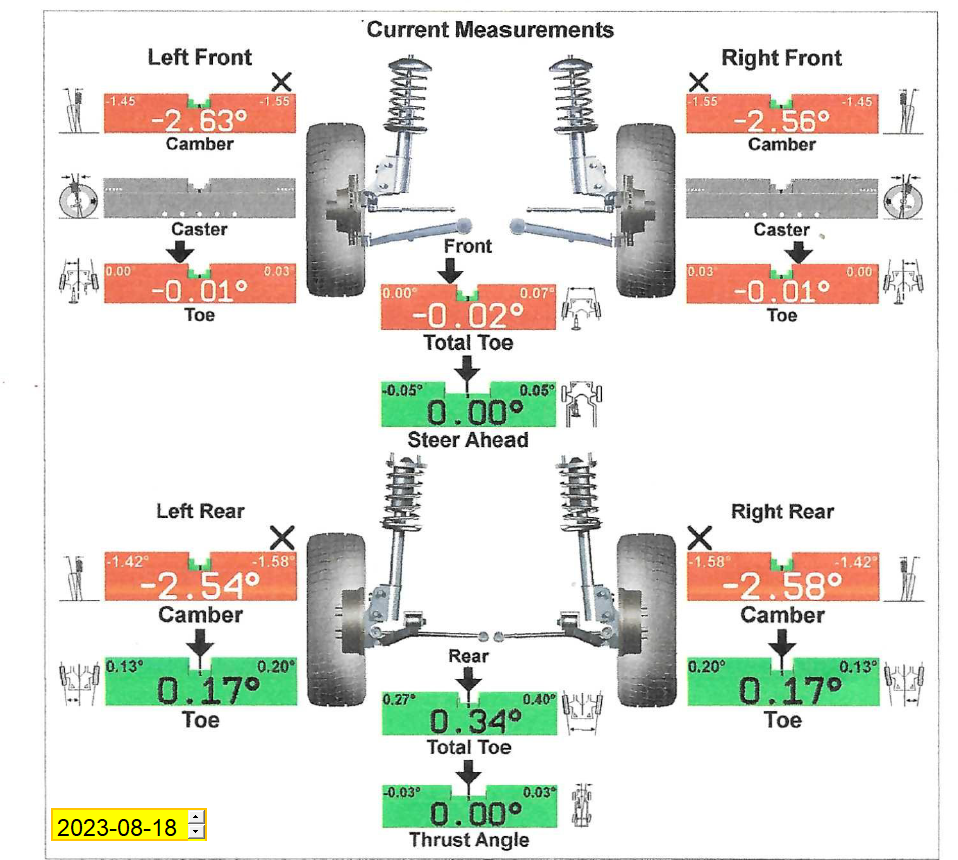

I'm running a bit over -2.5 square with the Tarett camber plates and their turnbuckle style rear toe links.
Latest alignment with the new 19" Apex wheels. Neg camber up a bit from last time. Camber and Toe recommendations came from Andy P.
