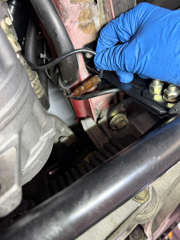

In an effort to add a morsal of value, here's a picture of the compressor spade. Very weird design in that the spade is wedged on there very tight, yet there's no good way to grab it and yank it out -- so good luck with that. Bob's test all carry over to the 944 perfectly up to the control circuit part -- we have the infamous climate control unit. I'd start by pulling the spade connector off (good luck) and running a single jumper cable from the positive terminal of the battery to the spade connected to the compressor (NOT THE HARNESS SIDE). The clutch should engage hard. If not, whatever DUFO means, the compressor is that. (Due for overhaul? Definitely Un-Fixable Object? Dead Until Funding Occurs? Doesn't Understand Fan Orders?)
- ac-connector.jpg (98.64 KiB) Viewed 17 times
much thanks guys! that is what I'll do next. thx for the pic @Tom and I think I saw that if the clutch coil is not within ohms and not sucking the pulley in, a person can change just that coil without pulling the compressor out of the system.
