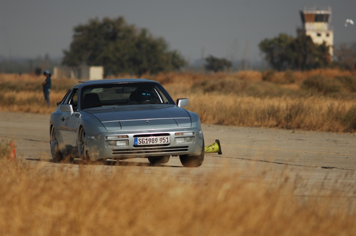

Mine are 8.5jx18 e42 with 40-235 up front. I'm not sure if that helps.
autocross 11-10.JPG (110.69 KiB) Viewed 2930 times
