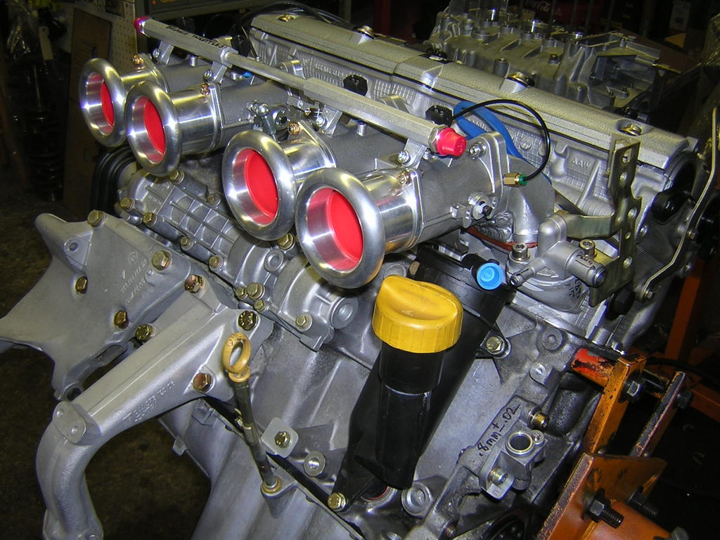

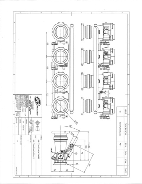

I'm quite sure a 944 intake manifold could be made in 4 pieces with only minor changes to the cylinder head flange bolt pattern. Here is one I had machined for a 4V using the ATPower throttle bodies. It resulted in a GORGEOUS piece of kit, but was pretty pricey. Unfortunately the engineering company wouldn't give up the CAD files.
- Intake Man Newest.jpeg (37.54 KiB) Viewed 14433 times
- ATPowerTB's.jpeg (63.1 KiB) Viewed 14433 times
