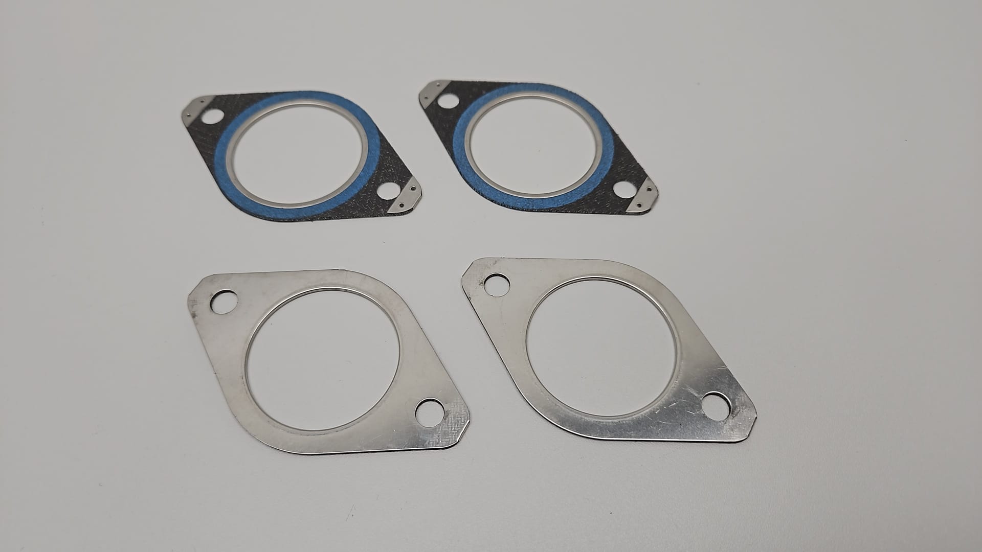

I used these reinz gaskets (OEM normally I believe, 944 111 196 01)
WhatsApp Image 2023-10-24 at 15.09.23.jpeg (76.64 KiB) Viewed 844 times
I'm now unsure whether I did 15 nm or 20 nm of torque... I'll recheck asap and then test again. I'll also try to get a picture or video of the bubbling.

Belgian951 wrote: Fri Jan 26, 2024 3:26 pm I used these reinz gaskets (OEM normally I believe, 944 111 196 01)
Try the re-torque for sure. Very curious about the bubbling....? Can't quite picture what's going on there. The shiny side goes toward the headers.
