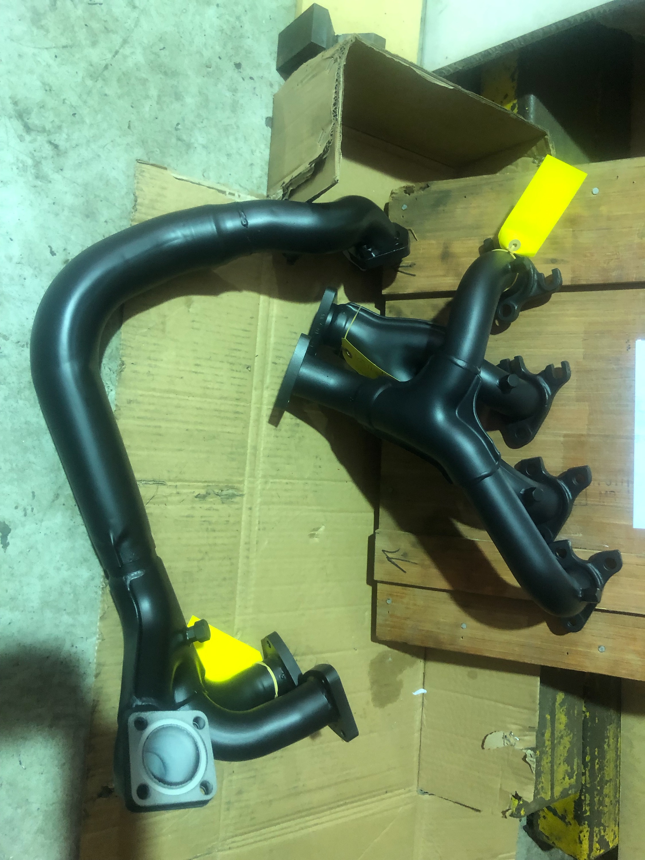

Final pieces of the puzzle are coming into place, headers and cross over are back from coating, not the custom setup I originally planned but thats something Ill look at in the future. Fabricator is lined up next week for intercooler piping and exhaust/wastegate mods.

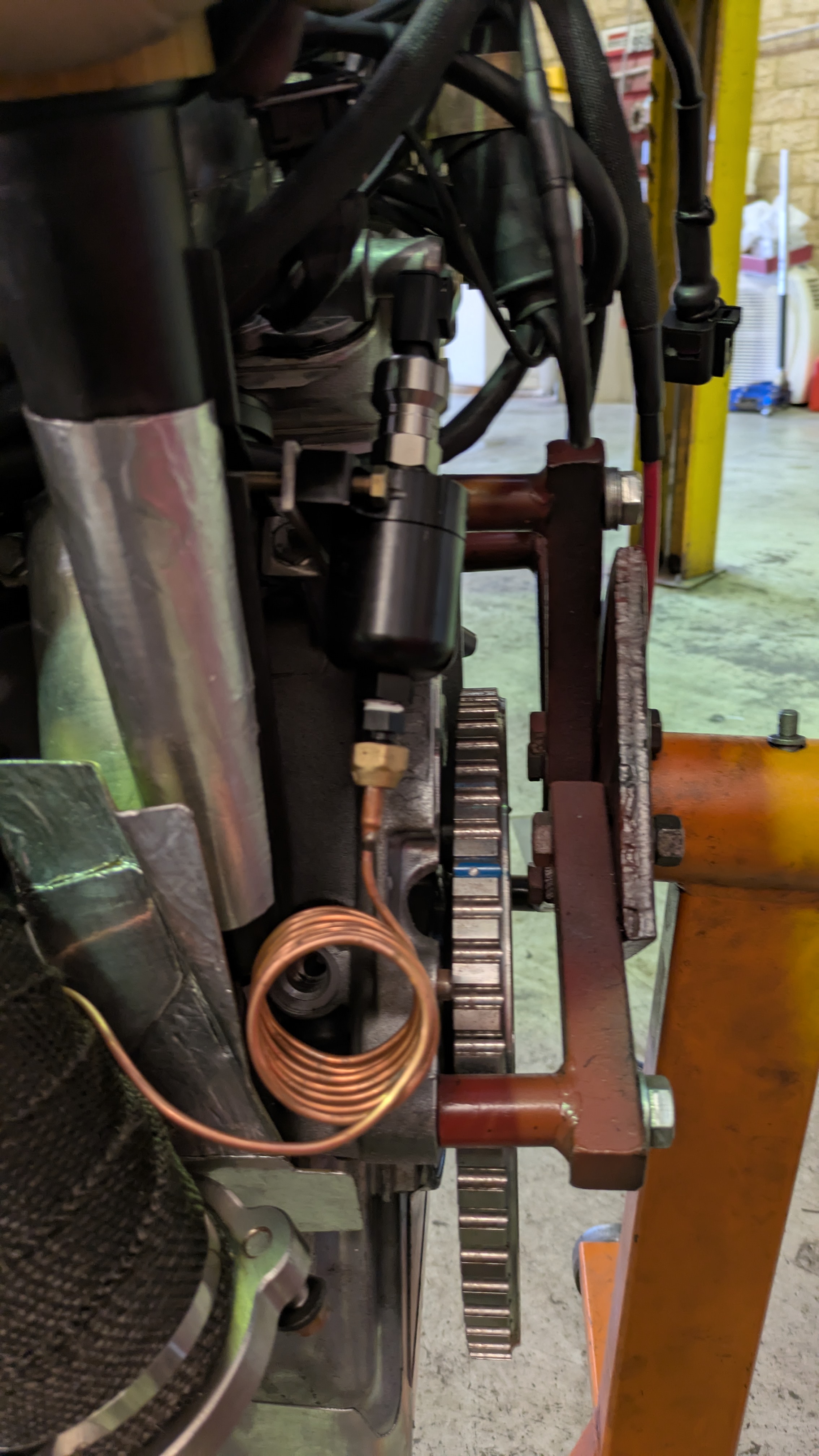

EMAP sensor installed as well which is tapped from the stock o2 sensor port

This car keeps throwing up curve balls but I guess that's the challenge of a build without heaps of off the shelf parts.
Apparently the Tial F46 wastegate doesnt play nice with the early one piece crossover pipe. I should have tried a bit harder to get a later 2 piece pipe but my fabricator snookered me by changing the crossover flanges to the 16V pattern rather than the headers to the turbo pattern. Im going to have to add the extra flange in to make it work for now.

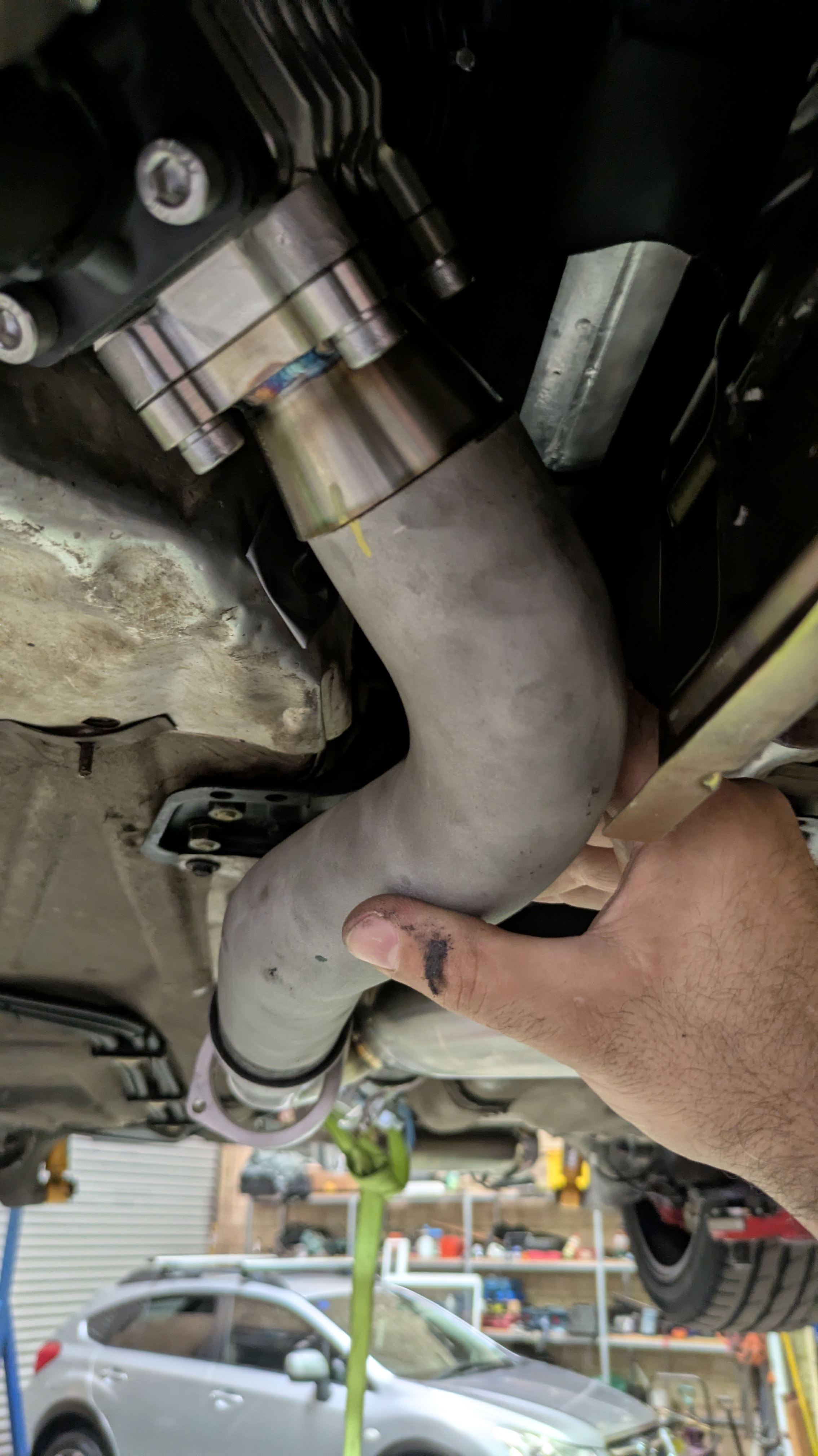

Ok back in the game, going in for intercooler piping next

This is turning out better than expected. I cut off the stock flange from the wastegate outlet pipe and it lined straight up with the new flange wed mocked up.

EGT sensors in, these will probably come out once the tune is sorted
