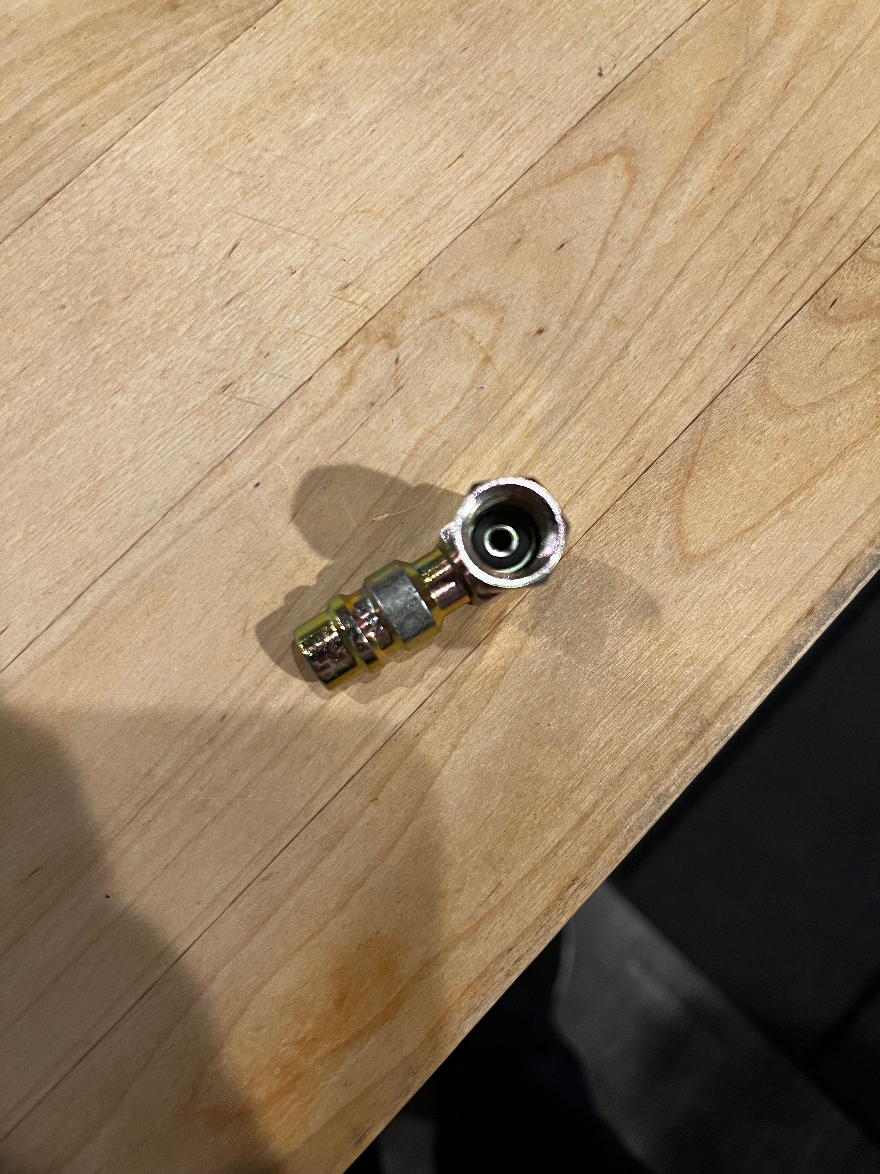

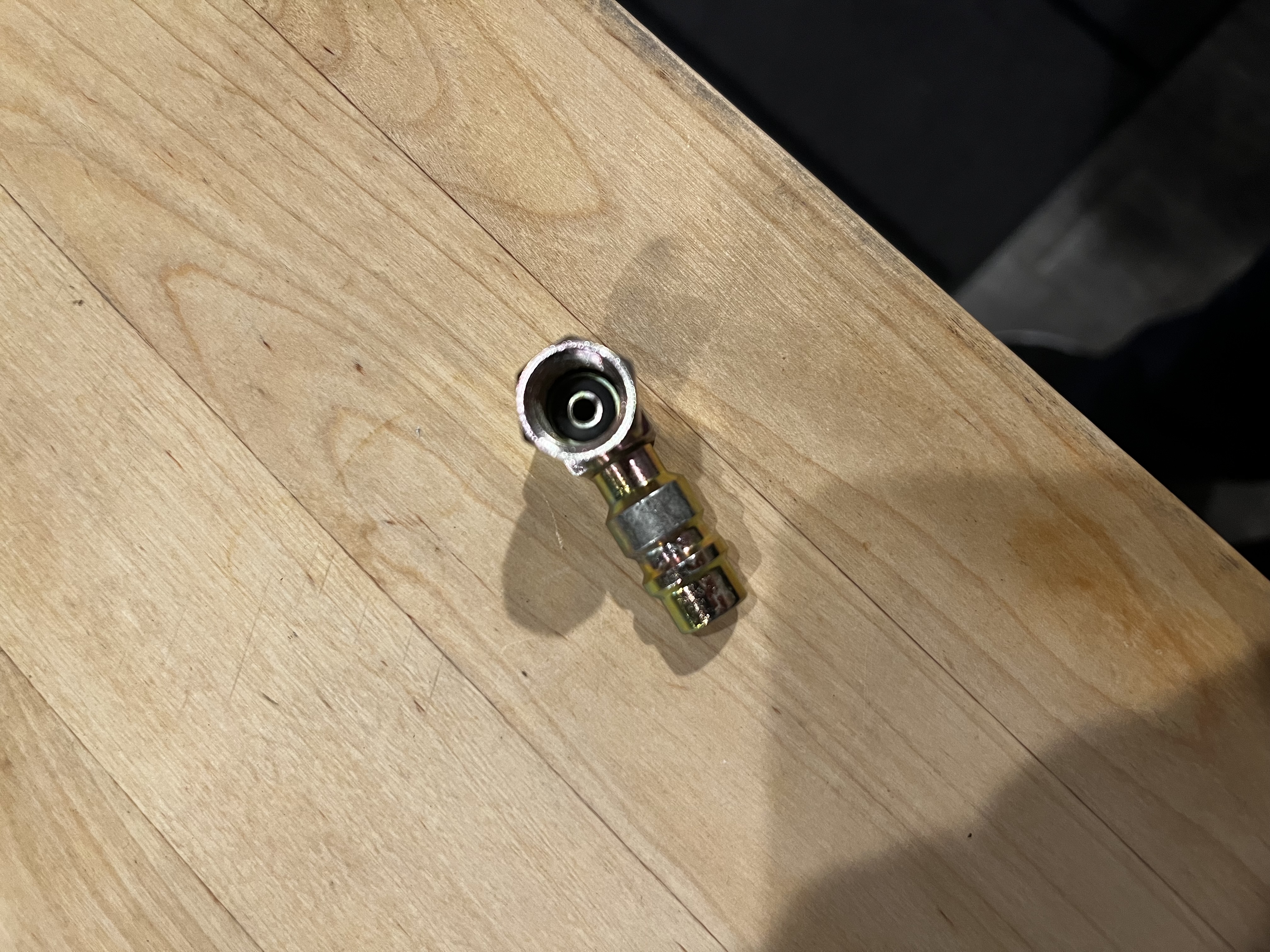

Just received my 90 degree fitting in the mail today and I noticed that the o ring on the inside is black. Does that mean it’s not neoprene/r134 compatible?

It's a virtual certainty that the o-ring inside an r134a adapter is compatible with r134a. Neoprene o-rings do come in black, especially when part of an assembly like this. They just make consumer o-rings in green so that they can be identified as r134a compatible, but color-coding isn't really necessary in a manufacturing environment. I think you're good to go.
