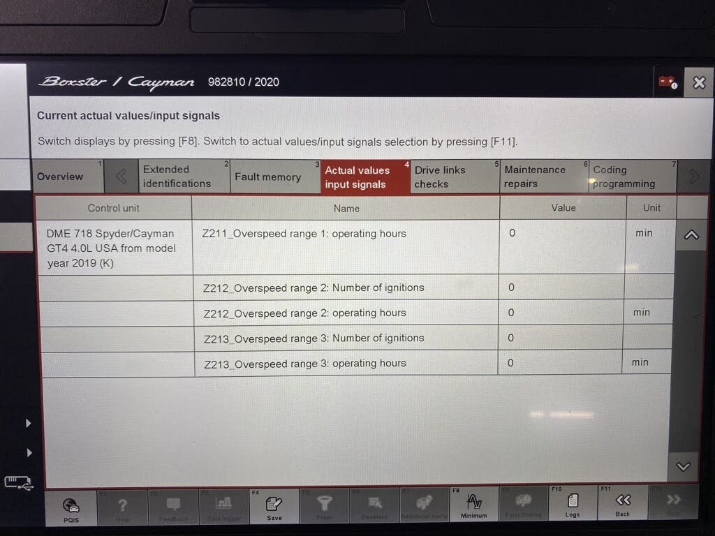

The X431 capable of extracting the engine over speed data similar to the PIWIS tool?

@MXK944 - As far as I have been able to determine, X431 is not able to read the current overrev data.

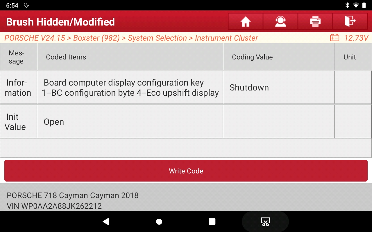

Here's a new one that was reported elsewhere. How to turn off the silly upshift indicator. This is confirmed to work with MT6, tomorrow I will verify that it also works in manual mode with PDK.
New Edit - This change does work on PDK in manual as well, but it is specific to the key fob. See next post.
SYSTEM SELECTION> INSTRUMENT CLUSTER> Board computer configuration key 1--BC configuration byte 4--Eco upshift display = Shutdown
{Default: Open}

So to disable the upshift arrow (for either PDK or MT6), the change to make needs to be for the key in use. The control unit has items for up to 4 keys. If you only have 2 keys for the car, they will be keys #1 & #2. There does not appear to be an easy way to determine which key is which. I've found that the key I generally use must be key #2, as making the code change to key #1 did not work, but when I made the change for key #2 it did. So plan on doing it twice:
{Default: Open}
And:
SYSTEM SELECTION> INSTRUMENT CLUSTER> Board computer configuration key 2--BC configuration byte 4--Eco upshift display = Shutdown
{Default: Open}
I'm going to go back into this area tomorrow, to see if I can figure out what the several other items that are repeated for keys 1-4 do. There may be some other worthwhile things hidden in there.
