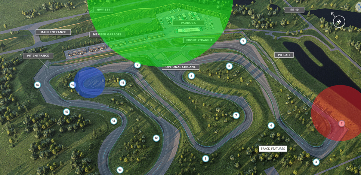

The system is distanced based (not time) and we can program in any distance we want. The way it works is that we program in a fixed point on earth and then set the flaps to close when it comes within X number of feet of that point -- so in effect each GPS quiet zone is actually a circle. I pulled up that track and marked it with 3 random GPS zones to give you the idea. (I have no idea where you actually need it quiet, just showing how you can vary the center point and radius to cover portions of the track without bleeding into unwanted sections....). As larry says, I have heard that people have damaged catalytic converters (by overheating them) when they used to wire their flaps shut for an entire race. I've never seen it happen, nor know anyone it's happened to, so I put it into the category or believable folklore. There's no hard and fast rule on how far away from the sound meter to keep the flaps closed. People tend to learn by word-of-mouth where they need to let off the gas on sound-metered tracks. It depends on the terrain, braking and exit points, how close you are to the limits, etc. I think the smallest section of track I've covered was about 400 feet, and the longest over 1000, if that gives you some sense....kfarmgz wrote: Tue Oct 04, 2022 12:42 pm Thanks Tom for the welcome,
Track is in the great white north. Rocky Mountain Motorsports 45 min north of Calgary, Alberta.

I blew over in my Bone Stock 991.1 GT3RS, i switched over to the soul resonated tips with angles down and it is still blowing 98db, Track Limit is 95db. There are 3 locations for the sound check, I have only found 2 myself so far, however since its a membership track and some of my friends are members, would not be hard to find the last one.
Can I ask, each time the GPS Valves closes, how far outside of the GPS zone would it need to be before it opens again? Or if they are time based, how long do they stay shut after the GPS signal triggers it to close?
You bring up a good point on the flaps staying shut for so much of the track, I wonder if there is any risk damaging Engine or Muffler?

So the front straight is where the first one is. the 2nd one is right at 4 on the right side
I've just heard the 3rd one might be mobile..... rendering this a moot point. Need to do more research before I can commit to a unit. When I am ready whats the best way to get one?

Ok, keep me posted. If the meter moves around the track as you drive, then the Track Nanny is not the answer. If they set it up in different spots from one week to the next, then in theory I 'could' plug the two fixed locations into the pre-programmed zone and re-work the user-program mode to let you program in a third location on the fly. I've never done one like that, but as a programming matter it seems doable. Sounds like that track is pretty serious about its noise limit though, so wonder if doing that would fly with them. It seems like lots of tracks put up sound meters to appease the local neighborhoods, but then don't seem to care how loud a car actually is as long as it coasts by the meter. I've seen wildly loud cars fly around Laguna Seca and then coast by the sound meter, and have never seen the track do anything to them.kfarmgz wrote: Tue Oct 04, 2022 1:54 pm So the front straight is where the first one is. the 2nd one is right at 4 on the right side
