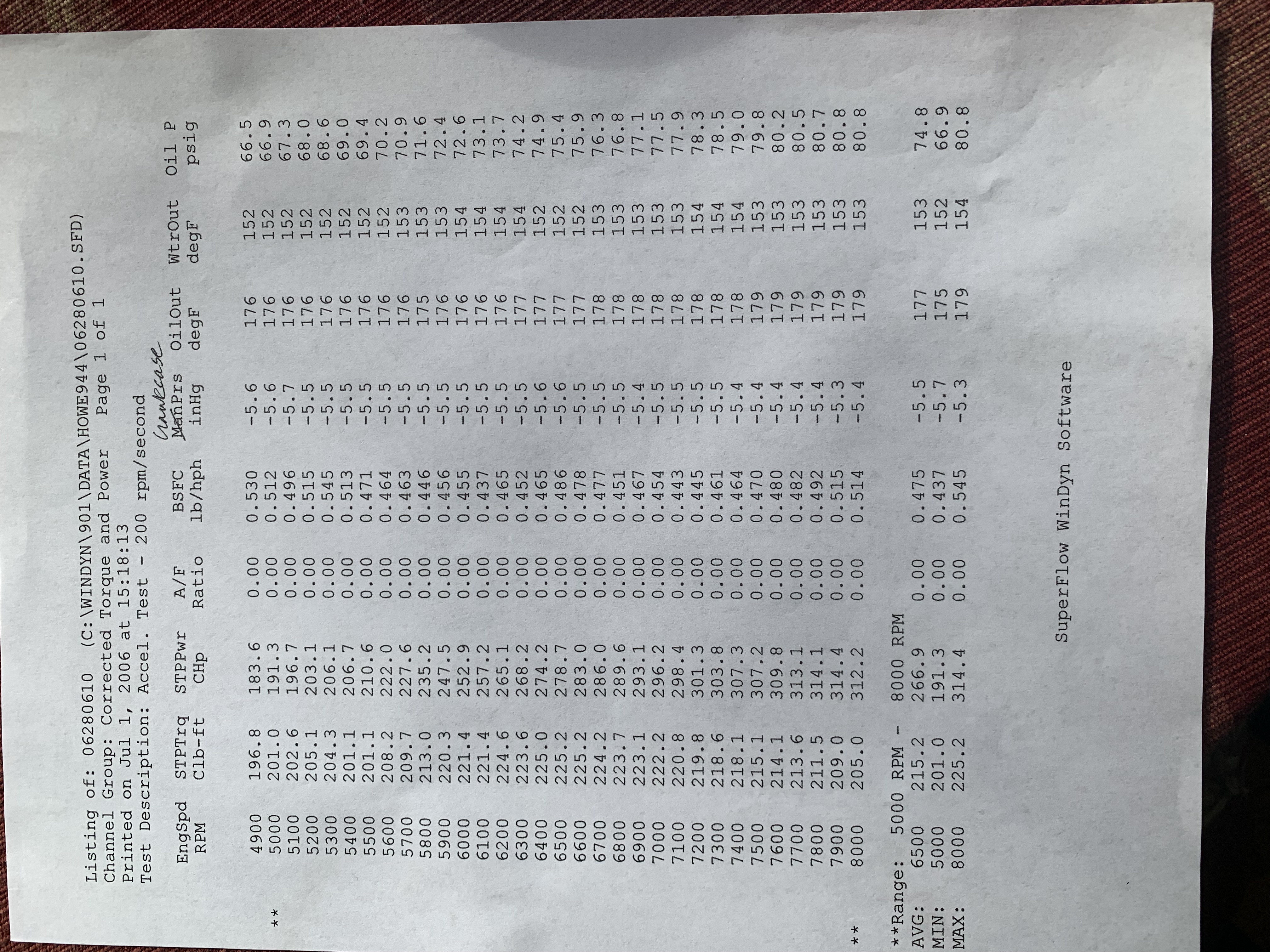

Ish_944
Posts: 8
Joined: Mon Jul 01, 2024 1:27 am
Has thanked: 7 times
Hi Michael,
Thank you so much for sharing your wisdom regarding these engines!
I'd also like to get your opinion and advice, if I may!
I had built a 2.85l stroker starting with a 2.5l block and a 3l crank, Pauter lighweight (for NA) rods, Chevy 4" pistons. The block was dry-sleeved and obviously bored to 4". CR is 10.9:1.
The engine has valve springs & injectors from the Turbo, a 'Road-Race' cam from Augment Automotive (from the UK), as well as their standalone ECU (which runs on IAT & MAP).
The rest of it is all stock.
My main goal with the build was to increase low-down torque, since the car is mostly street-driven.
Here is the dyno graph that it produced.
My questions are:
1. What are your observations of the dyno sheet? Does anything stand out to you?
2. Do you have any recommendations how to further improve it?
Thank you very much in advance! Your insight is very much appreciated!
