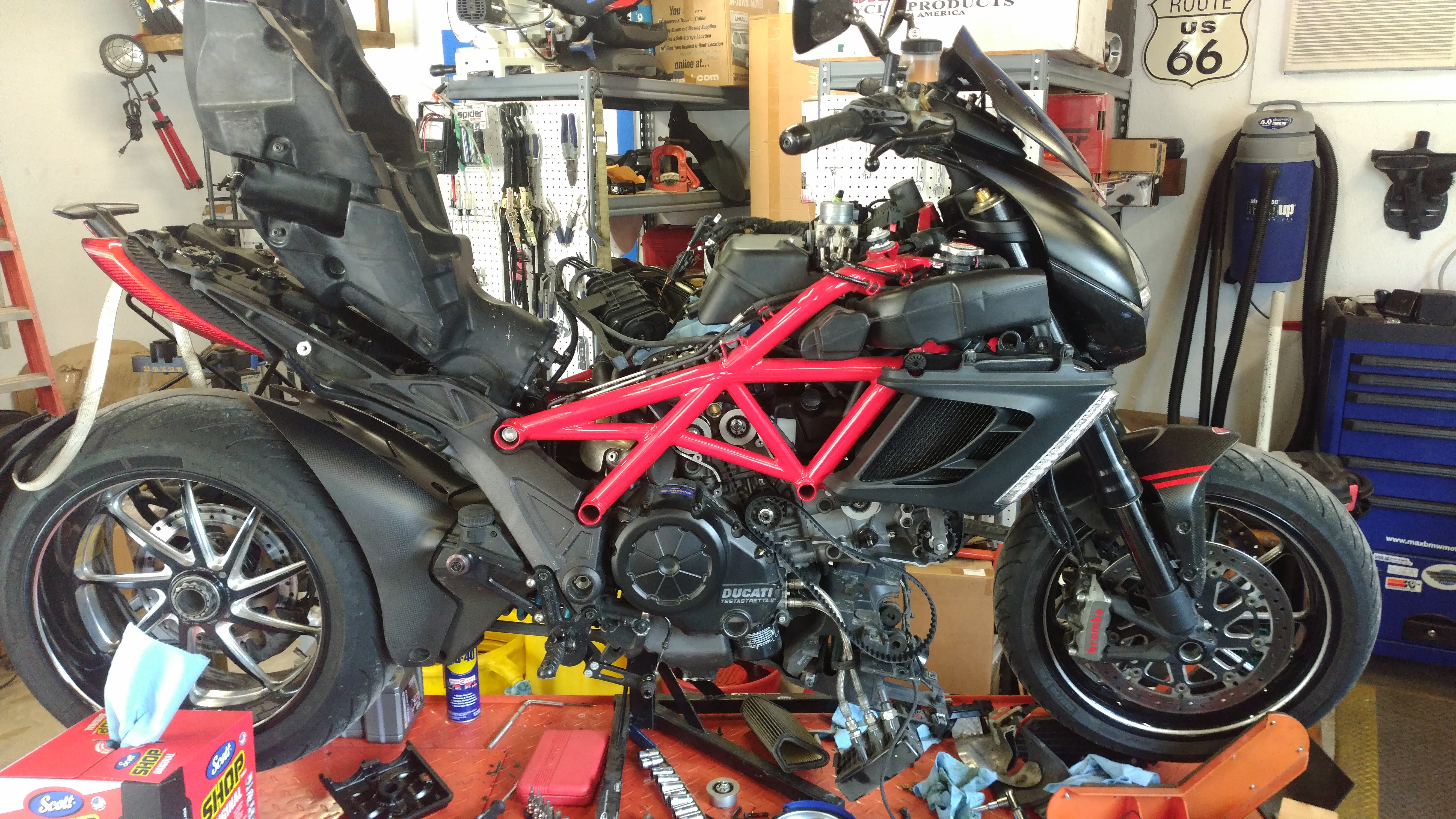

After radically downsizing my life, I no longer had complete control over my garages. The poor lighting is the greatest hindrance... much worse than single-space cramps. I've had to do some jobs outdoors, just to avoid the frustration of bad lighting.
White walls help a lot.
Here's my old shop. Nice and bright.
