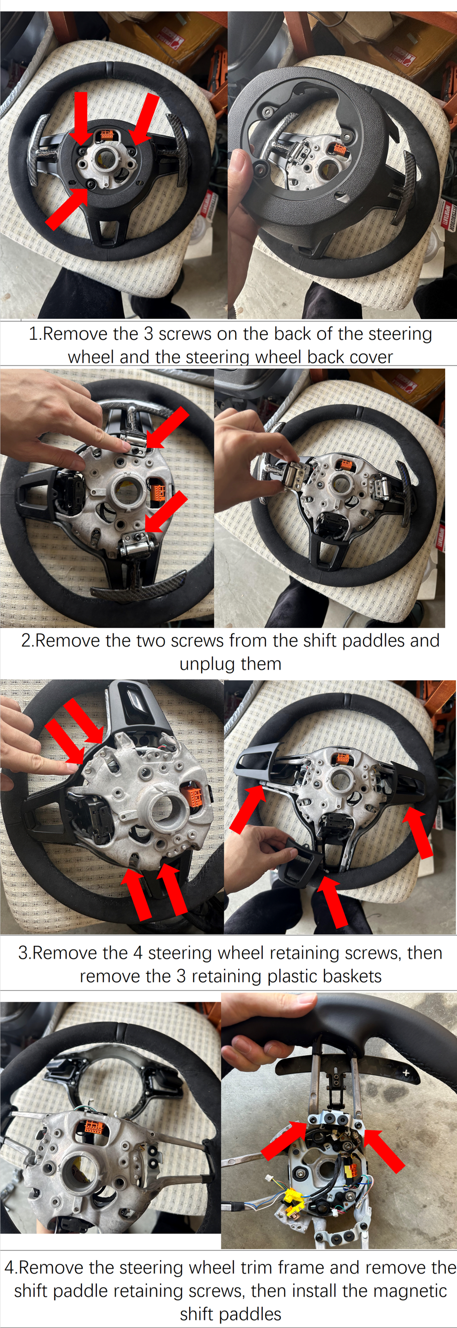

For those wondering, this is what it takes to replace the paddles. This is mainly why I decided to get some nice paddle extenders

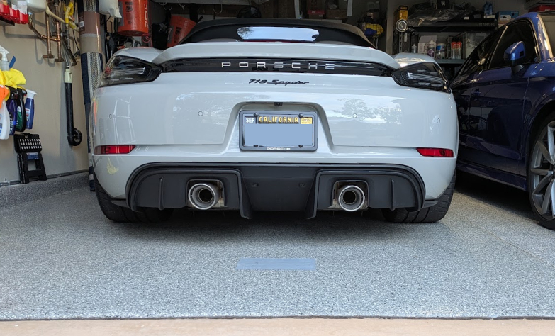

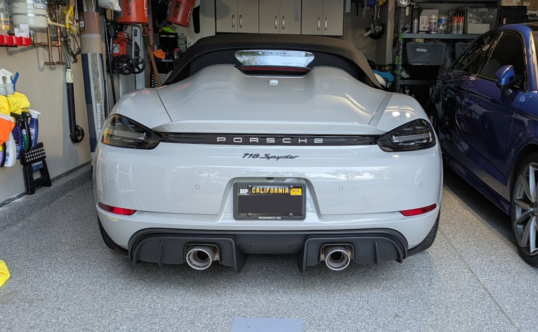

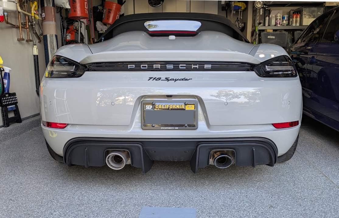

Ordered RS Weissach Pack style ti exhaust tips from Aliexpress at more than 1/10th of the cost of OEM.
I Just couldn't bring it to myself to shell out $3500 for OEM (I did almost bite at $1500 but that shop closed down).
They're normally 101mm diameter which is same as stock black tips, but they were able to send me 110mm by request; which fills the gaps a lot better, imo.
I spray painted the clamp hardware matte black, but probably not needed as these get covered up quite well with the larger version. Super easy to take off the old and put this on, majority of the time was working with small space to torque the bolt
It was also big pain trying to align it vertically, I just can't get it perfect... but I was "convinced" to let it go
Cleaned with isopropyl alcohol to avoid oils/fingerprints, but could use some advice on other prep for titanium exhaust. Read around other places to "prime" it with WD40, which may help when turning blue from heat or something else? Appreciate some insights before I take it out for a drive to "bake" in

Regarding pre-bake prep, I've no idea what, if anything, to use. Absent firm guidance from the manufacturer or a metallurgist, if they were mine I'd do nothing beyond the isopropyl cleaning you've already done.
