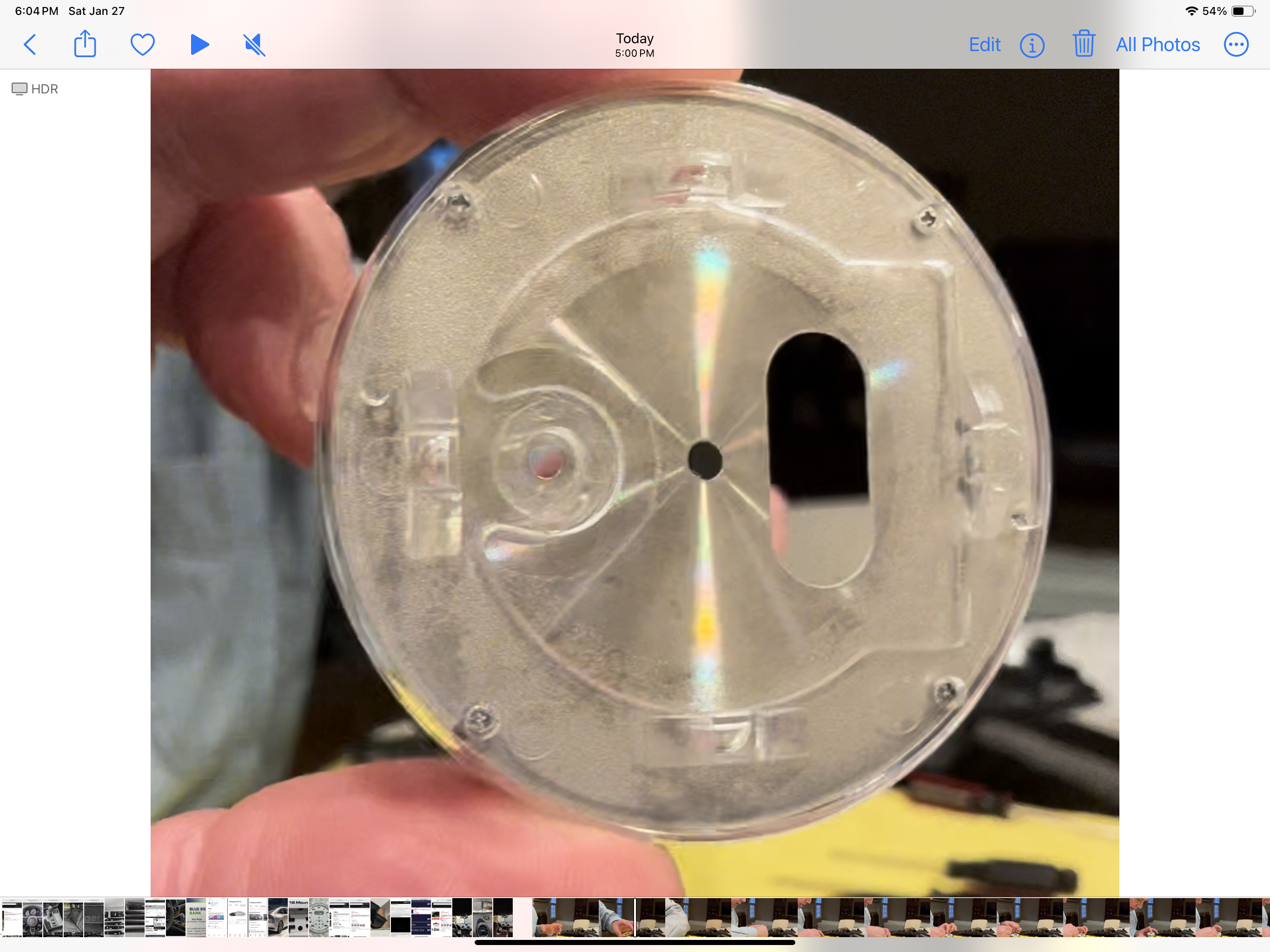

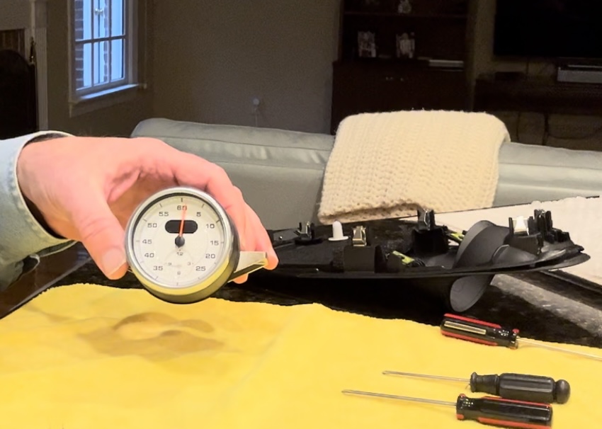

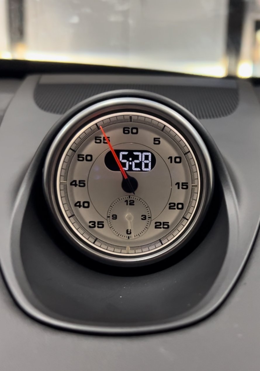

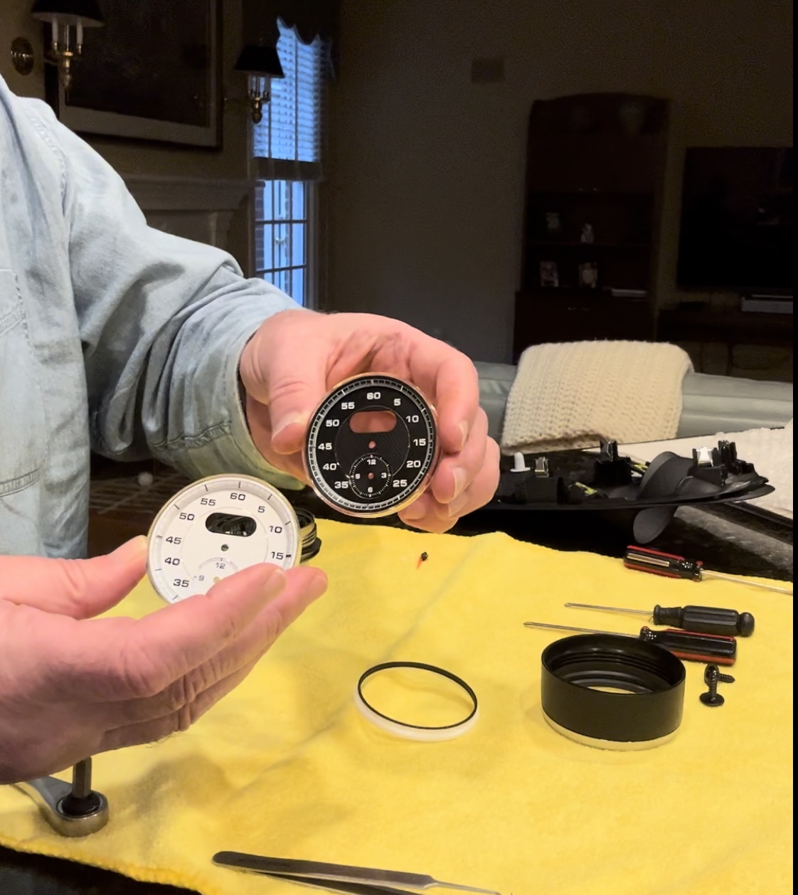

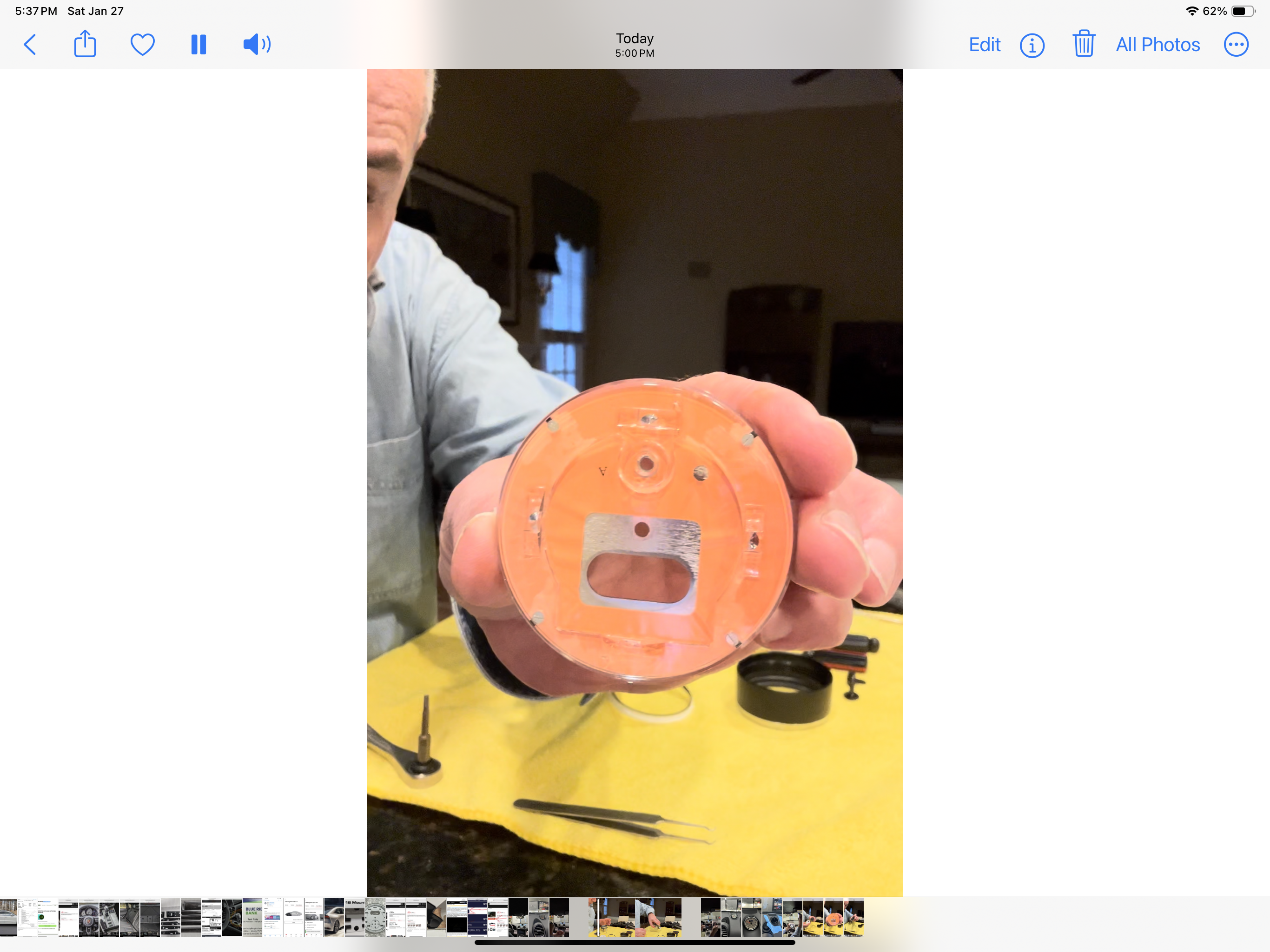

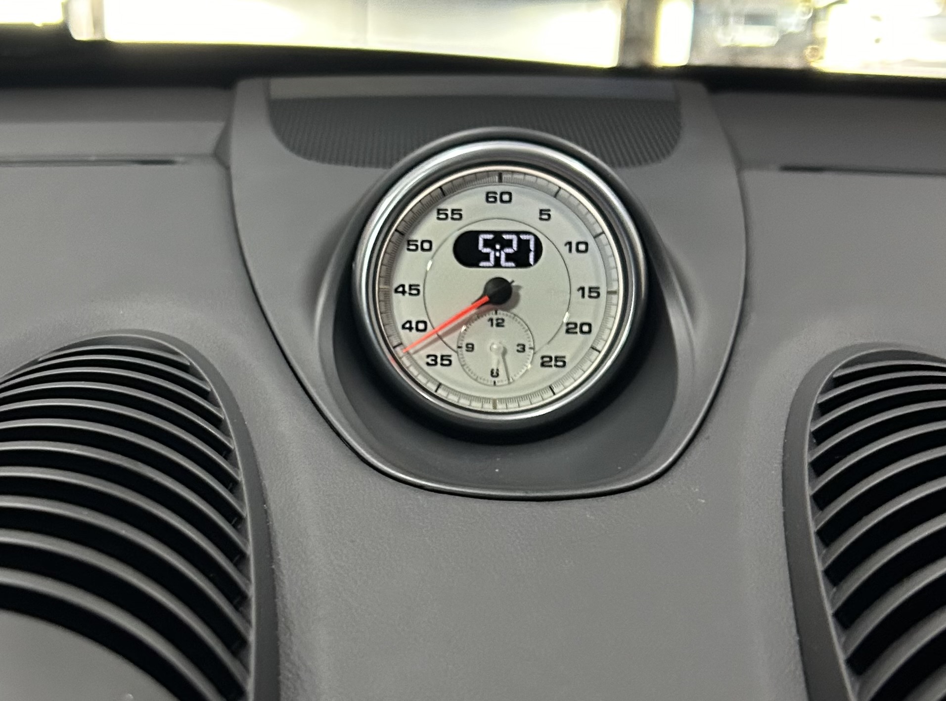

Purchased a white Chrono dial in November but just never got around to changing out my black dial. Wasn’t sure if I really wanted to but went ahead and gave it a go.
The orange backed dial is OE and the sliver finish is from AliExpress. Front finish other tha being white as well as weight feels the same as OE.
ImageHardest part of this was connecting the 2 cables back but part of that was I should have been in the passenger seat as the steering wheel made it harder to get to but again, minor stuff. I did some video’s but really not needed for this. Lift up the cover w/ a trim tool, have some needle nose pliers to make it easier to remove from connectors. Once done, find a well lit surface and recommend a light colored towel or paper and remove the two bracket screws. Chrono is then removed and unscrew the cap on front being careful to do so as the hands will fall off pretty easily and could be lost if not careful.
Once hands are removed, just take Chrono face off and install new one. Replace the three hands, holding face up so hands don’t accidentally come off and screw the cover back on. Put it back in the cover, tighten two screws, and go back and re-install unit in your car W/ the two plug-ins. Turn ignition to ensure everything is working and secure back in place.
This is a max 30 minute deal for your first effort and probably 10 minutes if you did it again.
I won’t upload vids but here are a few pics Showing the differences in OE and replacement dial from the rear as well as once installed. Total cost approx $60 plus your time.

I had to go back and correct the small hour hand as it wasn’t moving properly. Didn’t notice when I took the pics that it was an issue but whenI looked at them blown up, had to go back in. Once you do it once, its pretty simple.
