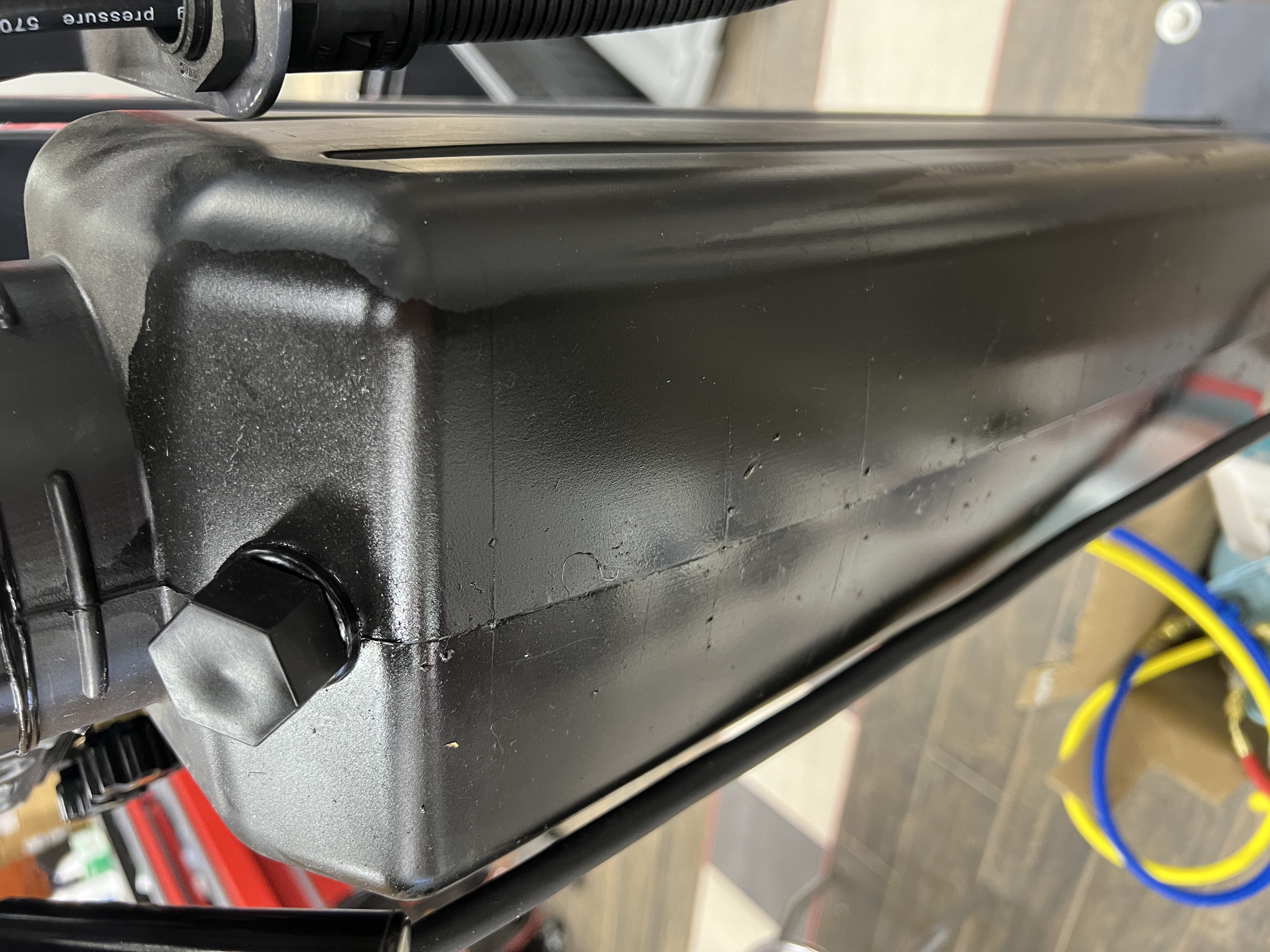

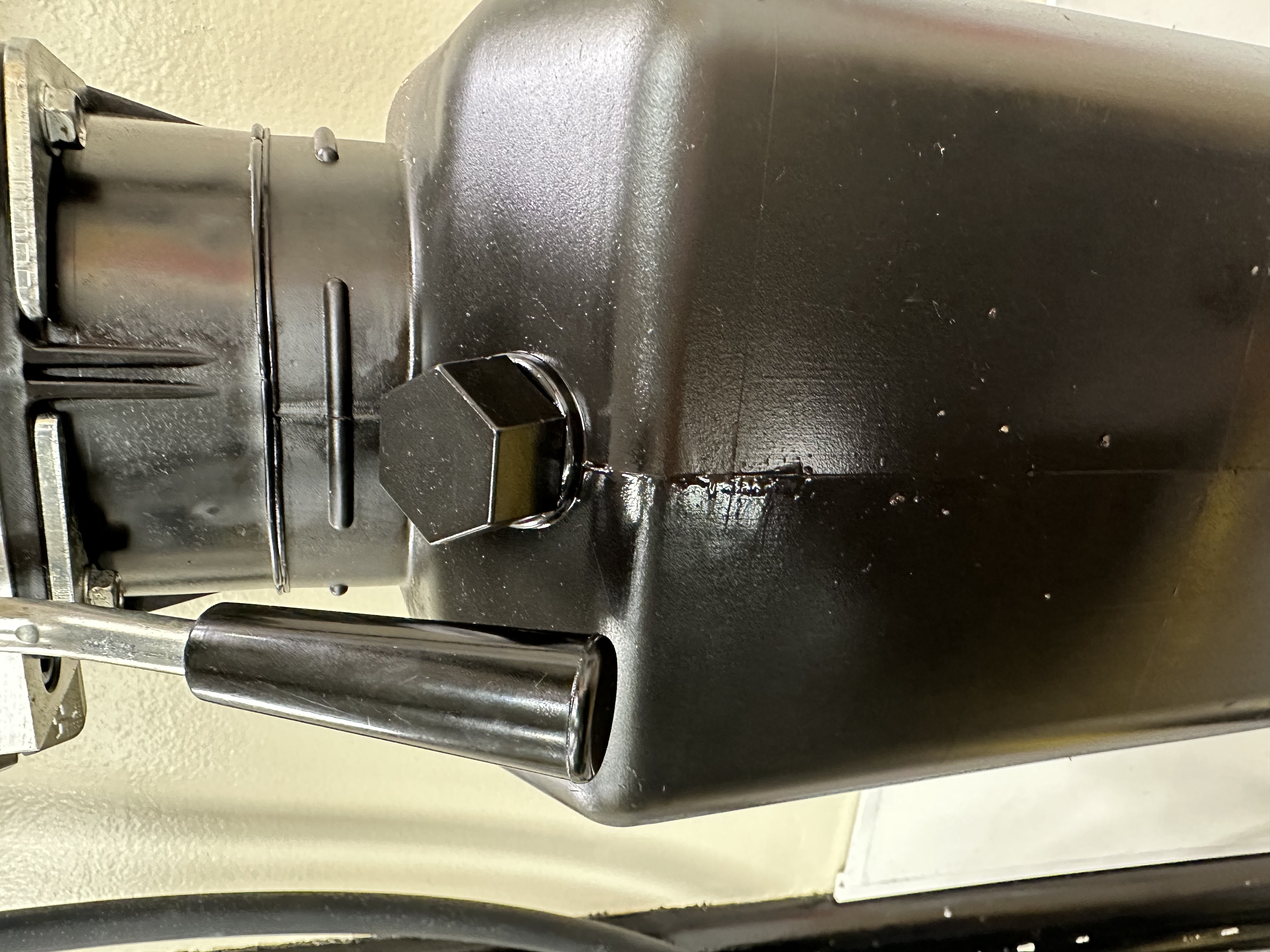

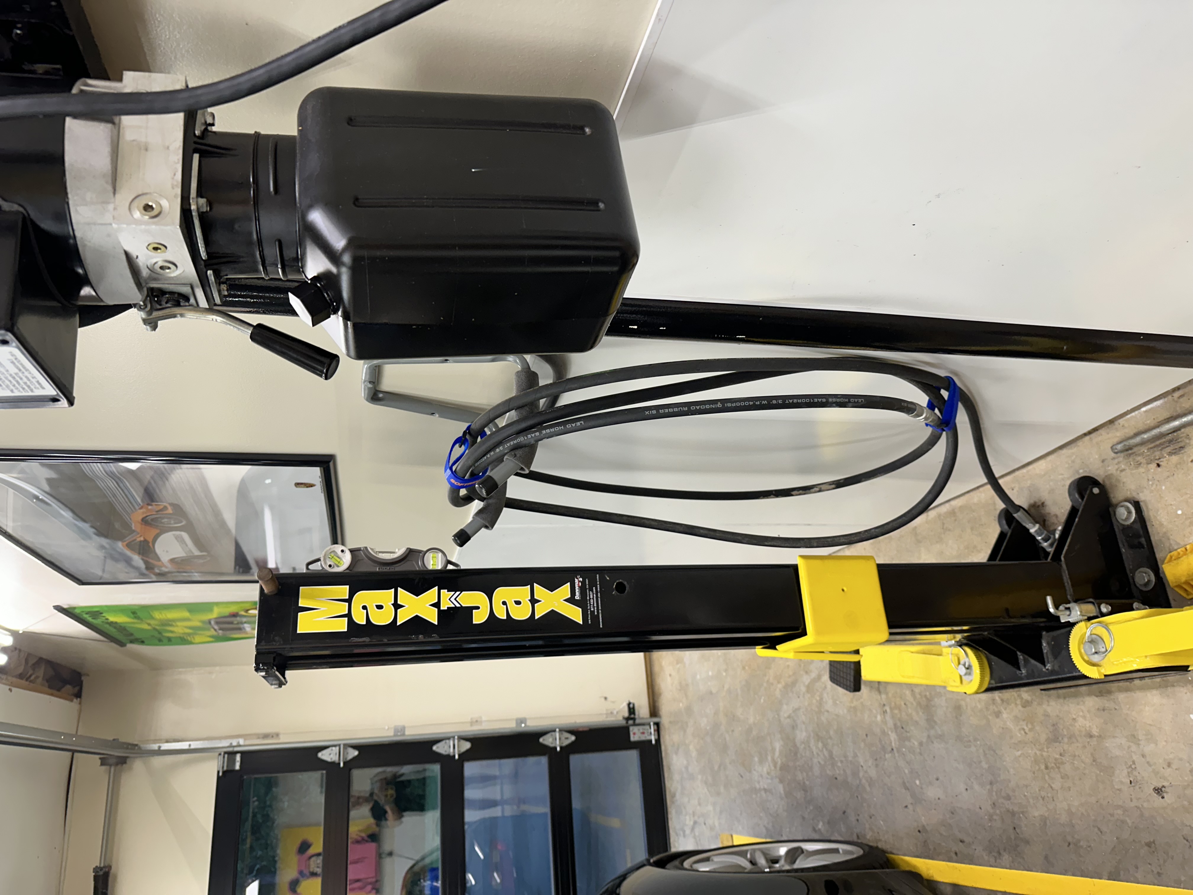

For those with Maxjax with wall mounted and extended hoses I have a question. The reserve tank is just a little bit shy for volume of liquid I need. After long time of not using it the fluid leaks from the reservoir. I need a larger reservoir I think...

The increased length of your non-standard length hoses store the excess hydraulic fluid. The reservoir (I am assuming it is the factory unit) only needs to fill the cylinders.Maruscmn wrote: Tue Aug 13, 2024 5:13 pmFor those with Maxjax with wall mounted and extended hoses I have a question. The reserve tank is just a little bit shy for volume of liquid I need.
Leaks from where? Is there a hole or a split in the reservoir?Maruscmn wrote: Tue Aug 13, 2024 5:13 pmAfter long time of not using it the fluid leaks from the reservoir.
Alex
It appears to be the fill hole. Maybe I have to mount it with a shim..

I can't remember how large that reservoir is in quarts or liters, but maybe you over filled it. Mine is bone dry using the hoses as supplied.
The fluid in the reservoir simply needs to fill the two cylinders no matter how long the hoses are. Or maybe I am missing something.

I can't speak to the Max Jack per se, but that tank and associated hydraulics look they came off the same parts shelf as my BendPak 4-post lift. Yours is a little smaller, but otherwise pretty much the same. My tank was constantly seeping out the filler port just like that. After a couple years of that, I eventually started taking out very small amounts with a turkey baster until it stopped seeping. I did it over the course of a few months, maybe 1 tablespoon at a time...until the seeping stopped. The lift seems as good as ever with the slightly lower fill level. The official fill amount just seeps like that, at least on my lift.
