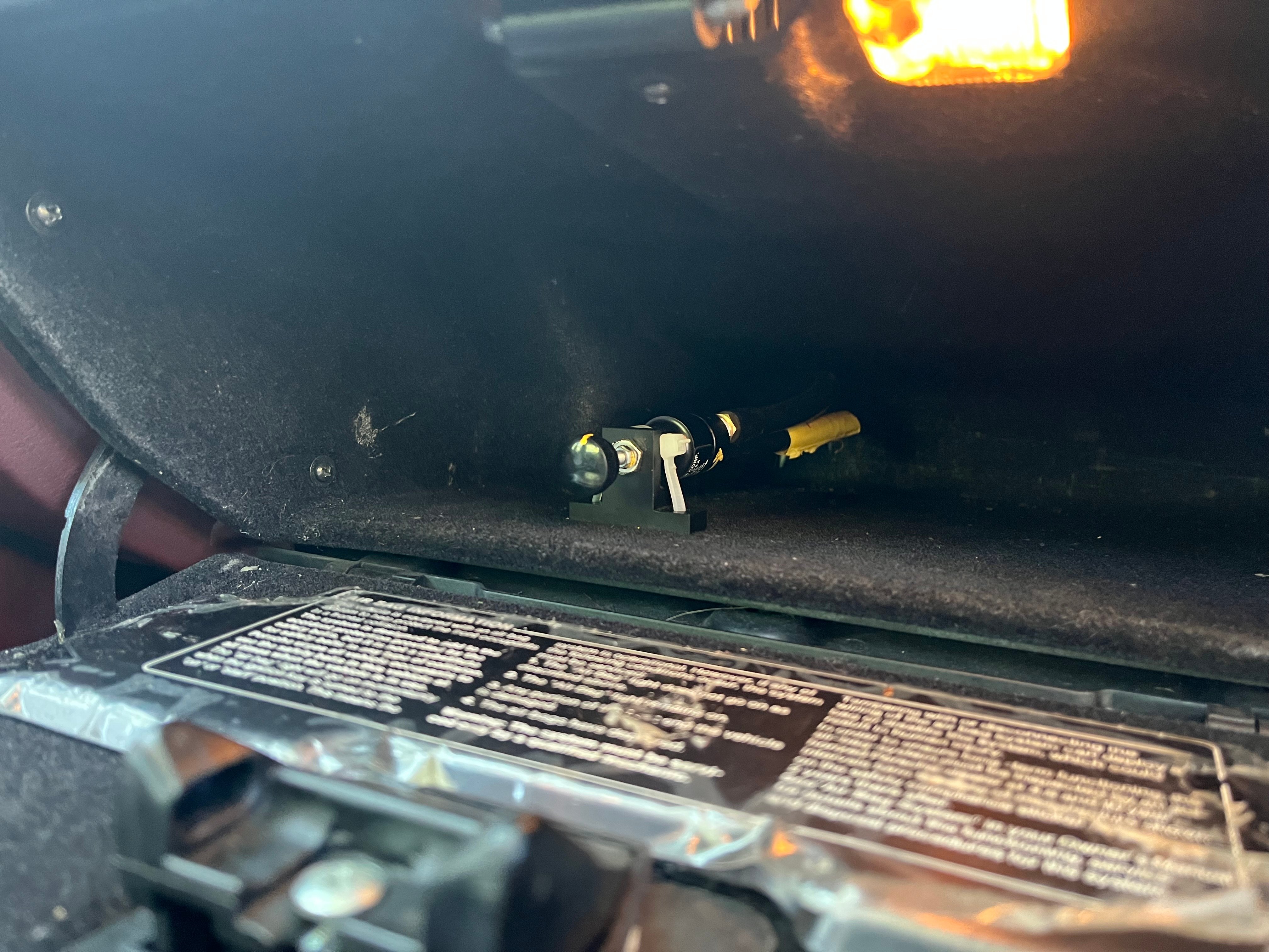

I have a 0.9 bar spring (about 13psi), which is higher than what I would pick for a dual port configuration - but that is what came installed. I'm using a small regulator valve as a MBC (not from Lindsey racing) and it's installed in my glovebox. I'm only allowing a small amount of pressure, about 2 psi, into the second port and thus keeping the max boost around 15 psi. I rigged up a temporary pressure gauge when I was making the initial adjustments, but then removed it once I felt all was well.
