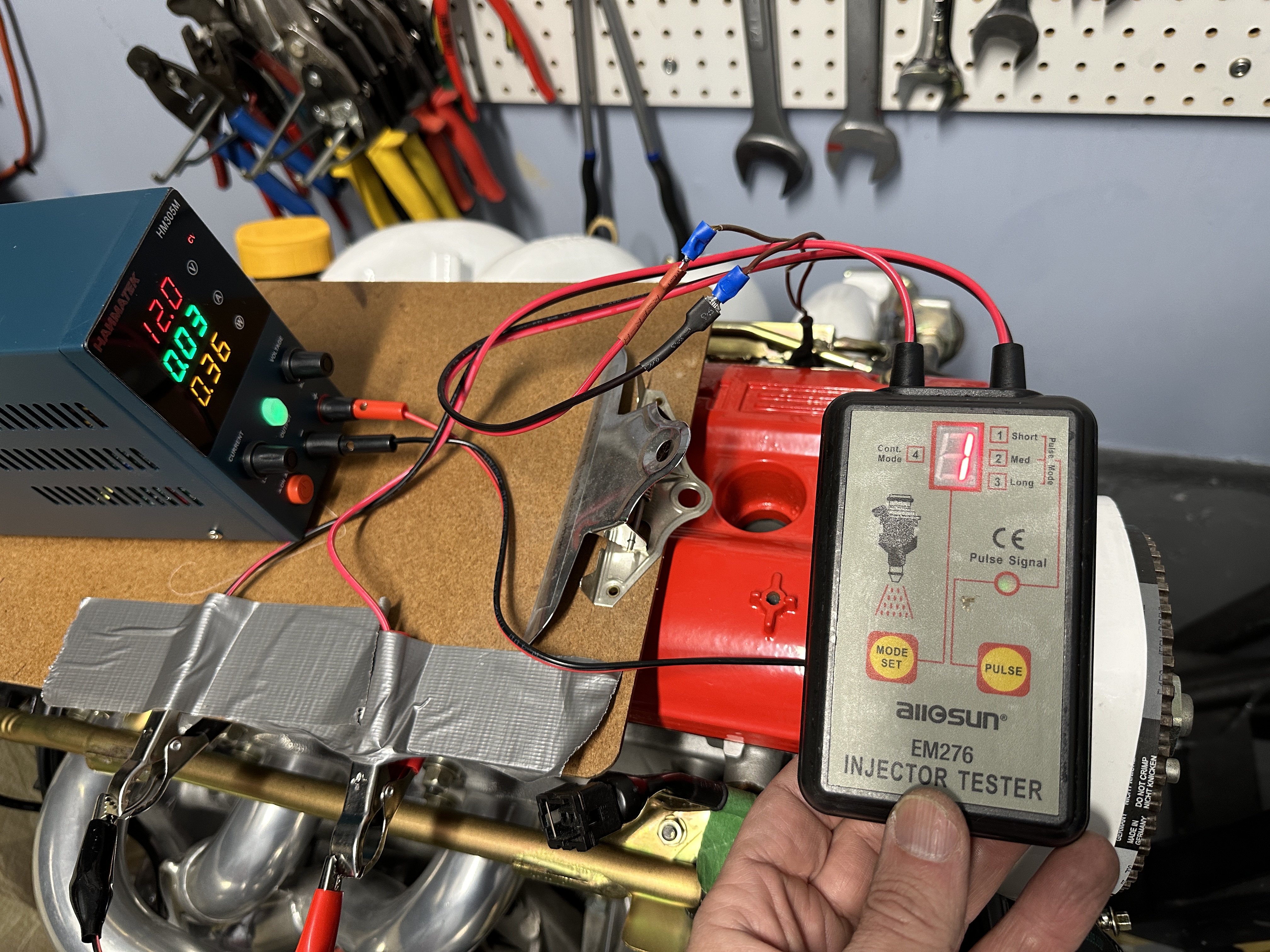

After that was done, I hooked up a DC power supply to a cheap injector pulser I purchased from Amazon. I scavenged one of the injector connectors from the old harness and used that to test each injector to make sure they were still firing. Some years back, I sent them out for cleaning and replaced the seals and caps. I figured they should still be OK, but since I had the pulser, I figured it made sense just to check as it is one less thing to trip me up.

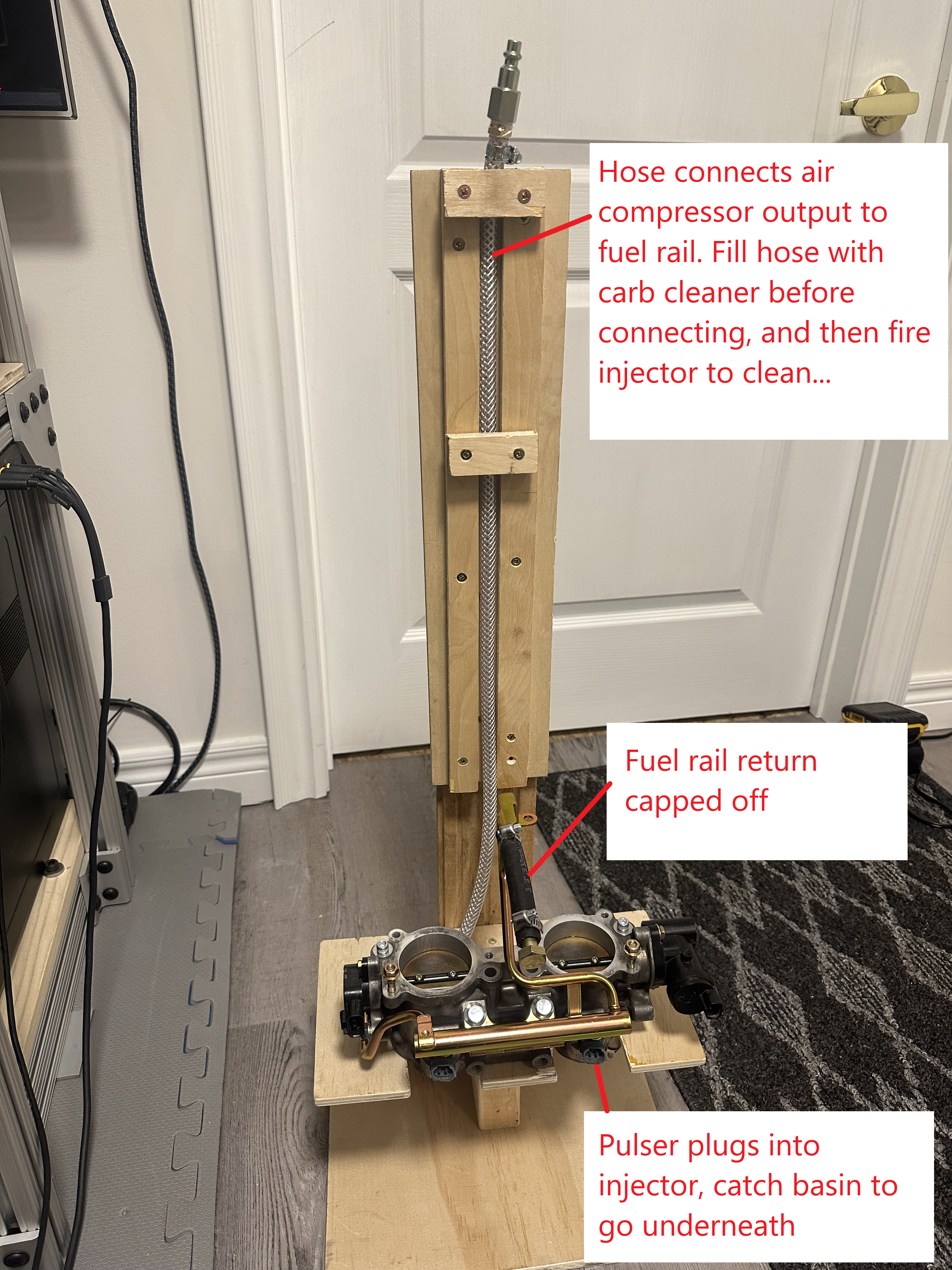

I had actually got the pulser when I was working on the Subaru. Having learned a little more about how injector cleaning is done, I decided to make up own apparatus. Basically, I used pressurized air (approx. 20 psi) to flow carb cleaner through the injectors, using the pulser to continuously fire the injectors. It worked very well, and a similar approach could be used for the 944, so here was the set up I did for the Subaru:

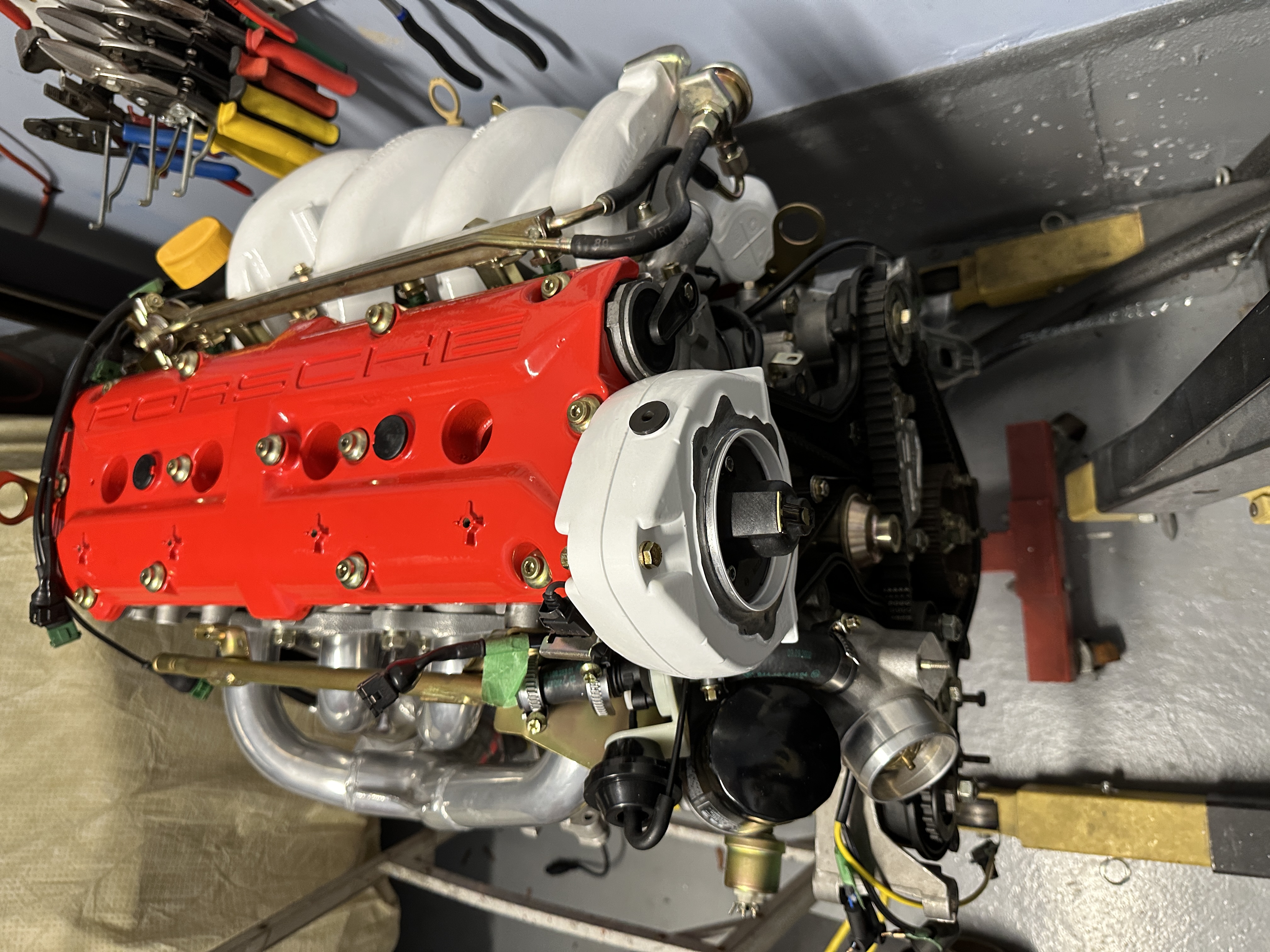

The only thing actually done on the car was putting in spark plugs (went with NGK BPRES6), a new rotor, and the front housing:
Only thing I will still do on the engine prior to installation is finally connect the rest of the wiring (fuel injectors etc.) as I left it unconnected in case I needed to move things around, which I did…

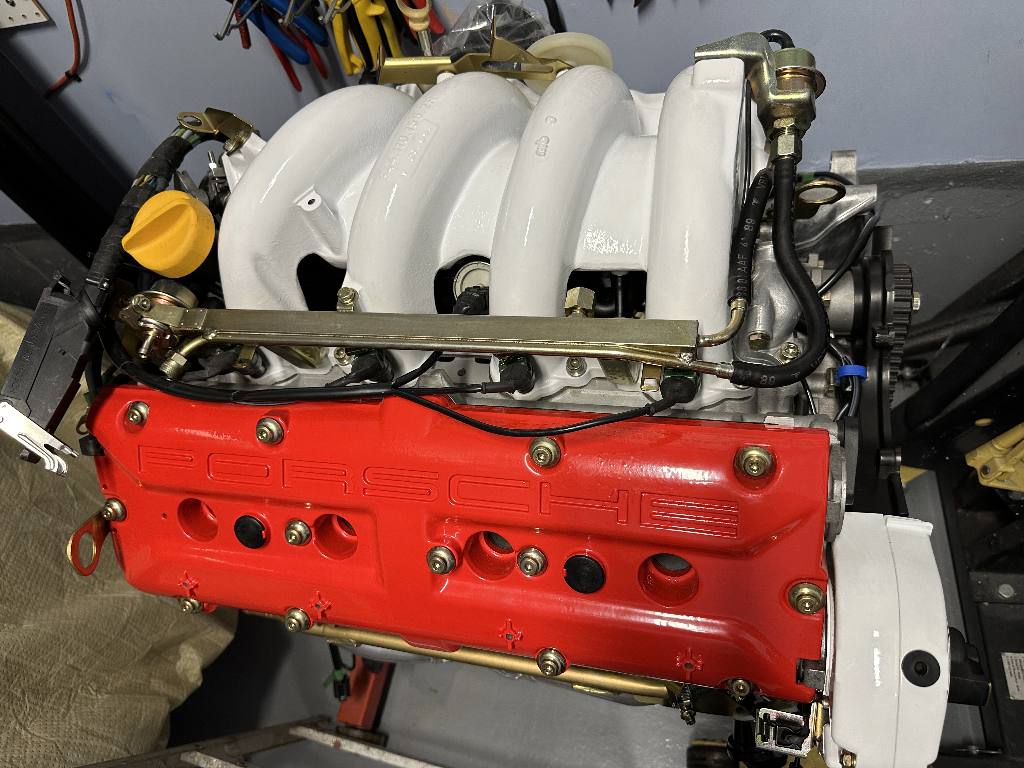

I'm still in awe of your patience and attention to detail! You may have already contemplated this, but if you want to make the "PORSCHE" pop on that cam cover, Garage9 has the black letters to fill in the emboss:

NCGermerican wrote: Wed Mar 27, 2024 11:05 am ...You may have already contemplated this, but if you want to make the "PORSCHE" pop on that cam cover, Garage9 has the black letters to fill in the emboss:
https://garage9.com/collections/944/pro ... 3480226868
They are heat resistant and mine has held up well.
I had not really thought of those before, but now that you have shown me, I am thinking this is something I might do as a final touch at the end (have a few more mission critical items to buy still, e.g., radiator).
I see that they also have white version, which I think would integrate nicely, although the black would look good too. I need to think about it.

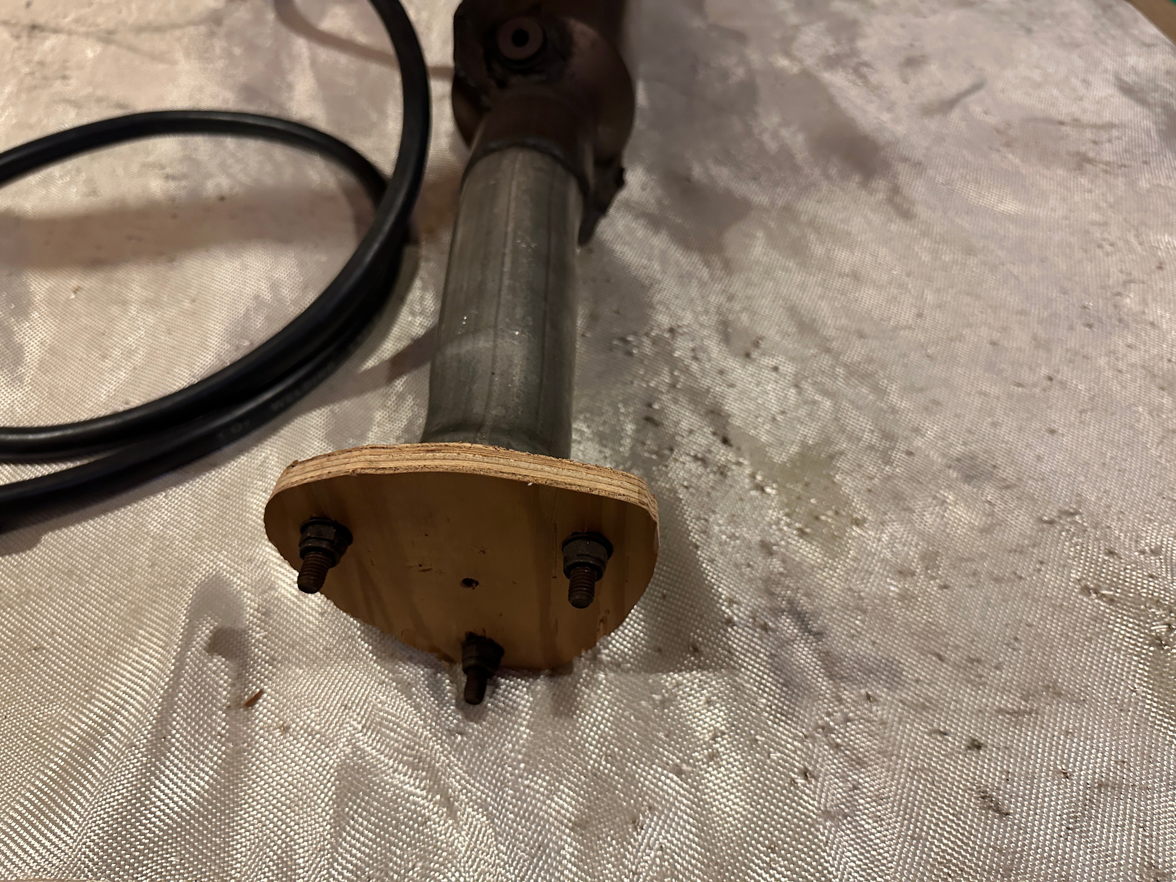

The other thing I started working on is repairing the mid-pipe. When I got the car, the mid-pipe was completely broken at the entrance to the cat.
Previously I had cleaned and butt-welded it back together as a first step.
The next step will be to weld on some reinforcements. I used to have a DC inverter TIG welder, which was a beautiful machine, but when I moved, I sold it as the new place did not have the right power. Now I have a small MIG machine for "around-the-house" stuff. For welding the S/S exhaust, I now use a flux-core S/S welding wire which does a decent job structurally, but it is pretty bad cosmetically.
Anyway, it is also necessary to back-purge the weld area, so I spent some time getting things ready. Essentially a matter of blocking off the openings in the pipe and feeding the purge gas in:
The gas enters ahead of the cat, and the blocking plate at the back has a small hole, to allow the gas to flow.
For the reinforcements, I cut up two diameters of 304 S/S tube which I will weld over and around the area that originally broke.
I only got as far as setting things up this past weekend, as I did not have much time. If things go well, I will finish the job next weekend.
Later, once the engine is in, the exhaust will be test-fitted and if all is good, I will get it Cerakote coated.

Enjoying following along with this amazing journey. In case you are not aware and would like to be, the mid section of exhaust you are working on is not an original exhaust part. It appears to be rather carelessly designed / made compared to the factory piece, in particular at the two to one juncture. This may or may not have an impact on performance, sound and longevity. Just FYI, carry on :clap:

barnwerks wrote: Tue Apr 02, 2024 3:10 pm Enjoying following along with this amazing journey. In case you are not aware and would like to be, the mid section of exhaust you are working on is not an original exhaust part. It appears to be rather carelessly designed / made compared to the factory piece, in particular at the two to one juncture. This may or may not have an impact on performance, sound and longevity. Just FYI, carry on :clap:
That is very good information... I had thought a few times that the part did not look brilliant, especially the way it necked near where it had broken ahead of the cat. Now that you have woken me up to the realization that it is likely some sort of repo, I will consider a longer-term goal to find a good genuine sample. If it takes a while, I will just continue to use this one.
Thanks again. I had not considered that possibility until you mentioned it.

Following up on the exhaust, I spent some time online searching up pictures of the genuine mid-pipe, and the physical appearance differences are quite marked. It bothers me enough that I am sure I will be sourcing a genuine replacement. However, it won't be cheap, so I think I will go ahead with finishing up the repair and probably use this piece for initial start up and running. Not sure when I will actually purchase the genuine parts, but it will wait until the other critical items still remaining are sourced.
On the one hand, I am slightly bummed since I now have more expense incoming, but on the other hand, I am glad I learned this. I did think that the fit & finish on the mid-pipe was poor in comparison to the tail pipe unit (which I think is genuine, but I will post pictures eventually when I dig it out of storage).
Here is a photo I found online of the genuine part:
It is very clear that the lengths of the tubes ahead of the "Y" are considerably different than in the part I have.
