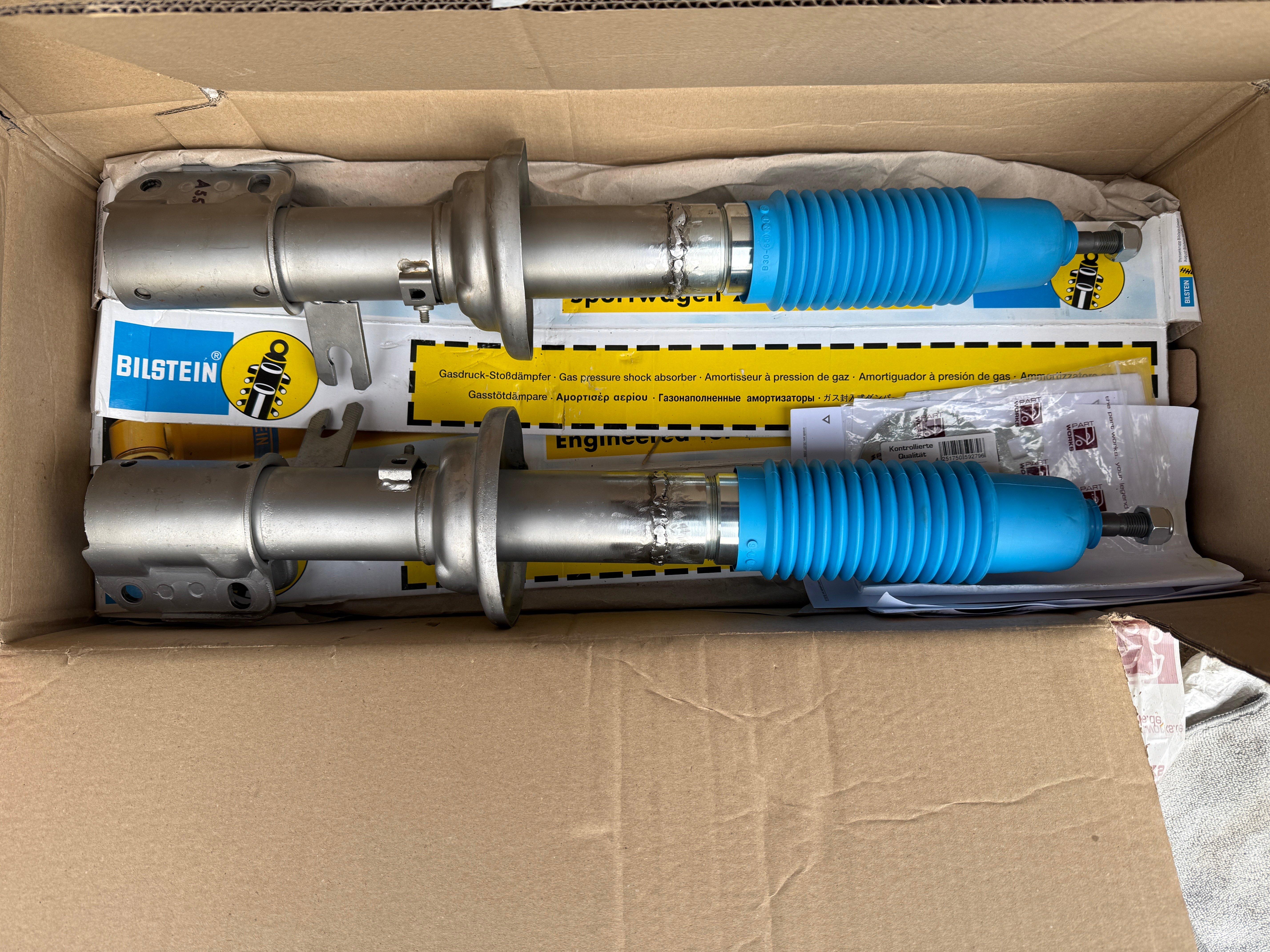

The conversion kit comes this week. Had to pay a $100 tariff on it :lol:

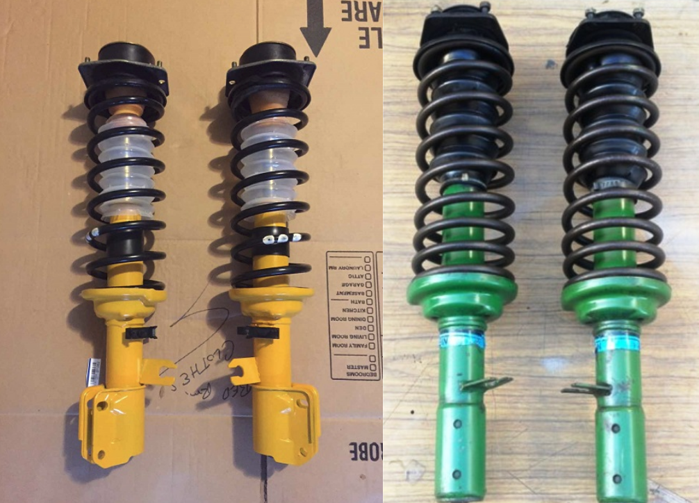

Yellow or green? Can the late car run the green Bilstein shocks in the rear?

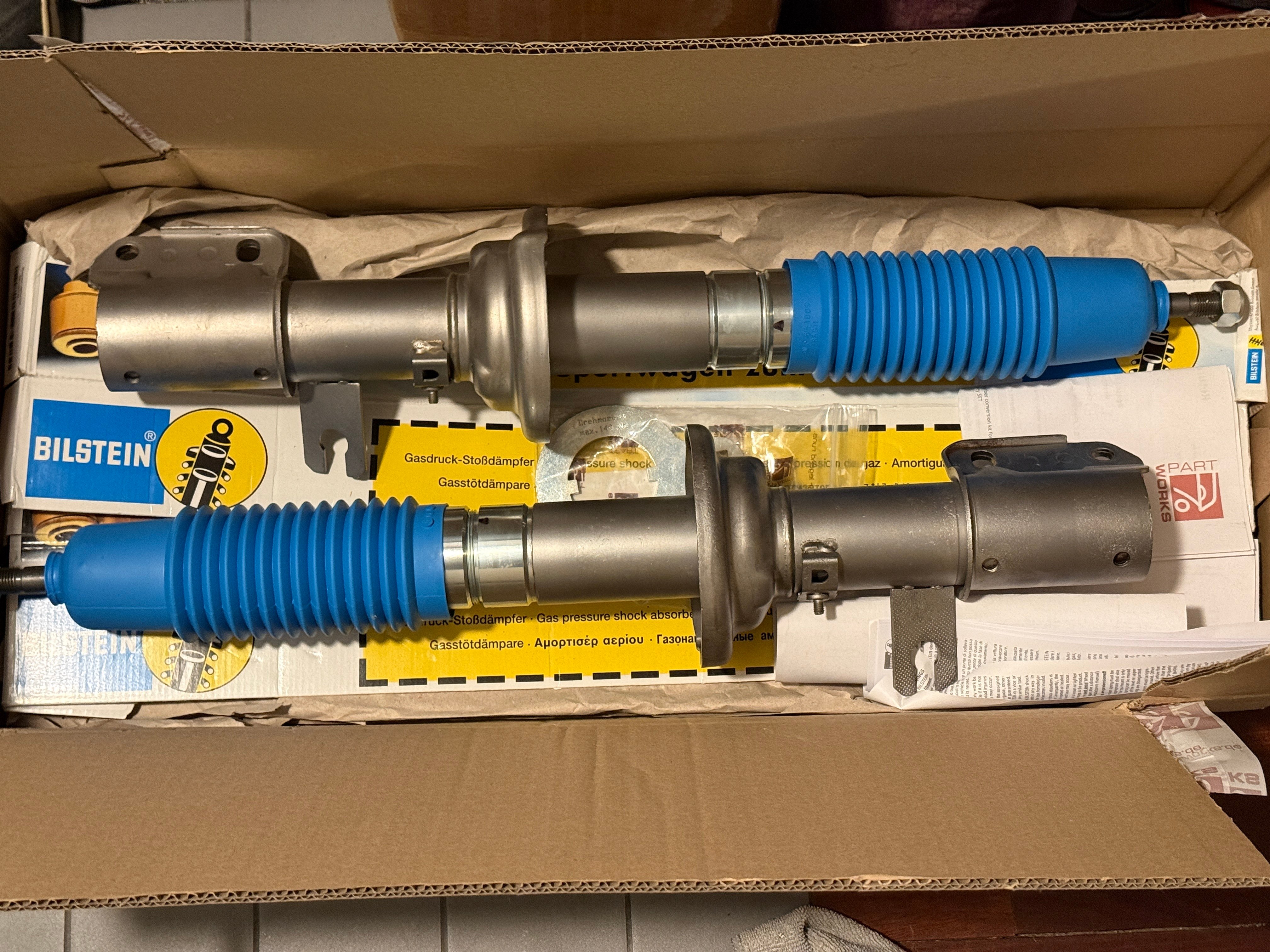

spacecad3t wrote: Tue Jan 20, 2026 1:30 pm Can the late car run the green Bilstein shocks in the rear?
The green ones are for steel trailing arm cars, yellow are for aluminum trailing arms.

Bummer, sounds like yellow paint then.

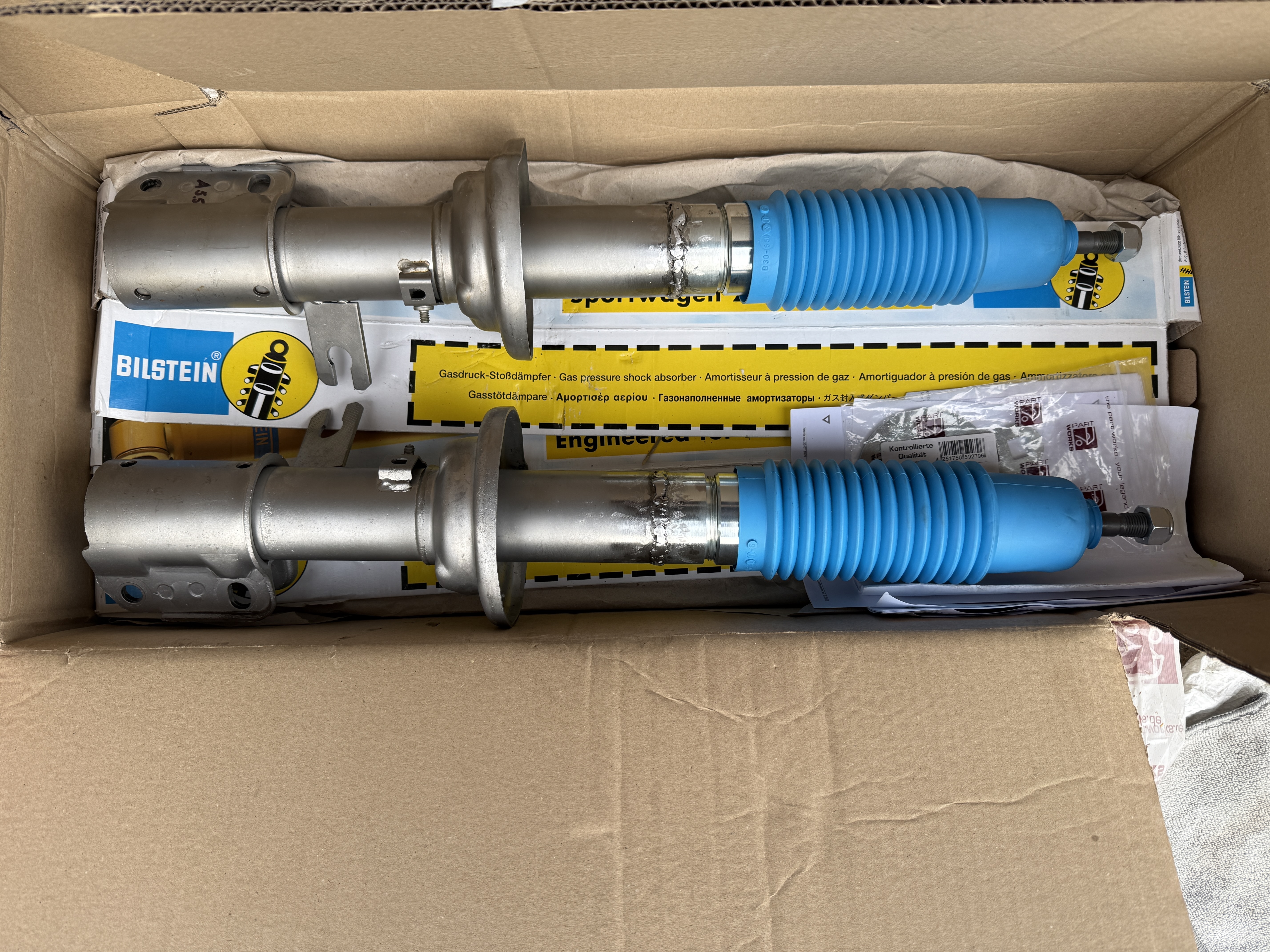

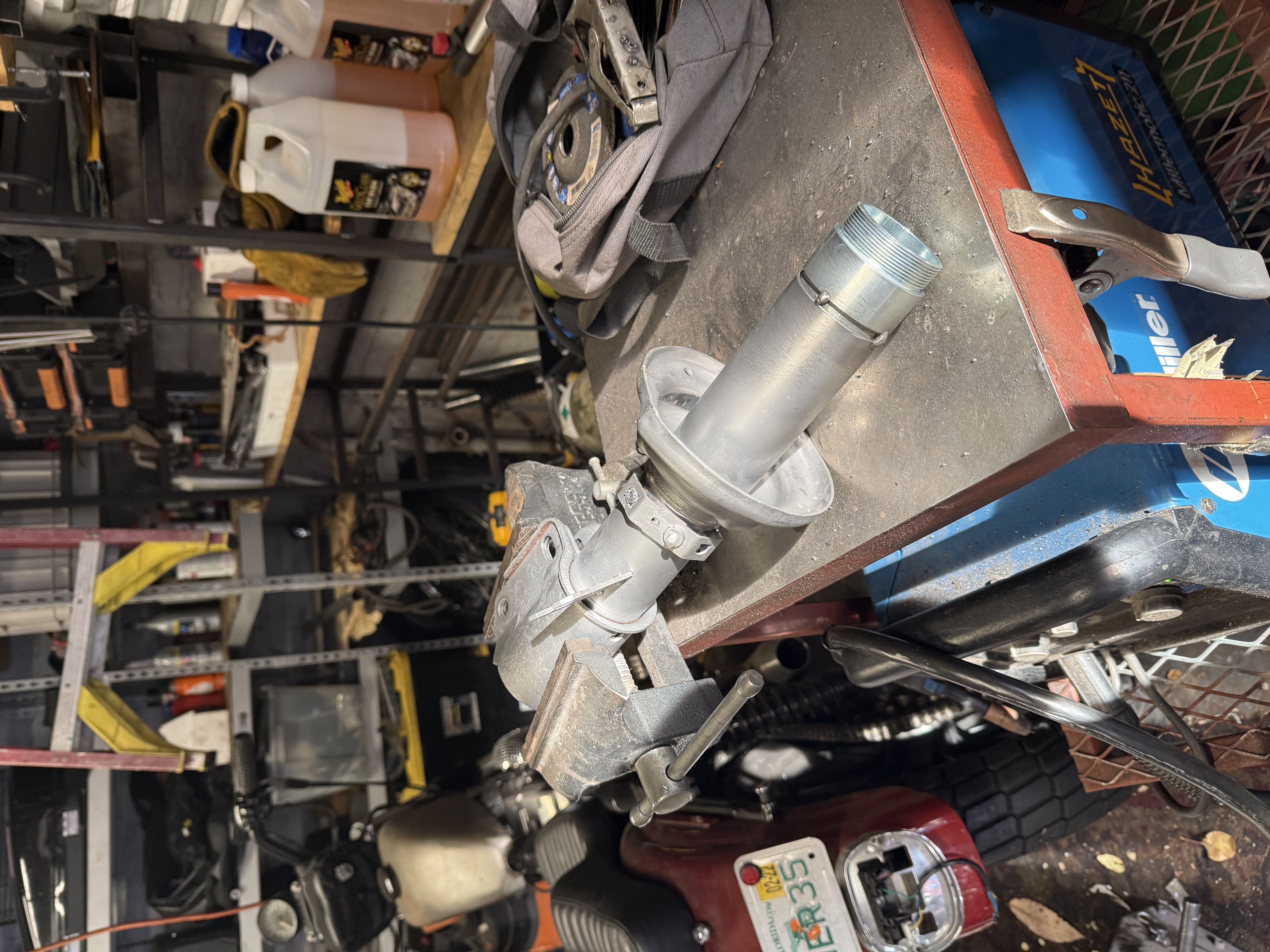

Test fit. Both sleeves have about 3-5mm gap to fill. Both inserts are tightened down with 6 turns on the cap, the guide says "greater the 5". So I think we're a go for welding. Kinda hot all metal like that :D

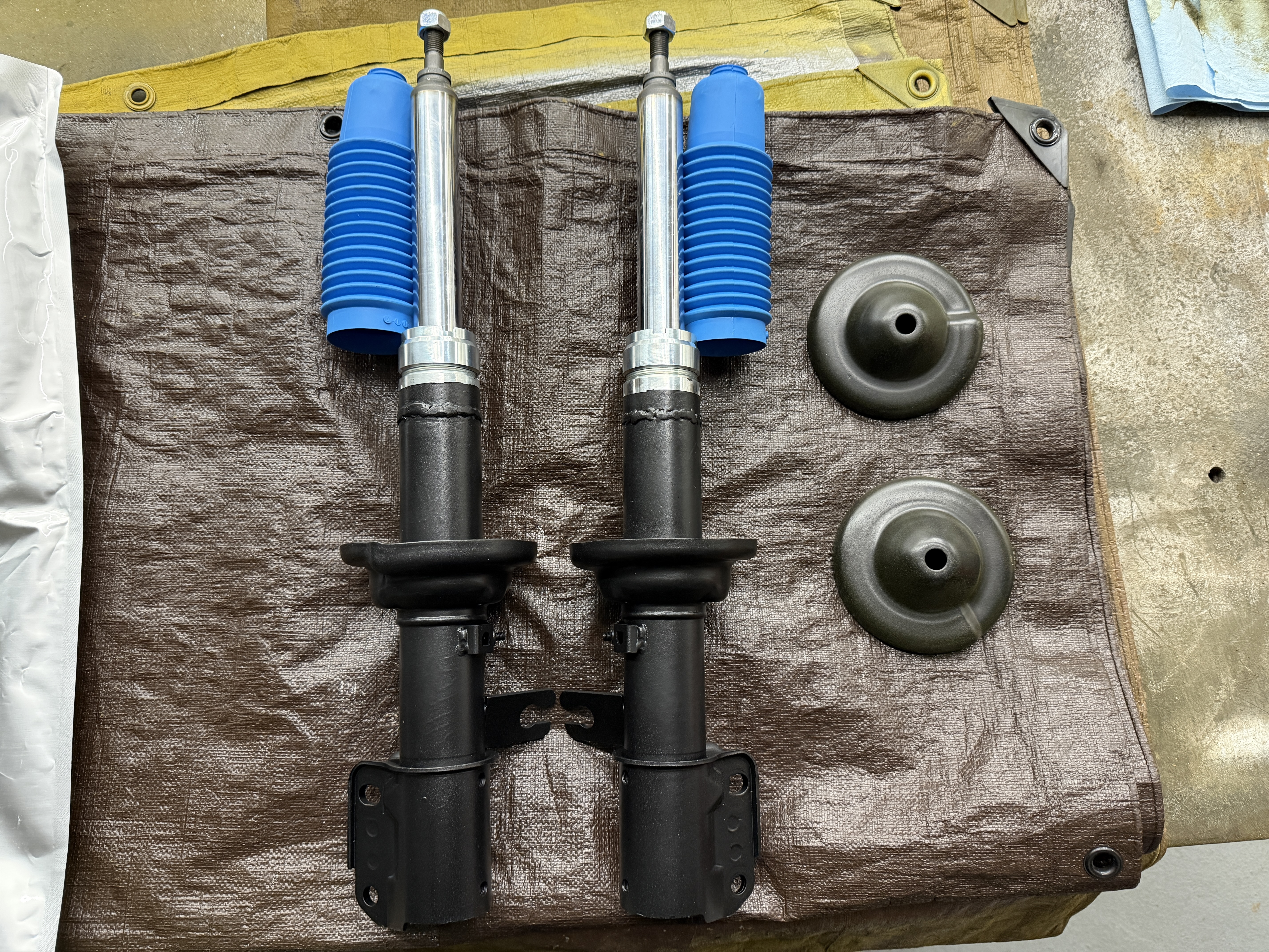

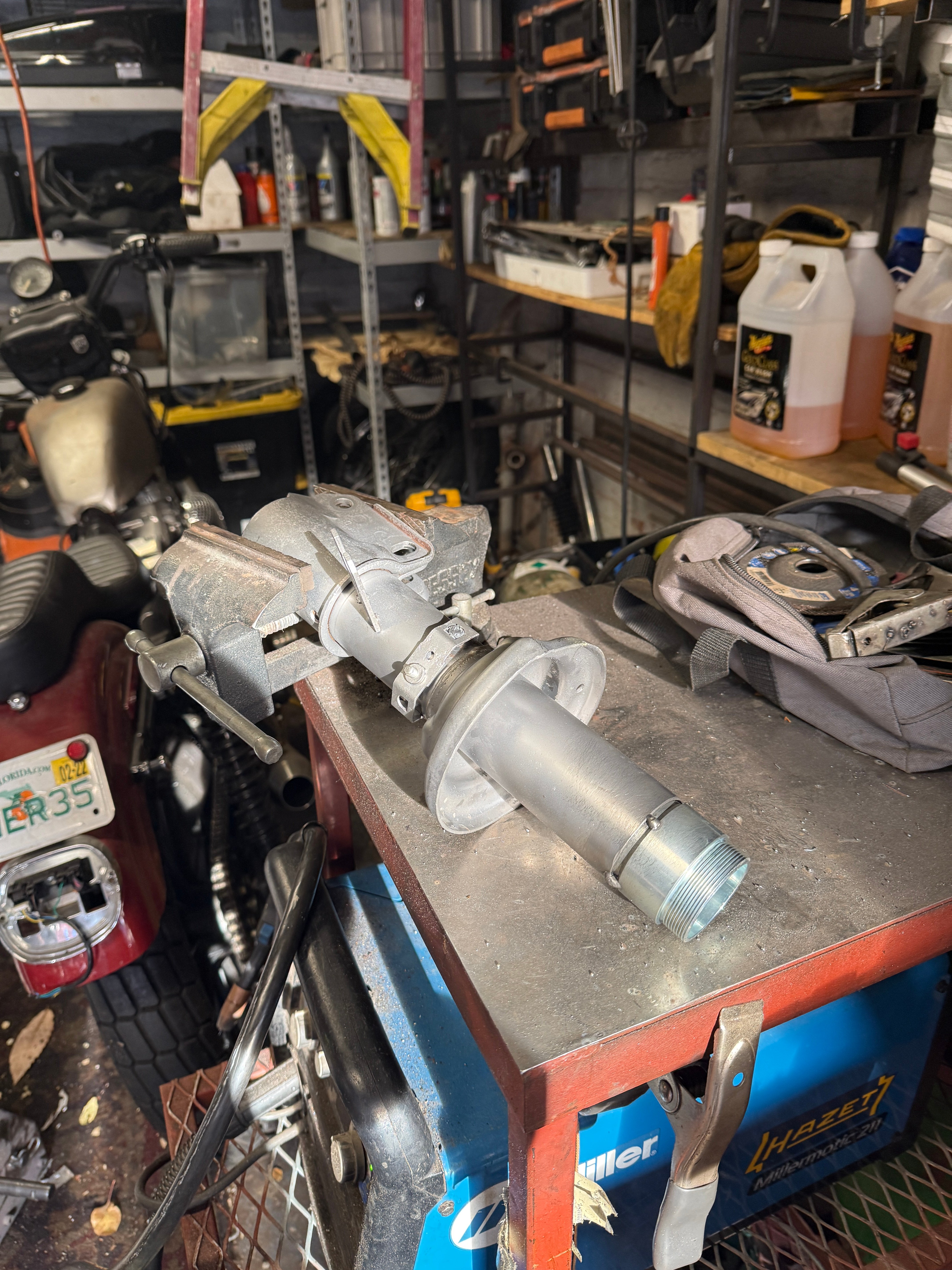

And welded up. Im rusty, and was already a ¯\_(ツ)_/¯ welder... but ready to paint :D

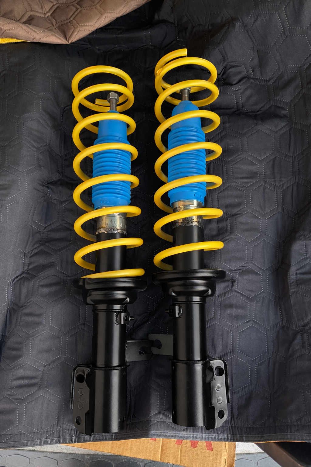

Edit: I gave ChatGPT an image and ask it to recommend a color scheme, got this back. I think I like it.

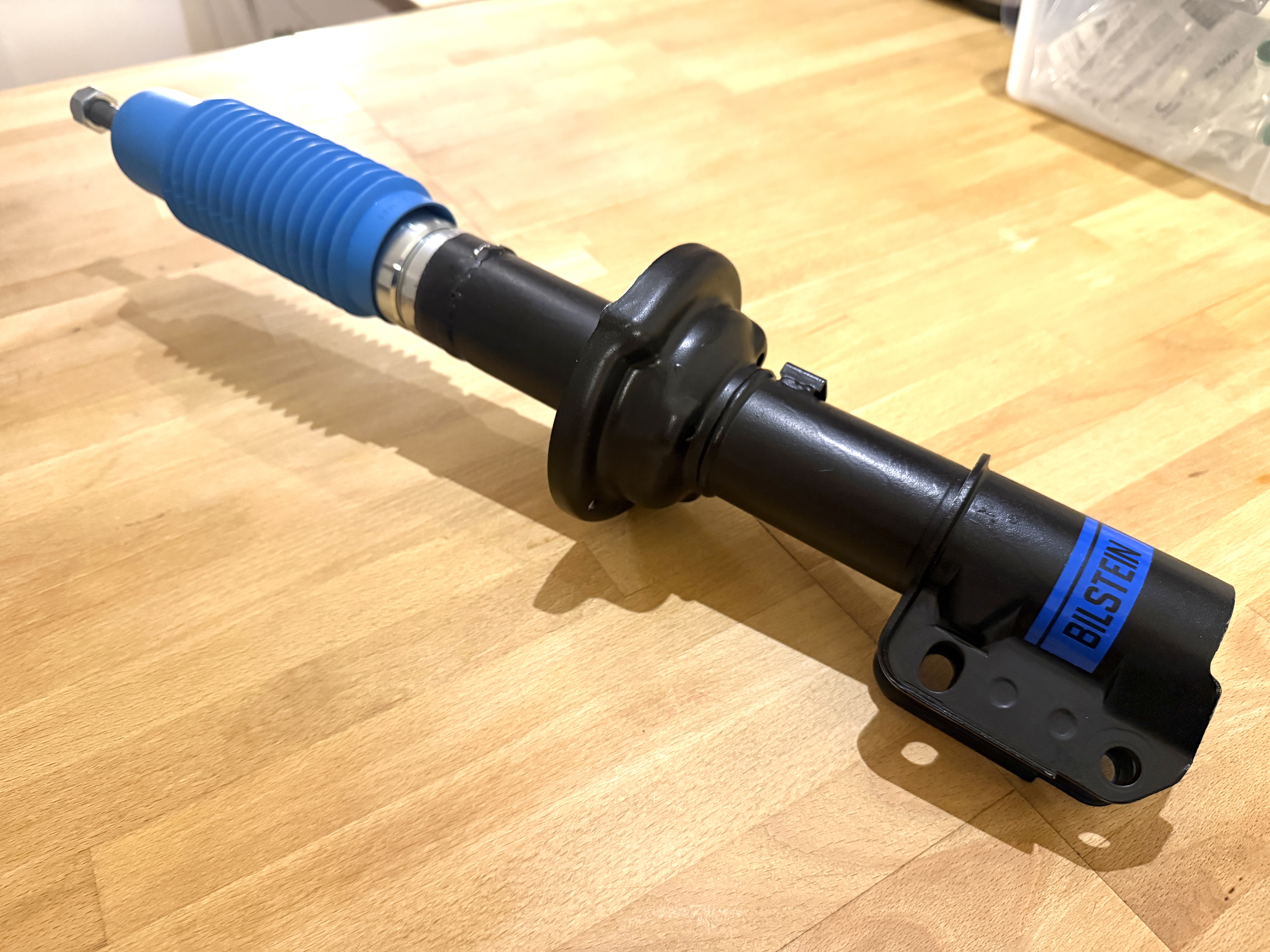

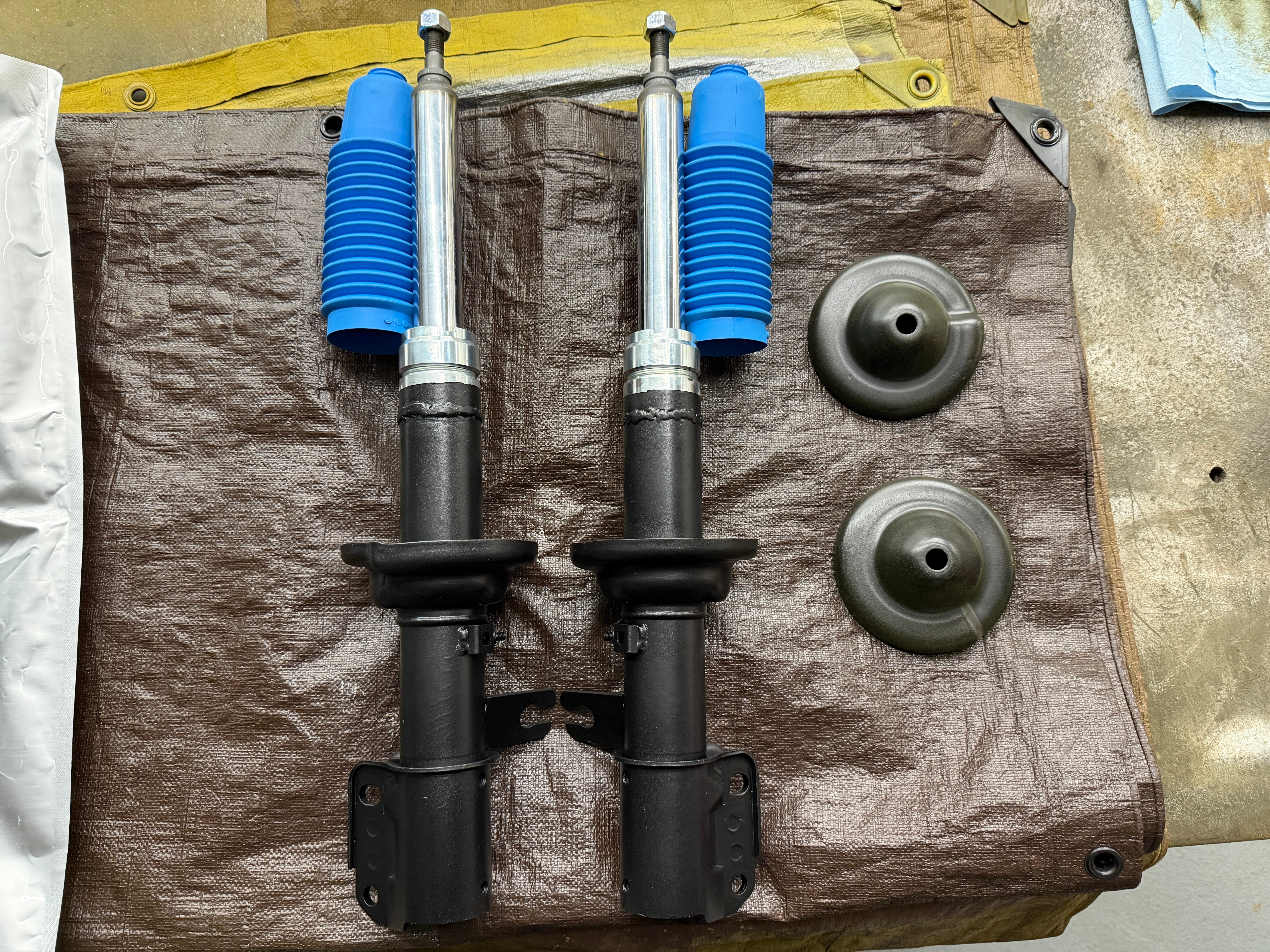

Found time to paint the struts. Im going to use some rubber shrink tube to cover the weld and the unpainted portion, and some Bilstein decals are on the way that I might add on.

spacecad3t wrote: Sun Feb 15, 2026 6:17 pm Found time to paint the struts. Im going to use some rubber shrink tube to cover the weld and the unpainted portion, and some Bilstein decals are on the way that I might add on.
Looks really nice -- great work. I wouldn't worry about the weld joints myself. Weld beads make cars faster. :)

Thanks Tom! The springs did not come out how I hoped... I should have primed them gray I think, the black kept pushing through and then it was too much paint :( so I'll be stripping those and I think powder coating them instead.
Anyone have thoughts on adding these decals? Im on the fence.
