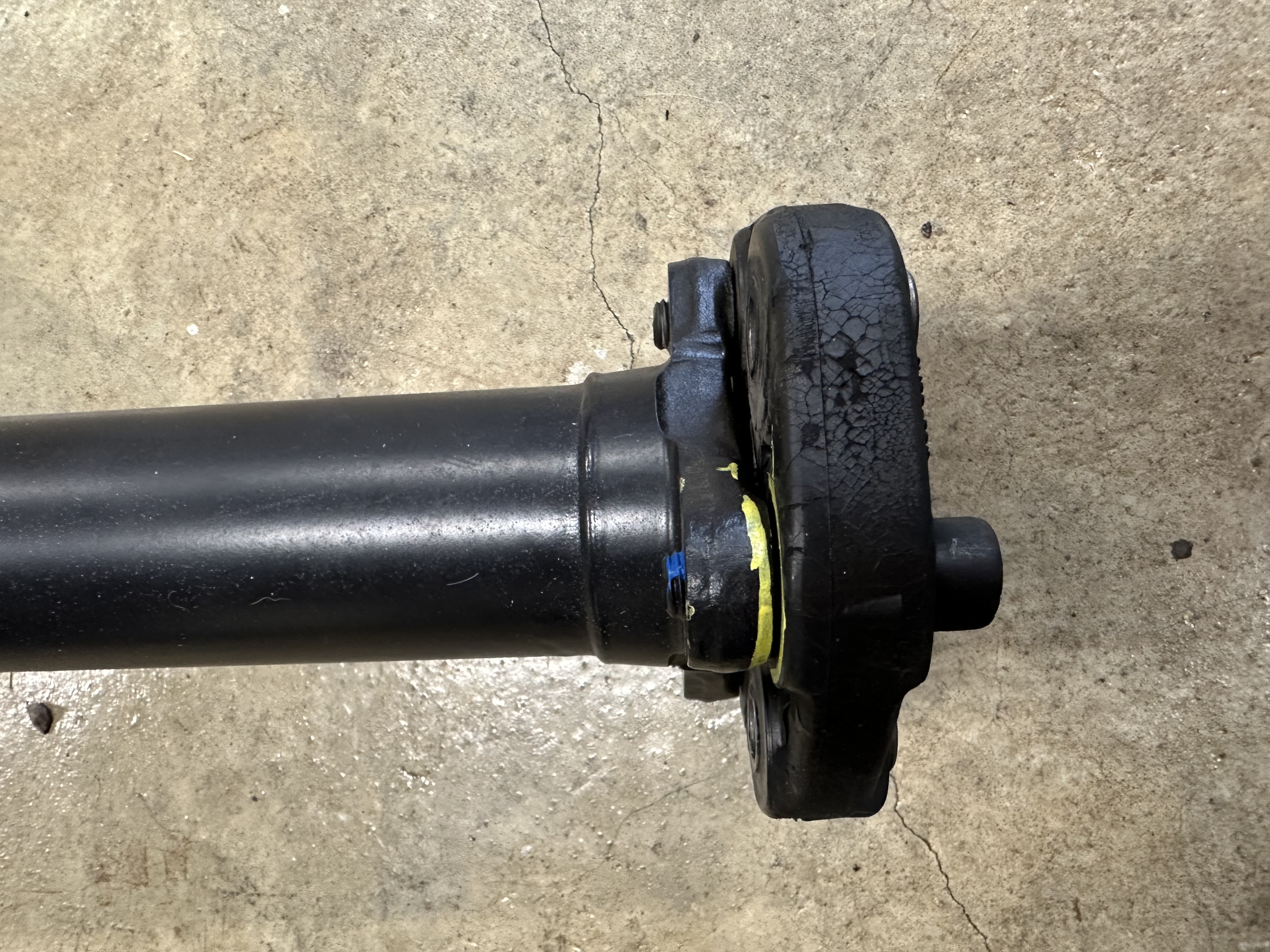

The hole in the center of the guibo is the diameter of the bearing on the driveshaft. The little pin goes inside of the bearing and is approximately the hight of the guibo’ a depth. Here are additional pictures.
If we create a dome for the shaft like your original design I believe that would work?

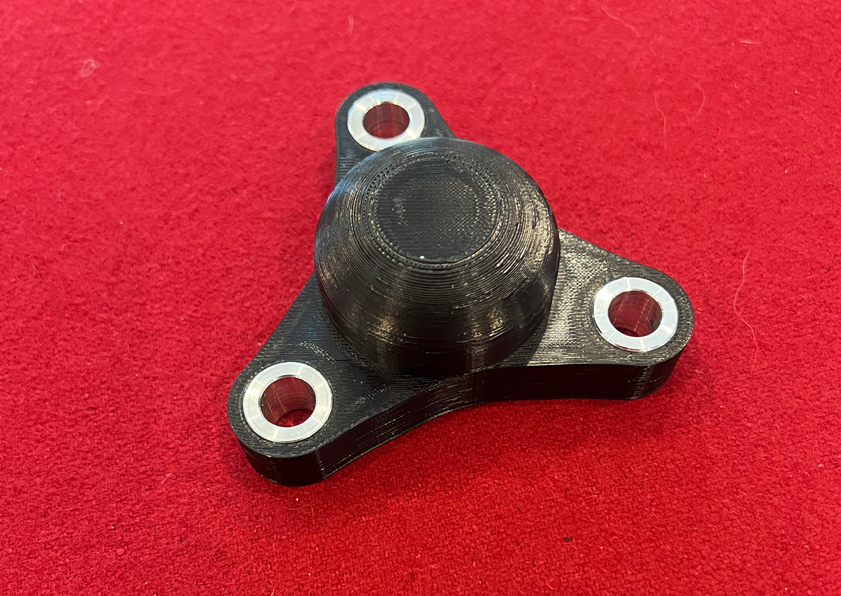

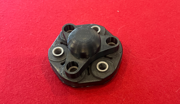

Here's a quick print of a cover that fits the flex disk. I designed it to use steel inserts, much like the flex disk, so that the bolts can be torqued to spec. While you can torque on the plastic, there's a risk of breaking it, and an even bigger risk of them coming loose as the plastic compresses over time. The inserts are about $2.50 at McMaster so will add them to my next order if this looks like a go.
I had to guestimate is how tall to make it so it clears the shaft stub sticking out. I hopefully erred on the tall side.
One thing I noticed while doing this is the shaft will not be entirely sealed off from the elements, since there is a gap between the flange and the flex plate. Same must be true of the factory configuration. But this will protect it from road debris/rocks, etc. to the same extent it was protected from the factory.
Let me know if you see any issues, otherwise I'll get the inserts so you can give it a whirl... :)

Hell of a job! I agree with the metal inserts as I will torque the bolts to an extent with the added security of locktite like it cane from the factory. That dome will be plenty to cover that little shaft also! I say full send!
Attachment point.

Finally made one with the inserts. Looking at that picture above, you may need to put washers in the recesses above the holes, so that the inserts on the cover can be torqued against metal.
