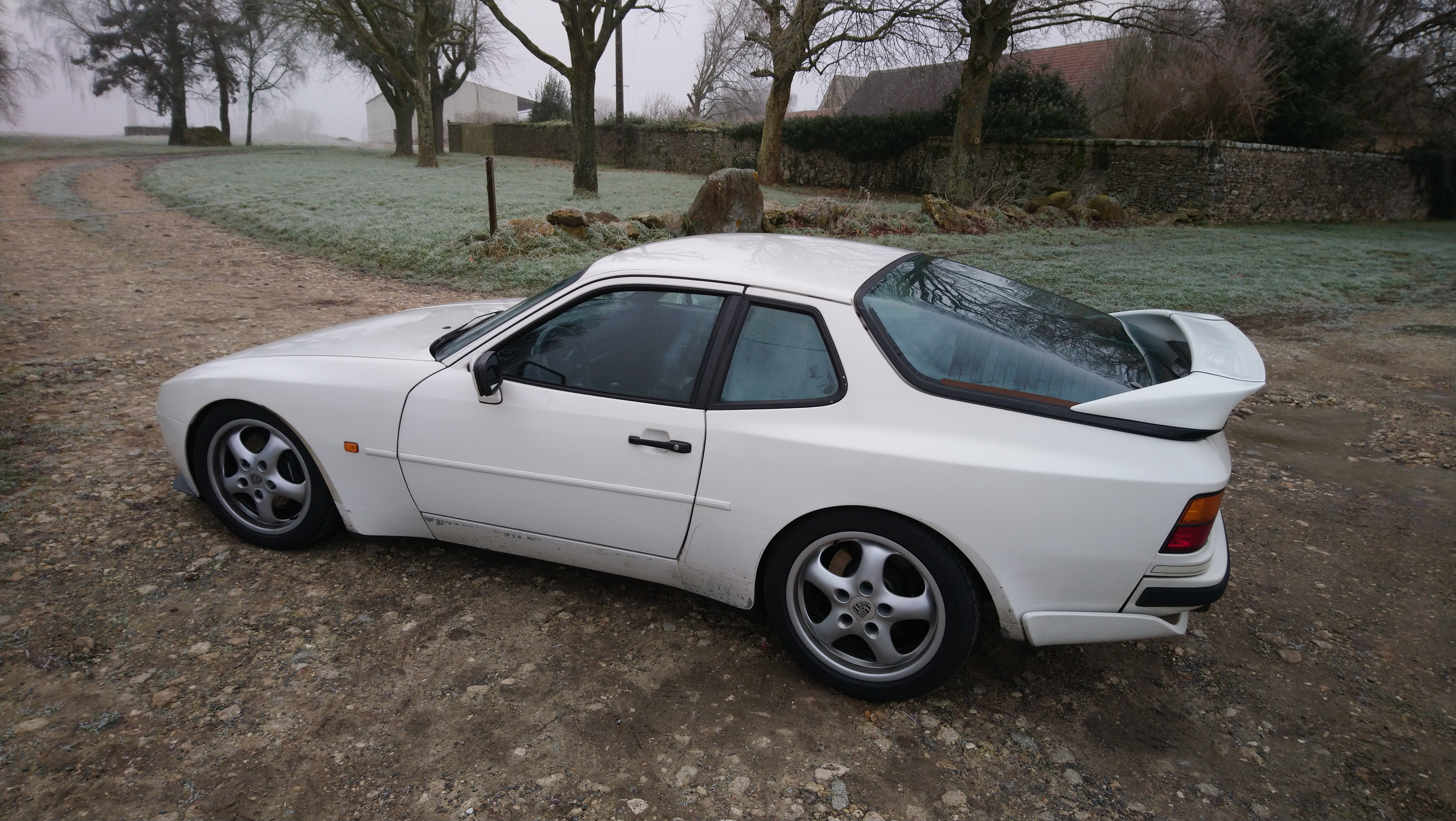

First drive of the year for the all weather warrior. I forgot the laptop and didn't do any datalogging but the engine loves such cold weather.
'90 944 turbo
