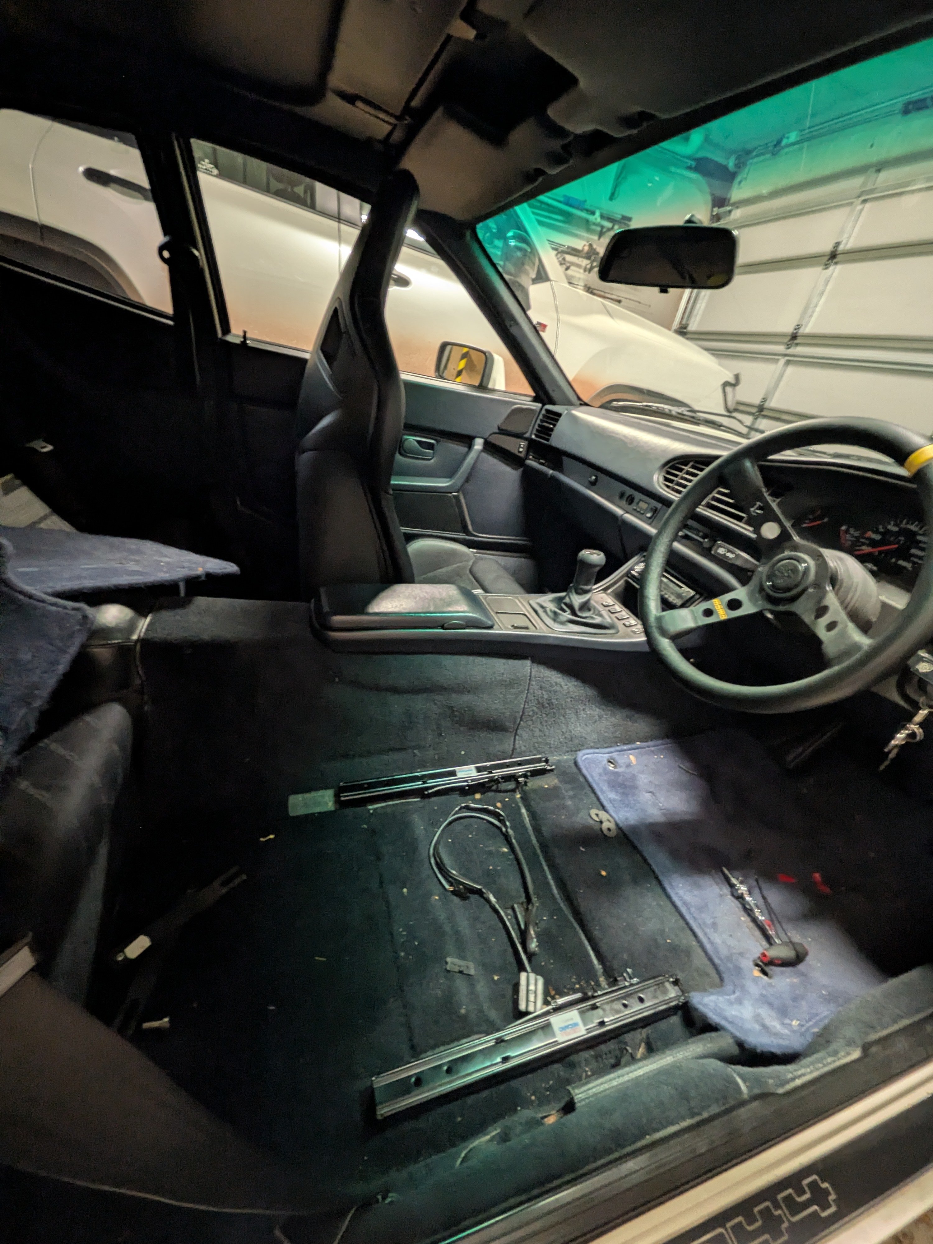

In the meantime Ive been working on the seating situation, the stock seats have been causing me endless pain as the side bolsters dig into my hips. I found some Recaro Sporster CS on sale so I finally decided to do something about it. Ive mounted them straight to rails bolted directly to the floor which has given me some much needed head and knee clearance as well (968 CS seatbelt brackets used to mount the seatbelt receiver). They dont really fit in with the blue interior but I dont think there is anything thats not custom that will.
