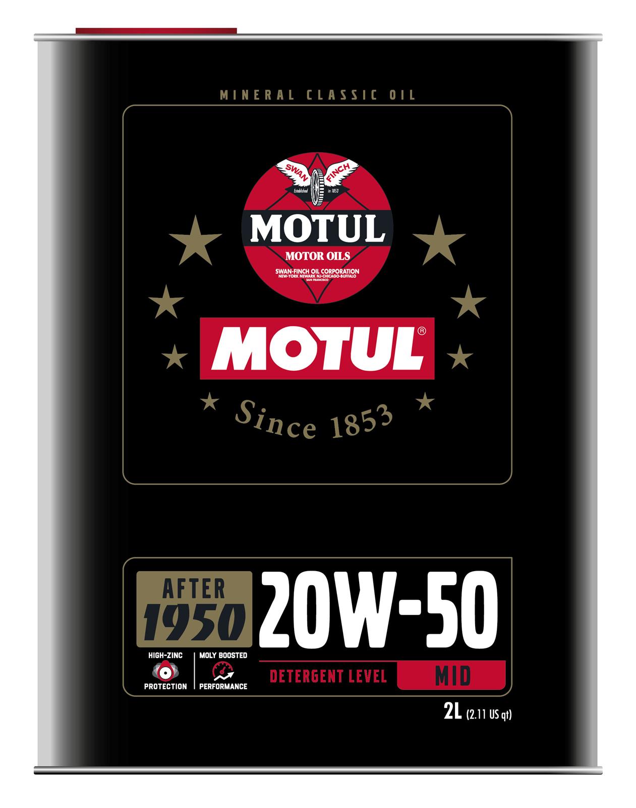

This is a timely discussion for me as it is oil change time. I've been using Castrol GTX for a long time but do occasionally get lifter tick. I lean toward convention oil just because I change it overly often and synthetic seems to produce leaks that just aren't there with convention oil... I'm thinking about trying this Motul conventional oil. Anyone try it yet?

I searched for a data sheet and came across this data
https://azupim01.motul.com/media/motulD ... 210222.pdf
Looks interesting to me. If you do use it for your next oil change, feedback would be appreciated.

I ordered it. What the heck. Will do an oil analysis with my current oil and with this Motul, and will report backzooklm1 wrote: Fri Aug 01, 2025 6:10 am I searched for a data sheet and came across this data

Just to follow up, I changed the oil this week and used the Motul 20-50 'after 50's' oil shown above. Hard to reach any conclusions without running it a while and doing an oil analysis, but I'm happy to say the lifters are quiet with this oil. They would sometimes tick with Castrol 20-50, so I was running 10-40. On that basis alone, I'm liking it. The 2 liter cans are also convenient because they add up to about 6 and 1/3 quarts, which is almost exactly what I normally add when changing the oil and filter. They also make a satisfying, old school, Wizard of Oz Tin-man oil can sound when pouring.
