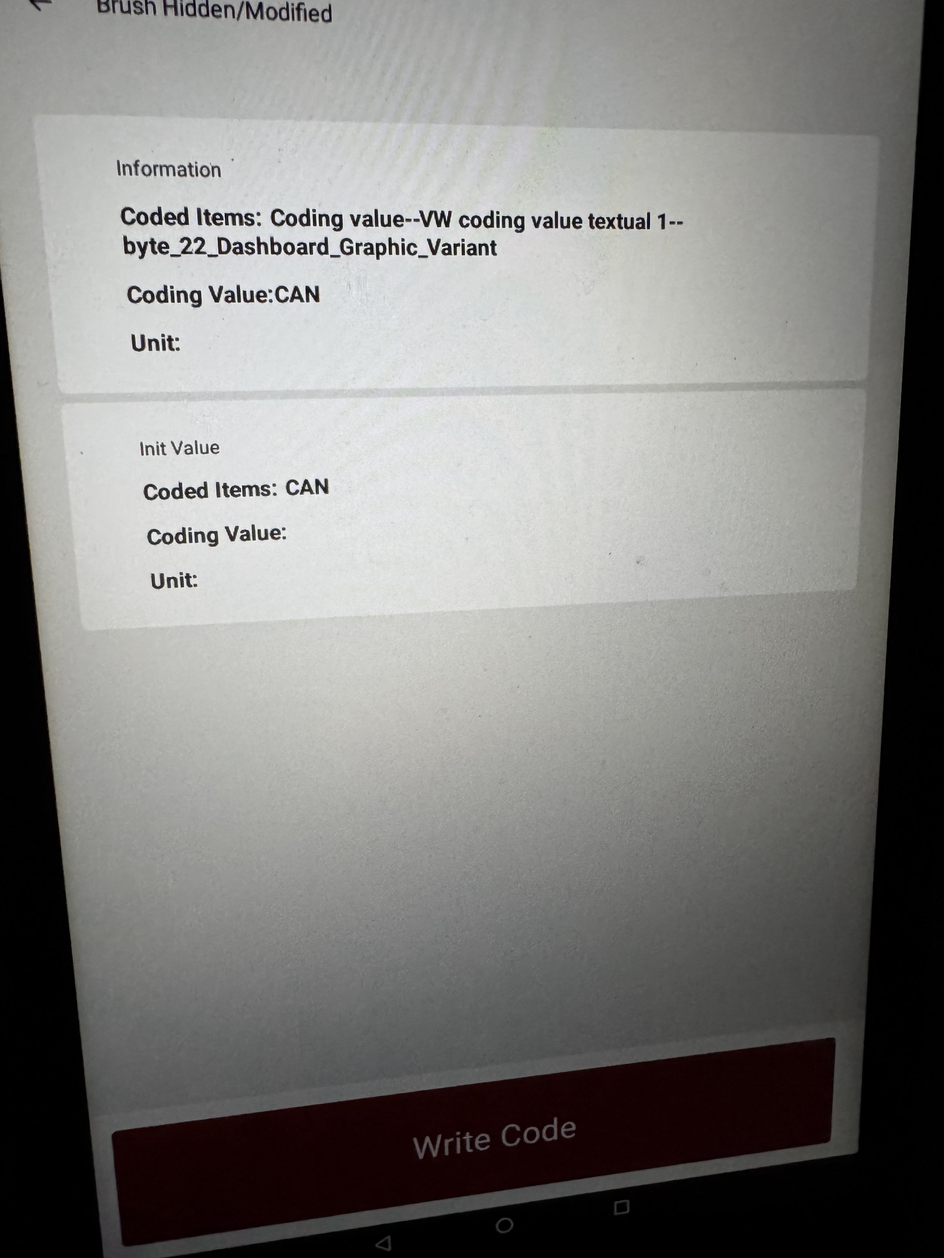

planolemans wrote: Sat Nov 30, 2024 5:40 am Has anyone used the x431 to switch the PCM output to the optical port? Any info on where the x431 PCM coding page is will be a help. Thanks in advance.
I am not sure what you are looking for but I came across this while trying to find the code to change the startup screen that displays the vehicle variant.
PCM Graphic Variant Choices.JPG (1.11 MiB) Viewed 2722 times

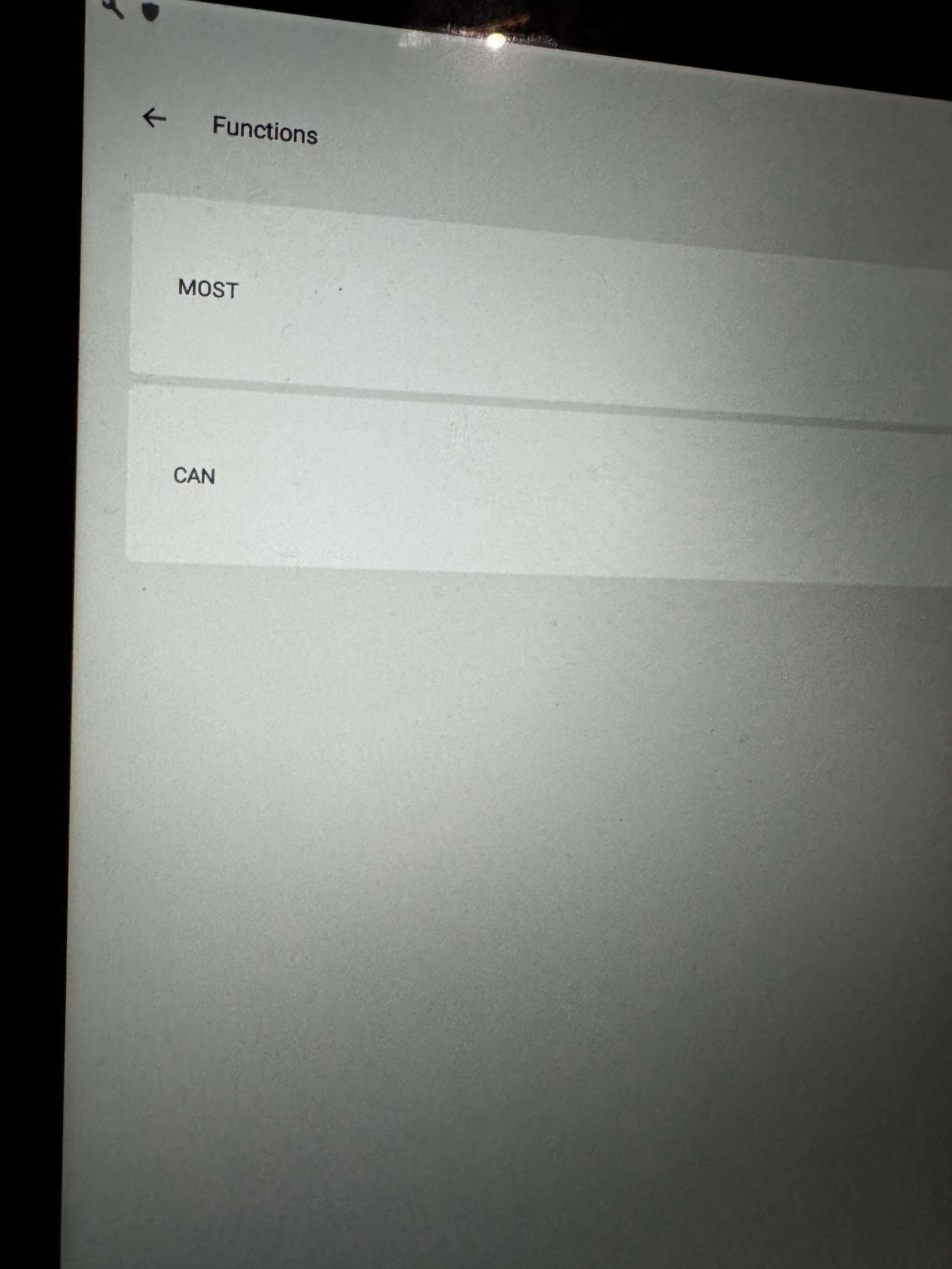

I want to use the optical output of the PCM to connect to a DSP amp. In other words to connect to the amp digitally. I think you found it, I need to use MOST. How did you get there? Thanks

Budget upgrades use the speaker level outputs, and the high-end systems are going with the MOST interface.
With SPP as the start, one must enable the MOST interface on the PCM.
(My understanding is that the Head Unit is the same, but MOST is only active from the factory on Bose or Burmester equipped cars). The optional audio systems have an external amp so the MOST interface is required.
The challenge here appears to be that there is only one product that can do this (MOST-150 to aftermarket amp interface), the NAV-TV ZEN-V. That was the case when I did my research almost 2 years back.
The NAV-TV ZEN-V is expensive and represents a grey area in the marketplace.
The above contributed to my Burmester selection.
