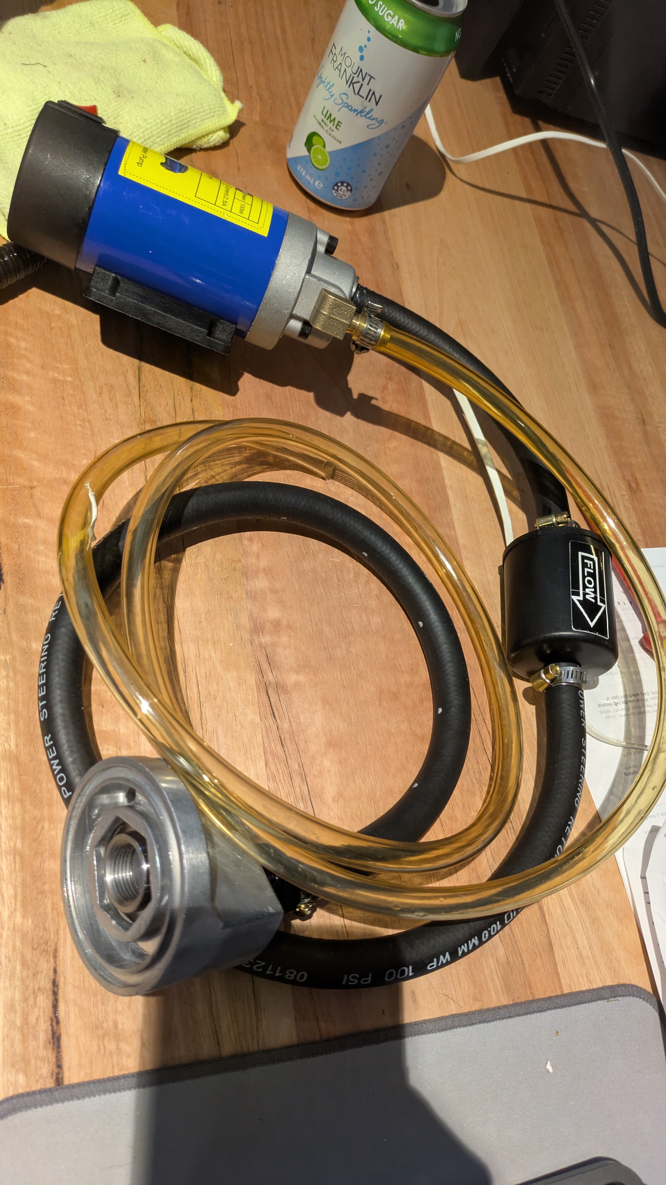

Break-in oil (Driven GP-1 20W-50) and and fittings have arrived. We're planning to circulate oil in through the filter housing and around the engine with 12V pump before priming the oil pump and turning over. Probably a bit over the top but I have a lot of money in this engine.

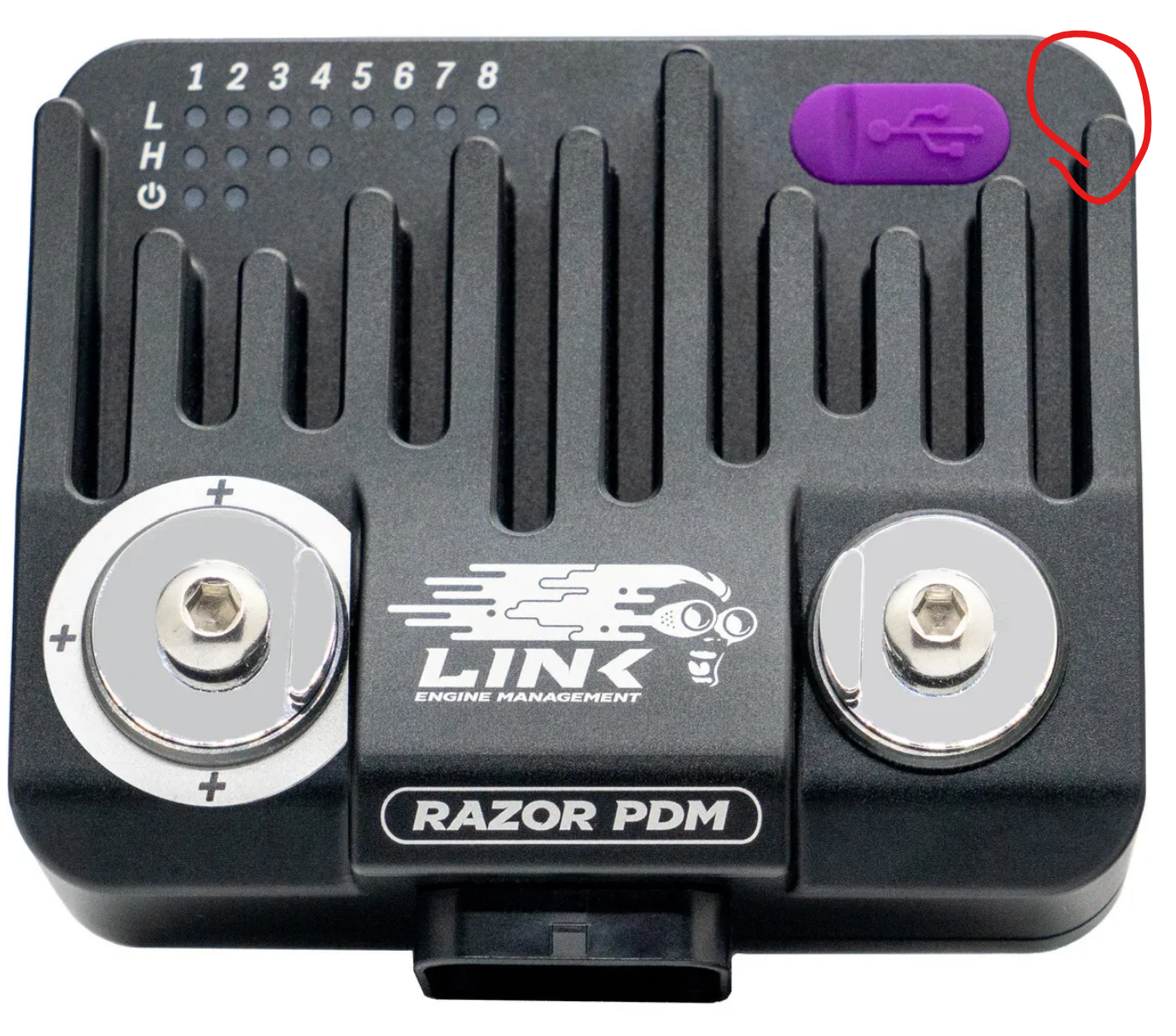

We attempted to go for a start yesterday, turned it over and started to get oil pressure but when I went to turn the fuel pump back on I couldn't get a response from the PDM. Seems like it may have gotten some stray current from when I had the exhaust welded. I'm still not quite sure how, because I disconnected the battery and the IO from the ECU and PDM but PDM has a large ground which I missed.
The PDM is on its way to Link for repair, hopefully it won't take another month to get it back.

Just heard back from Link, the PDM wasn't damaged internally but because it can be powered on through the USB port, when it broke it was preventing the IGN input from turning it on. That explains why the fuel pump would run intermittently.
Its probably my fault it got damaged because I was trying to squeeze the USB cable in behind the stock DME mounting bracket but all repairs were covered under warranty by Link, great service!

Ill do something like that eventually, the PDM has a fairly average design where the USB is on the front, I tried a right angle USB cable but it clashed slightly with the heatsink fin and must be what put the extra stain on it. Between the ECU and the PDM I have USB Cables everywhere!
I should only really need to connect to it to force a couple of inputs off and on, once its tuned the config shouldnt need too much tweaking. Errors and running data all go back to the ECU for logging over CAN
