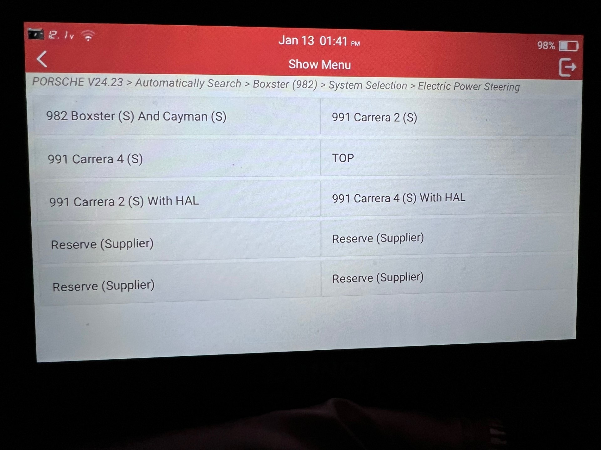

J-Dub wrote: Tue Sep 26, 2023 8:17 am @arne2 In the 981 forums I see that the Electronic Power Steering profile is adjustable and people have been switching to the GT3 profile and report to like the new steering feel. On my 718(982) chassis I have not yet found where this is adjustable. I am simply wondering if this is something you have found or do you know if it is not adjustable on the 718?
Thank you,
Jeremy
I saw that post as well. Attached are the power steering profiles that were on my 2017 Boxster S. However, no profile for a GT3.
Power Steering Coding.jpg (456.7 KiB) Viewed 1791 times
