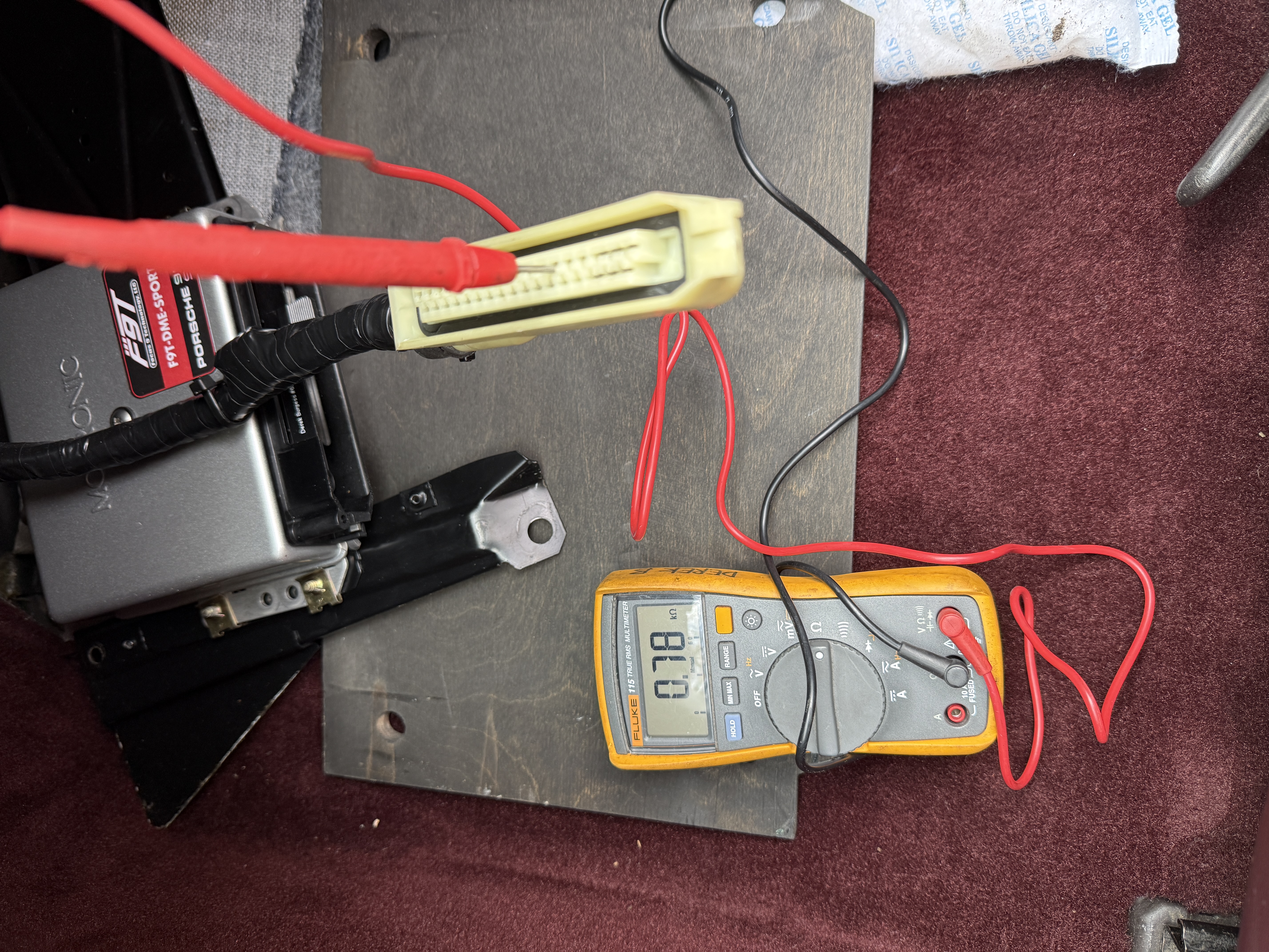

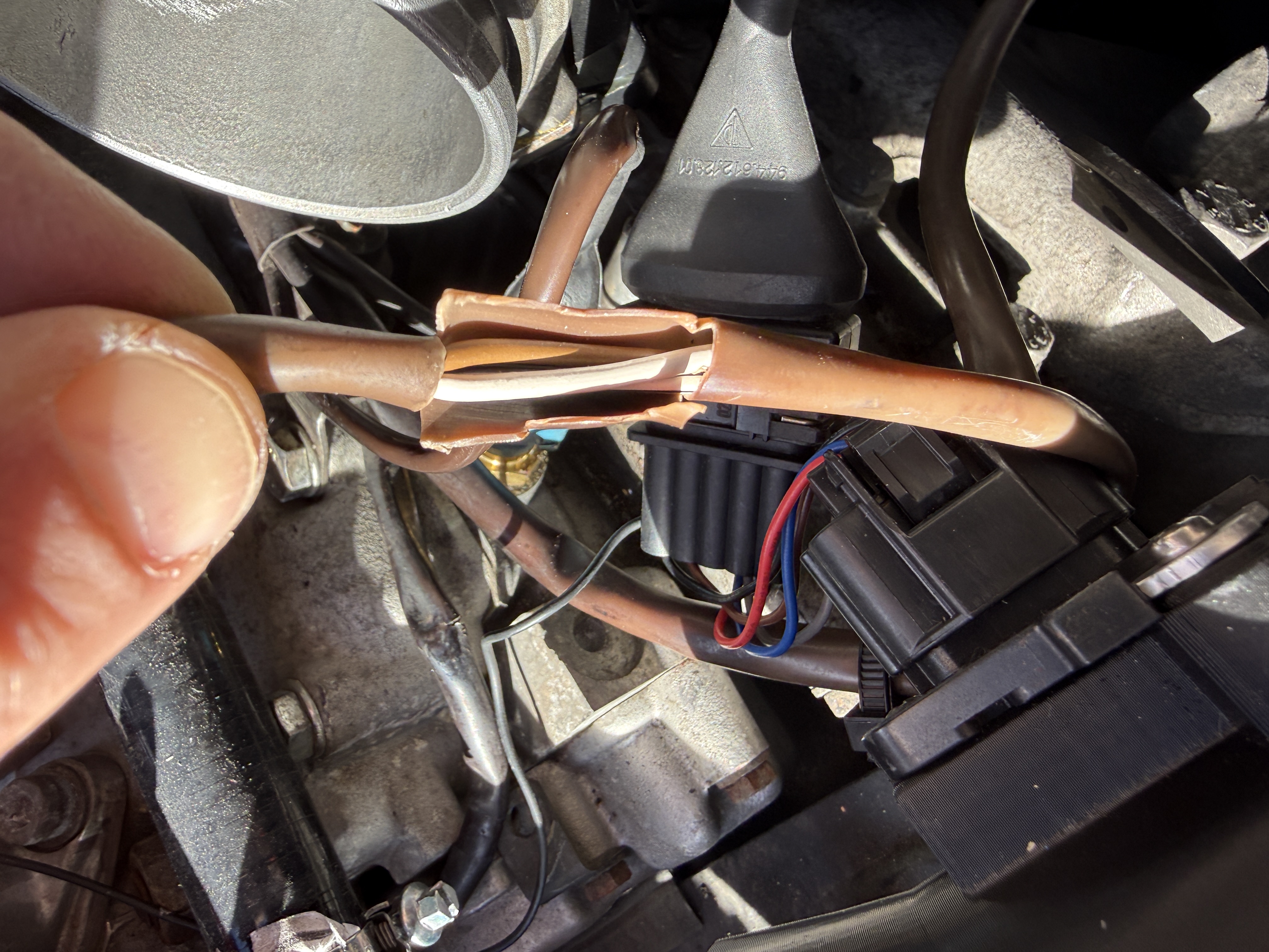

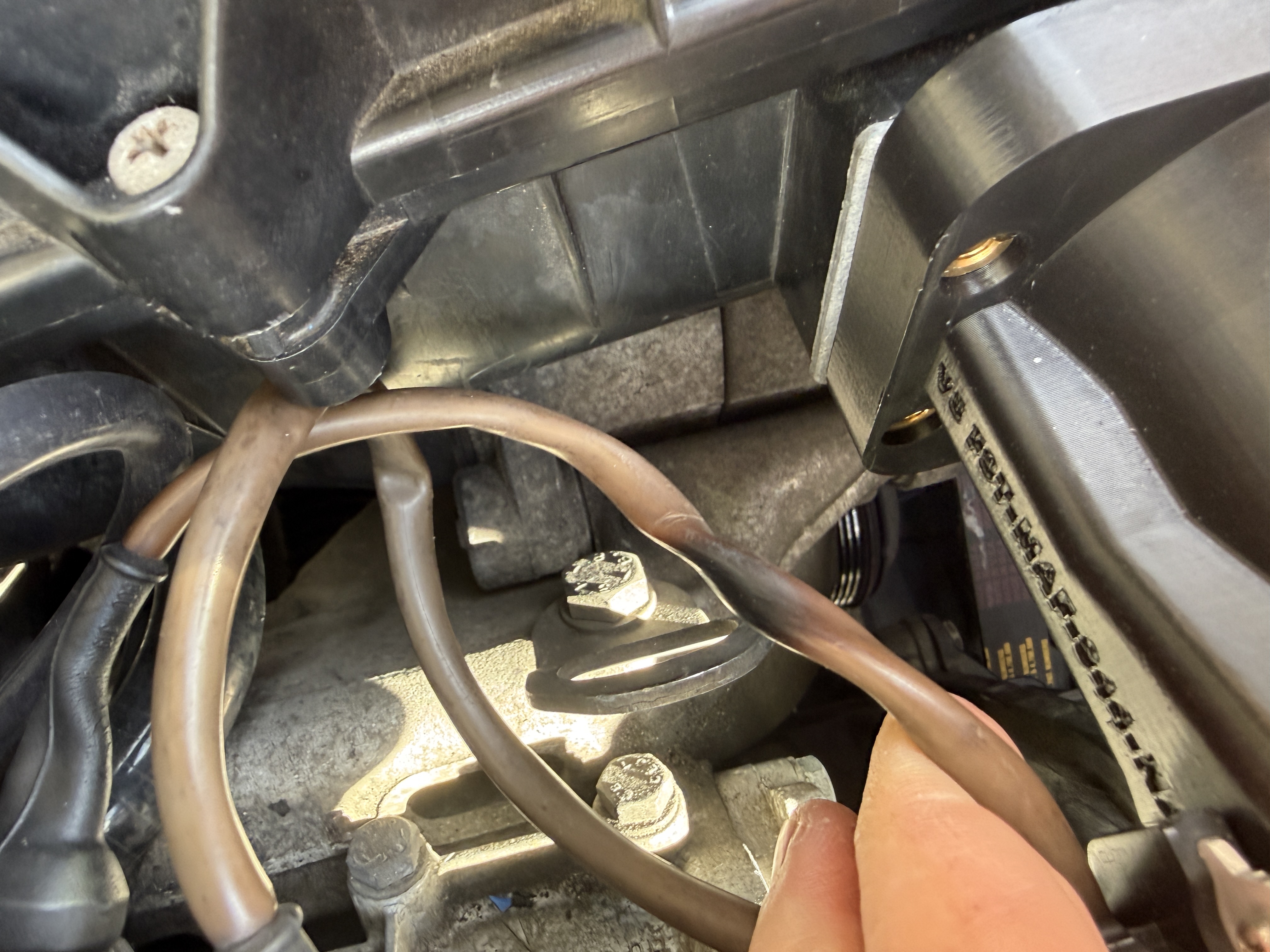

Tom wrote: Sat Nov 15, 2025 11:05 am I think the temp sensor is 'close enough' since the coolant is likely hotter than the outside of the motor where you are pointing the gun. I see 850 ohms which roughly equates to maybe 140F. Even if the reading were actually off by 40F, I really doubt that could cause your issue.
Kind of a hack suggestion, but I might be inclined to seal off that butterfly-to-bore gap (packing tape?) to see if that's where the air is getting by at idle. The plate looks replaced and there is some curious scratching near the bypass port -- all of which makes me suspicious of that throttle body...
For what its worth, I realized I left out the photos from the DME testing.
This is where I got 0.75 k-ohms, sorry, it was the first value I saw. Then 0.78 and then my videos of 0.85
Also, I saw this burn mark on my TPS pigtail, so I cut it back. Wires look perfect. I imagine the rest of the harness cant be much different, I haven't seen any other signs of serious wiring decay, even the grounds were not to bad.
