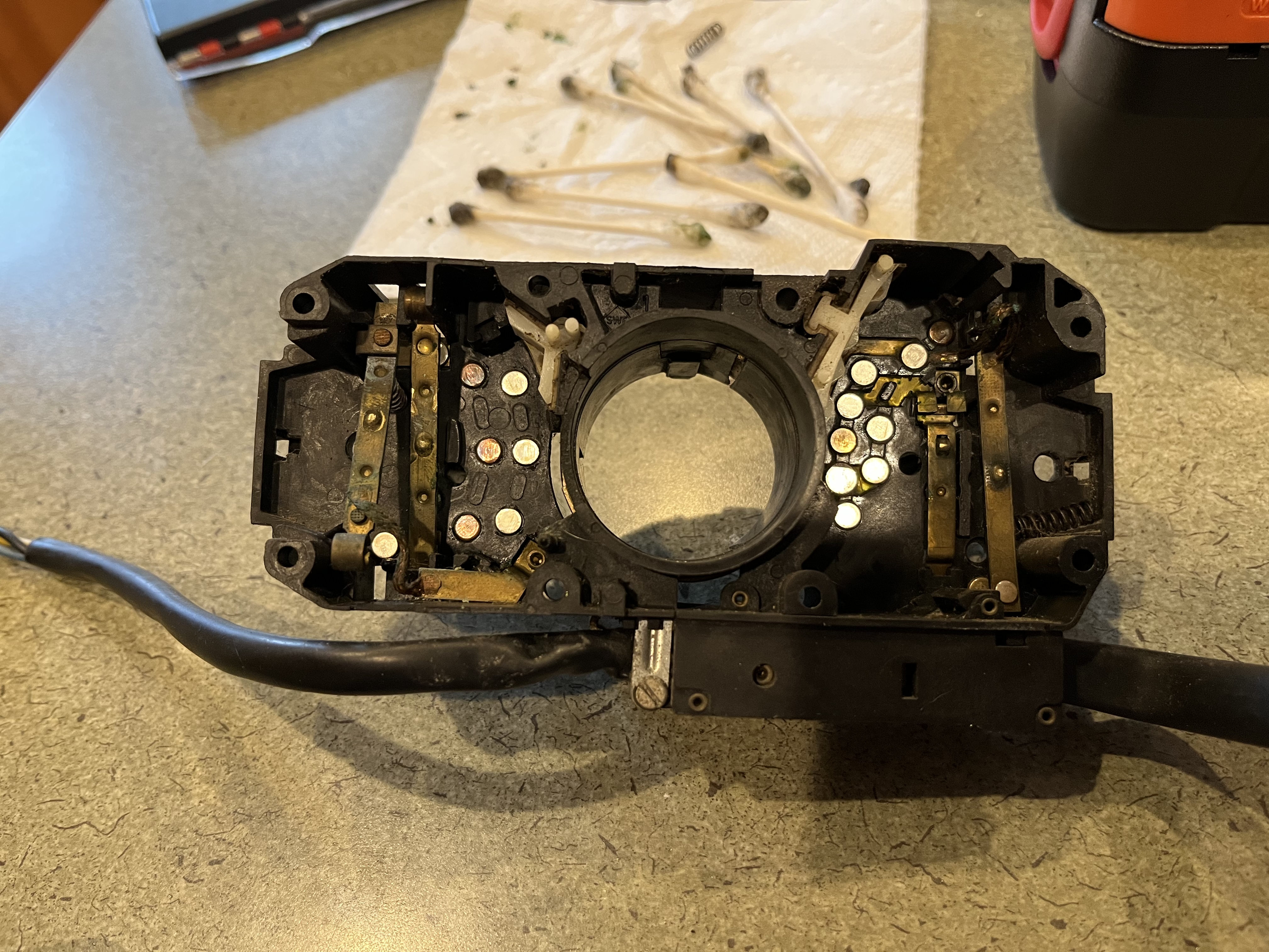

Anyway, I pulled the combo switch off my car and opened it up. Lots of dried up grease on the contacts. I used the flat top screws to put it back together. They do stick out a bit so I just took an xacto knife and cut reliefs in the little plastic liner inside the trim cover and it worked just fine still.
Here’s what it looked like when I popped it open at first:
This is after cleaning everything up:

Update on this, the turn signals work beautifully now after giving them a good cleaning! ;)
