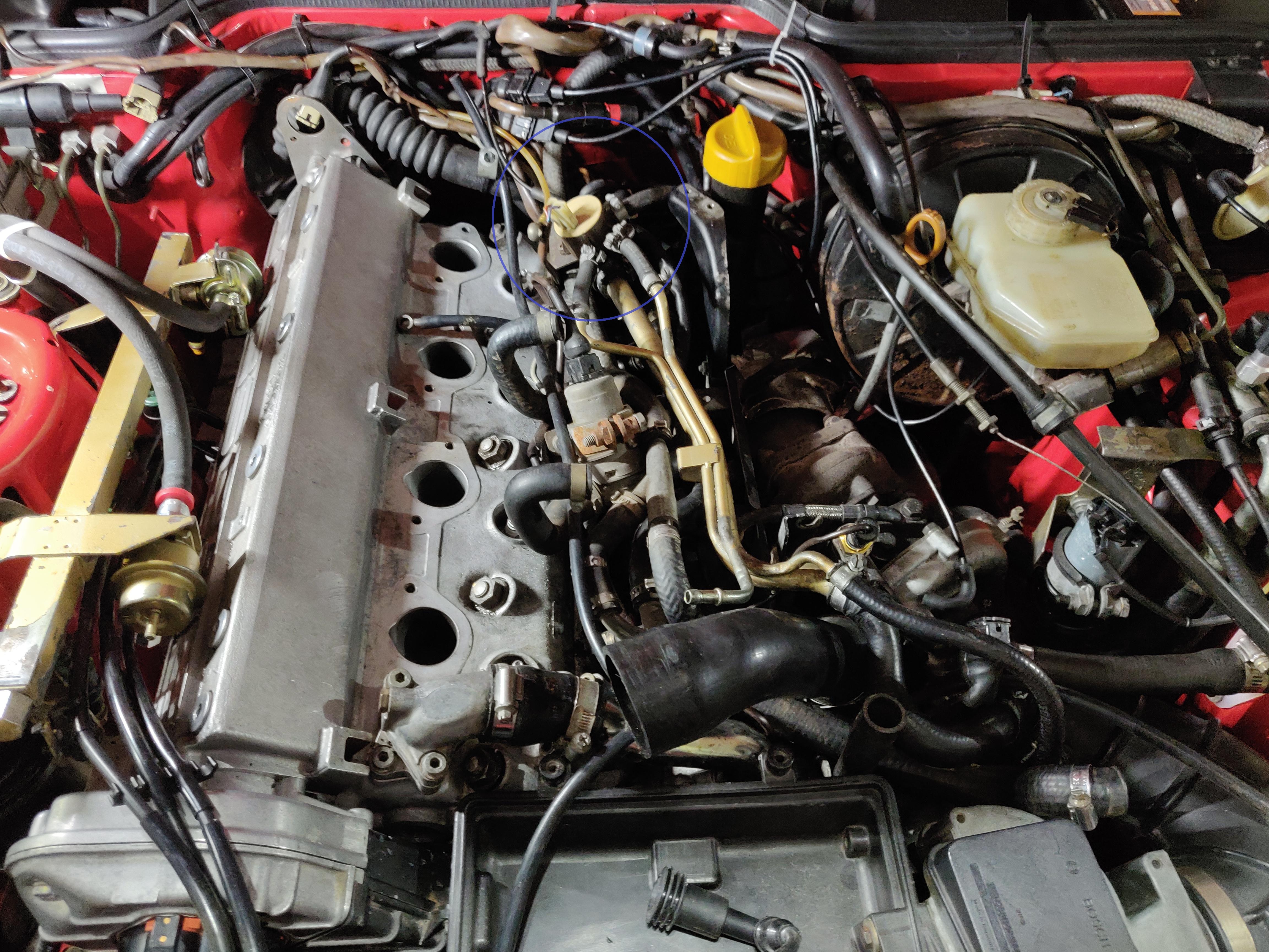

Hi all, thanks for all the comments. I ended up connecting the system and found a few leaks. This pic is not of my car, but helps explain the issue. I noticed that the hoses going to this yellow part circled in blue were leaking at the joints. Also, it seems like the cap itself is leaking around the edges. I did some research but could not figure out what this piece is for?
Does anyone know if the seal under the yellow cap is replaceable? Also, are the hoses connecting to it (specifically those towards the bottom part of the blue circle) available for replacement (mine are nylon)? Lastly, can those hoses be replaced without removing the intake manifold?

That's the cycling valve (aka the stock boost controller valve). I've never heard of anyone resealing one, though that does not mean it's impossible necessarily. A lot of people remove them to install manual boost controllers, so you can find replacements on eBay, etc. They are still available new, but silly explensive.
https://www.paragon-products.com/Vacuum ... 117.01.htm
The hoses are available from Porsche, though there is nothing all that special about them, so a rubber or silicon hose of the right diameter is fine. The ports for the hoses LOVE to snap off when you try to remove the old hoses. So much so, that I don't even try to remove the old hose, but instead cut them off with a razor blade.
Some people have claimed to replace them with the intake still installed, but to me and most normal mortals, it is a virtual impossibility. Certainly much easier just to pull the intake...
