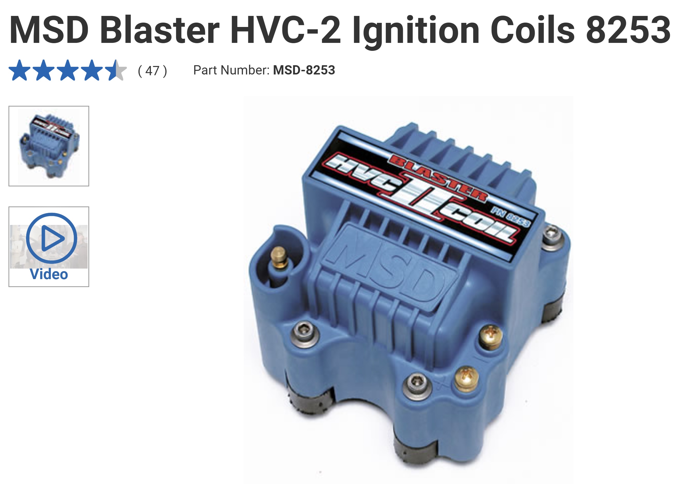

If you have the round canister Blaster-2 type coil that fits a factory coil wire, I doubt that is posing any significant threat to you DME. My comment was really about the bigger coils, like the one I use (pictured below). That said, if yours is arcing from the case, that means something is wrong with it and it should be replaced. Personally, I'd replace it with a Bosch original. I use the high-output MSD parts, because I was previously running a ton of boost with water injection, etc. and putting a very heavy load on the spark. But I can say from first-hand experience that the MSD stuff just isn't as reliable as the factory parts. And, if the factory ignition is in good working order, I doubt you'd see any measurable gains using the Blaster 2 over the factory coil, assuming your car is a typical of the breed. :)
