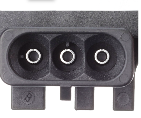

eBay item number 180857685098 will work for you.

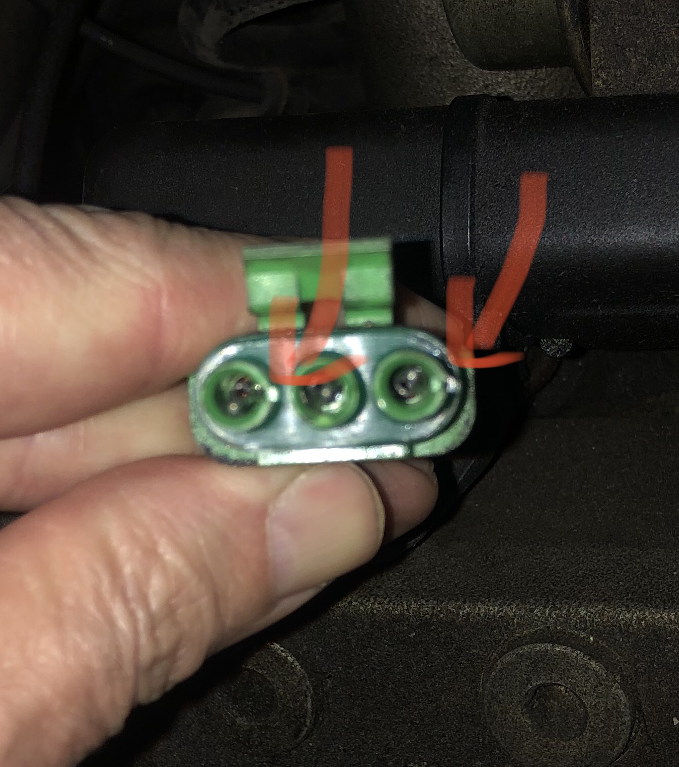

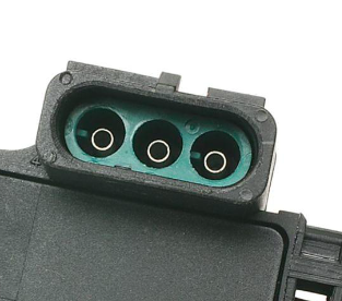

Thanks.. though I'd like to find it in Canada first. Looks like any of the off-brands will work as they don't have the tabs like the OEM does. Odd that the A-Tune plug has the slots for the 1 or 2 bar OEM (on the sides) but not the 3 bar OEM
Delphi OEM 3 bar part
Screen Shot 2024-02-04 at 9.15.42 PM.png (282.36 KiB) Viewed 676 times
Original LR (Rogue) A-Tune plug with slots on the side
Which fit ACDelco 1 or 2 bar part:
Screen Shot 2024-02-04 at 8.31.59 PM.png (111.92 KiB) Viewed 676 times

Thanks Chris... does look like a good USA made one for a good price... I was able to get a Walker replacement quick... so far seems to be doing the trick.

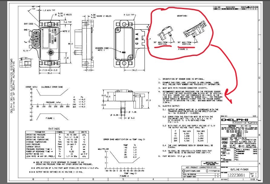

Day two: problem hasn't returned. Looks like the MAP might be it.
Now.. I found this technical drawing that suggests MAP sensors should be mounted "pointing down" so that any moisture in the line doesn't find its way to the sensor chip.
Is this how factory applications are mounted? If so, the suggested mount for A-Tune MAP sensor--hanging off the wires on the firewall--would be prone to issues as the hose nipple is horizontal
