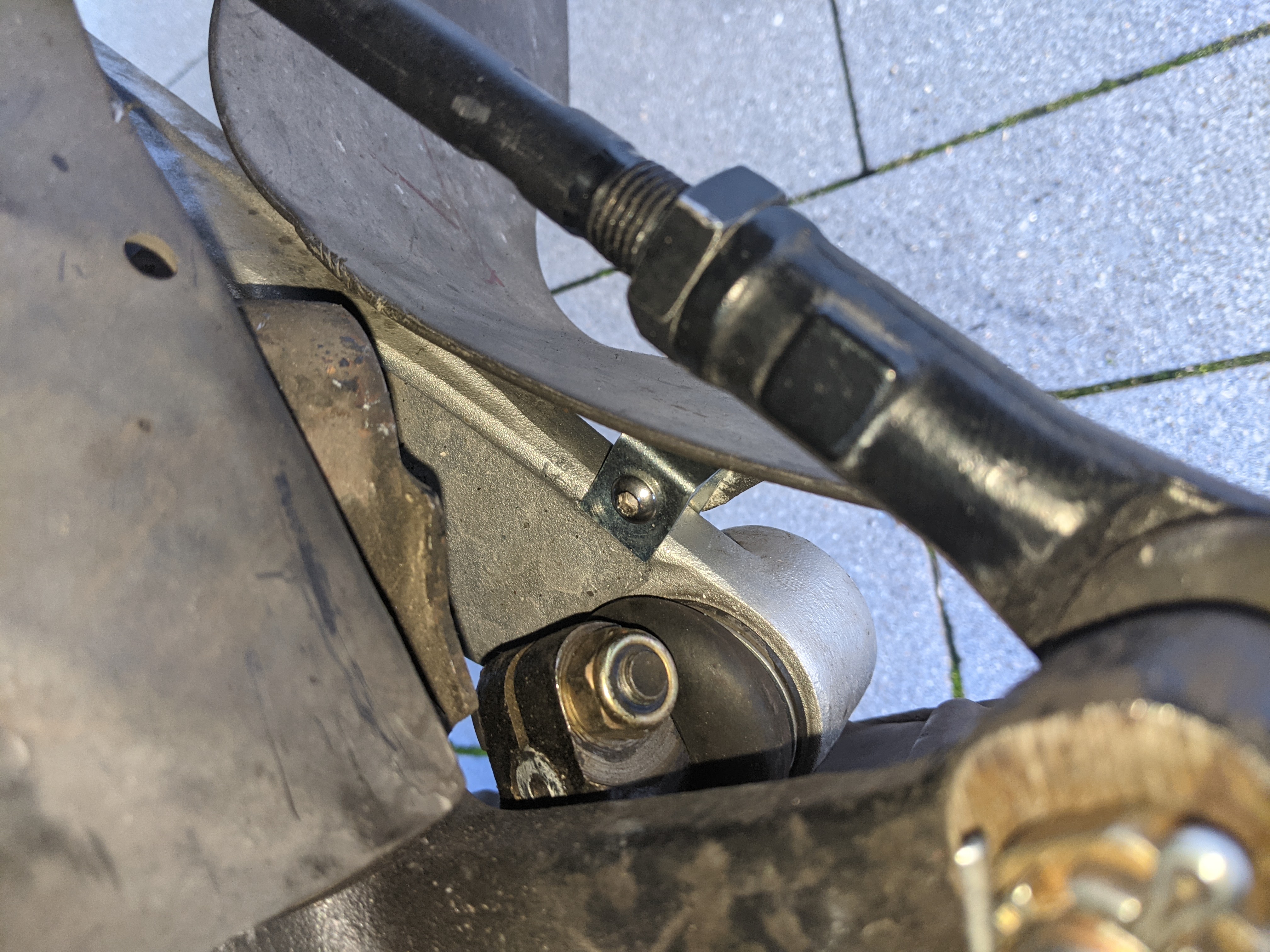

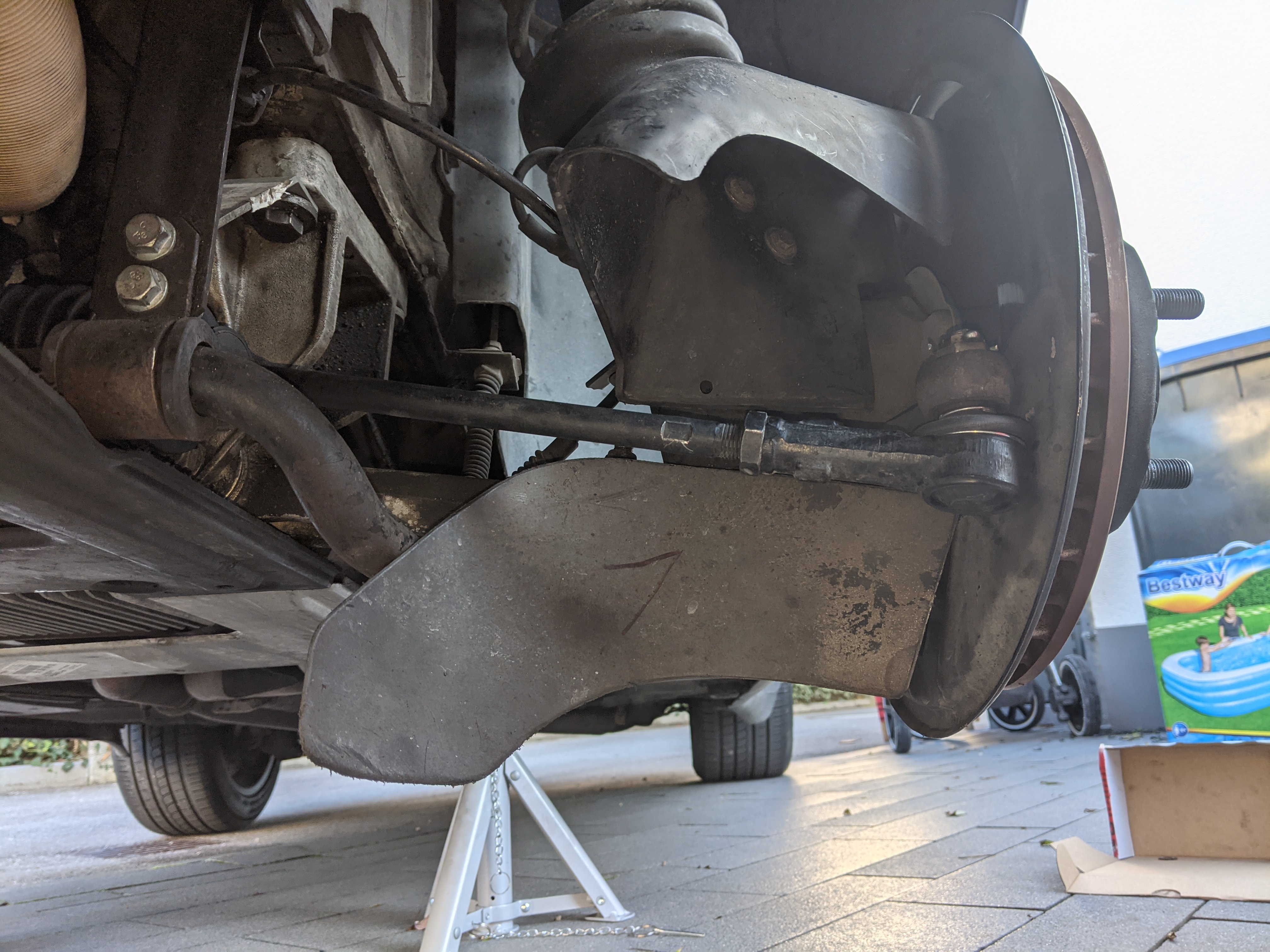

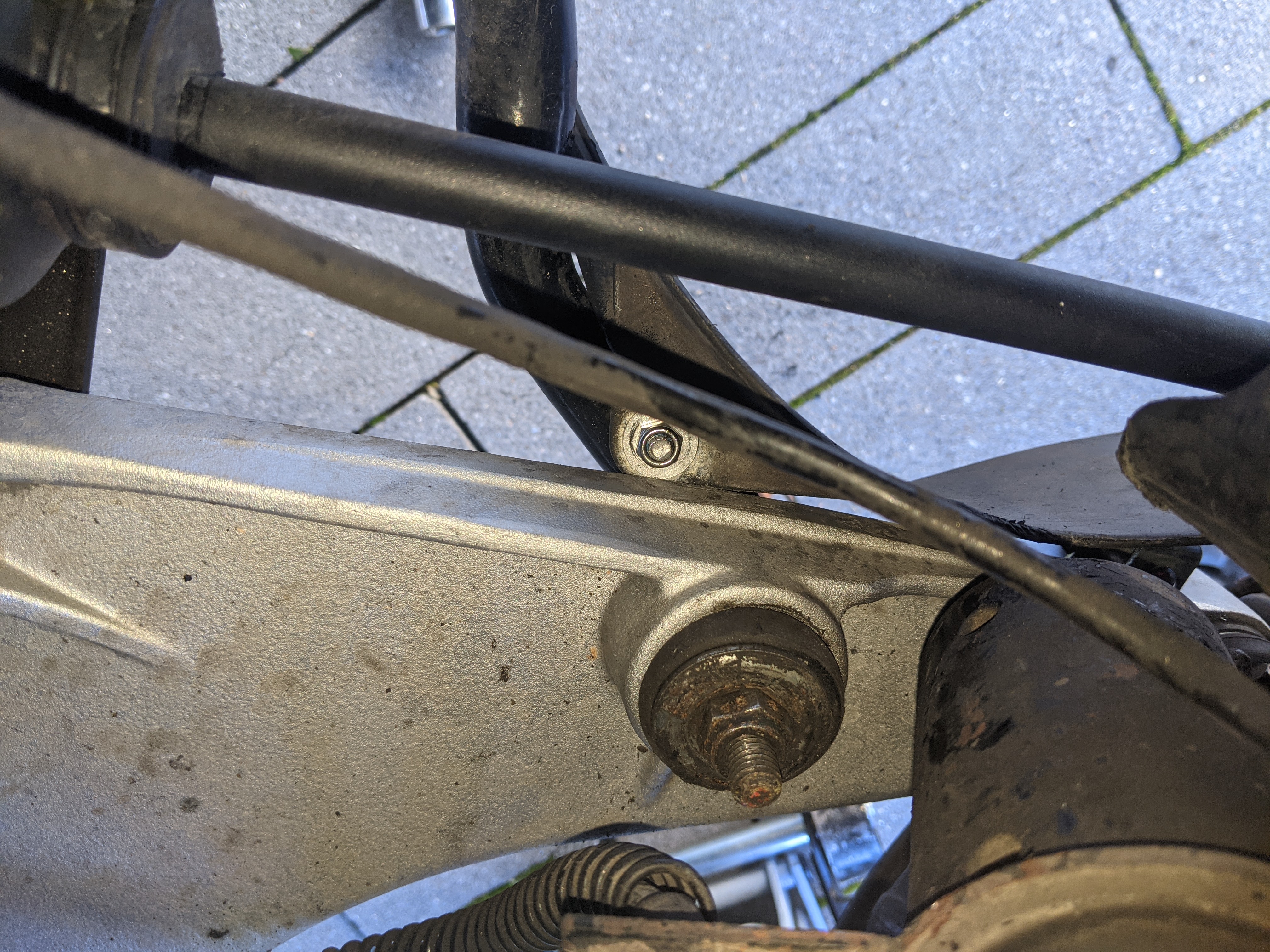

Sorry for taking some time. if you want to buy the adapters, pleas kontakt Shark-Motorsport. He also has carbon replacements for the NLA upper deflectors. Here are some pictures in the car.

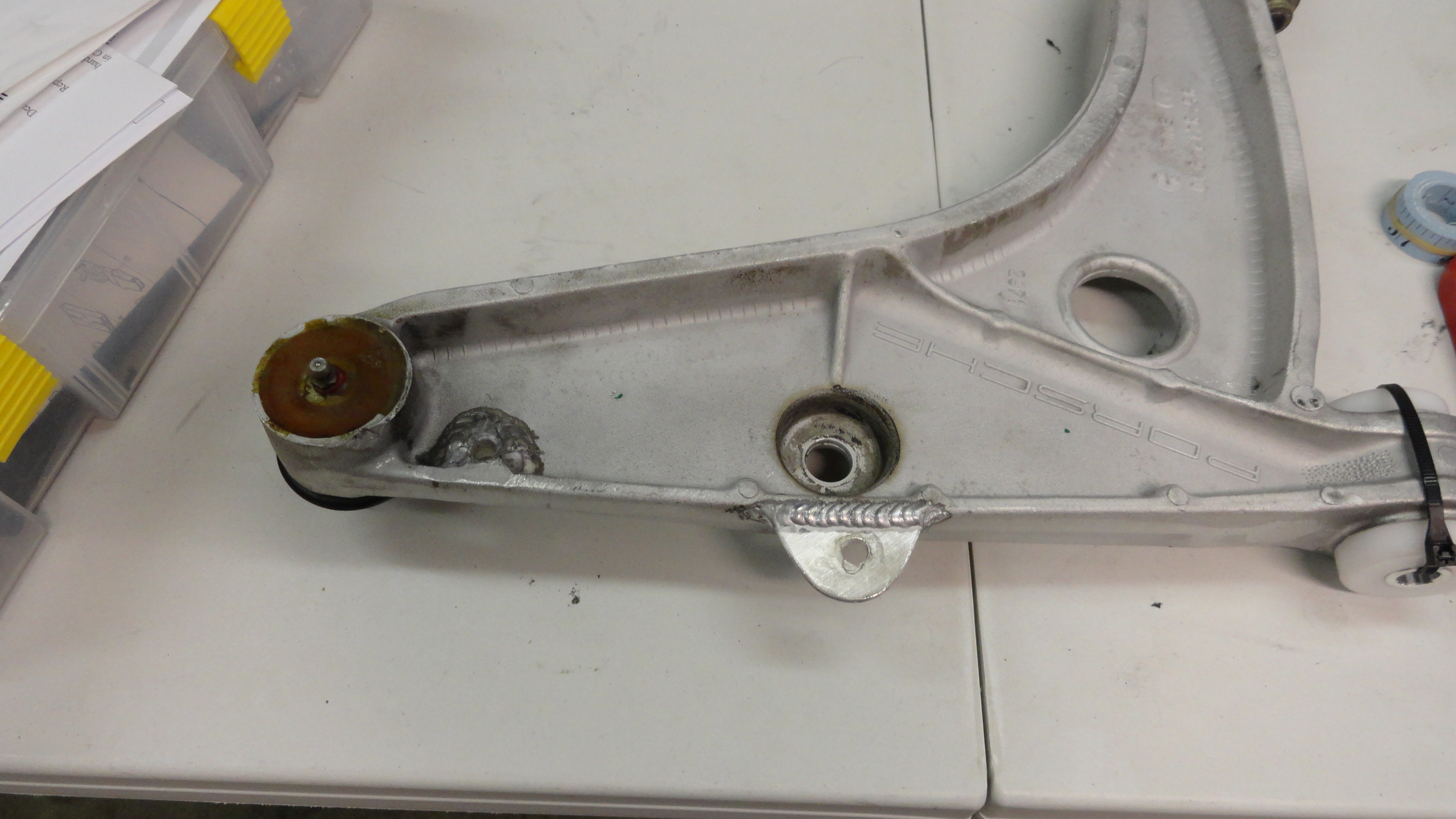

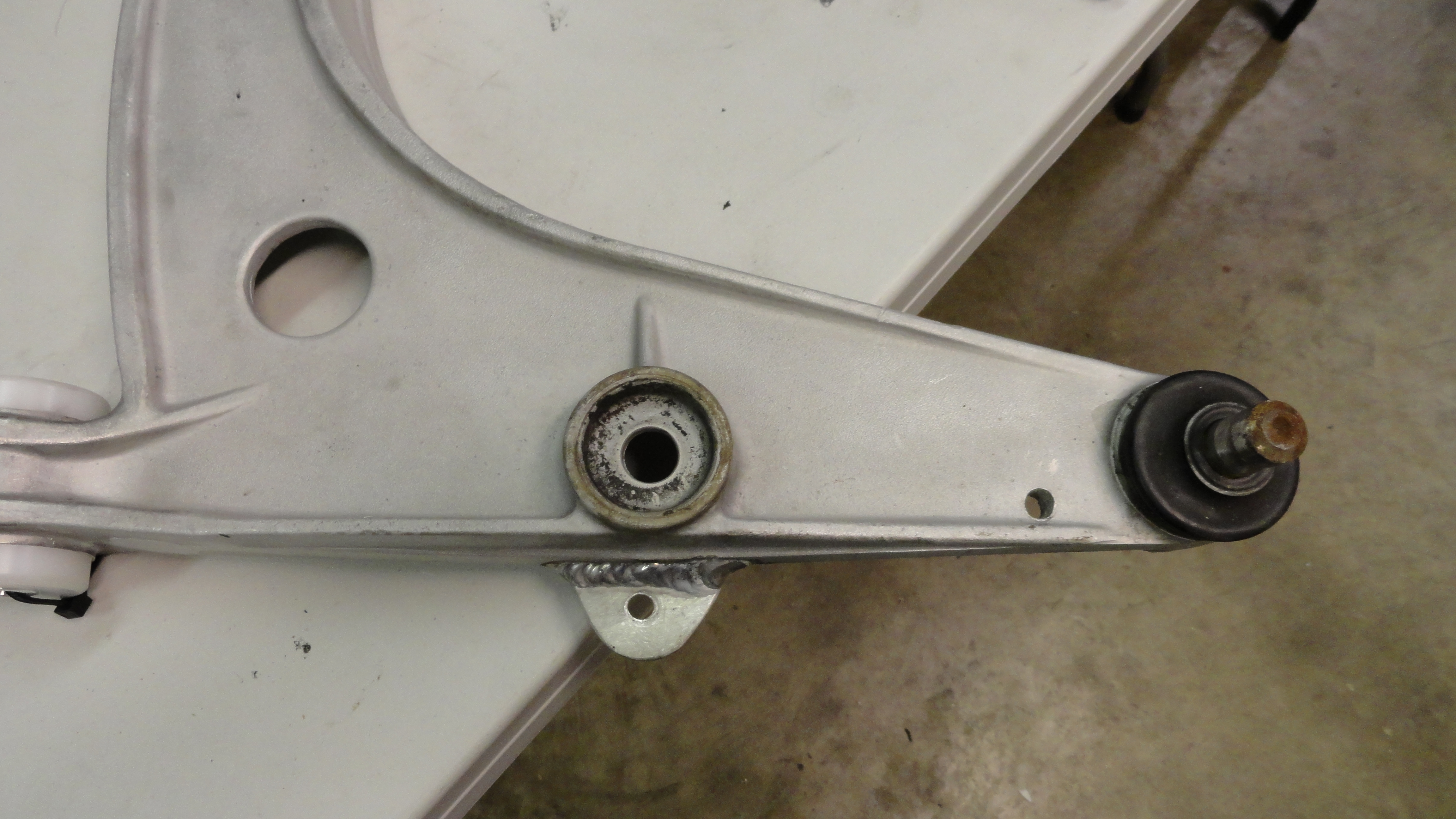

I had tabs welded to the arms, and drilled one hole in the arm.
pedros951
Posts: 5
Joined: Wed Jan 24, 2024 5:37 am
Cruise98 wrote: Wed Mar 20, 2024 6:07 am DSC05438.JPGDSC05437.JPG
thank you! perfect!
