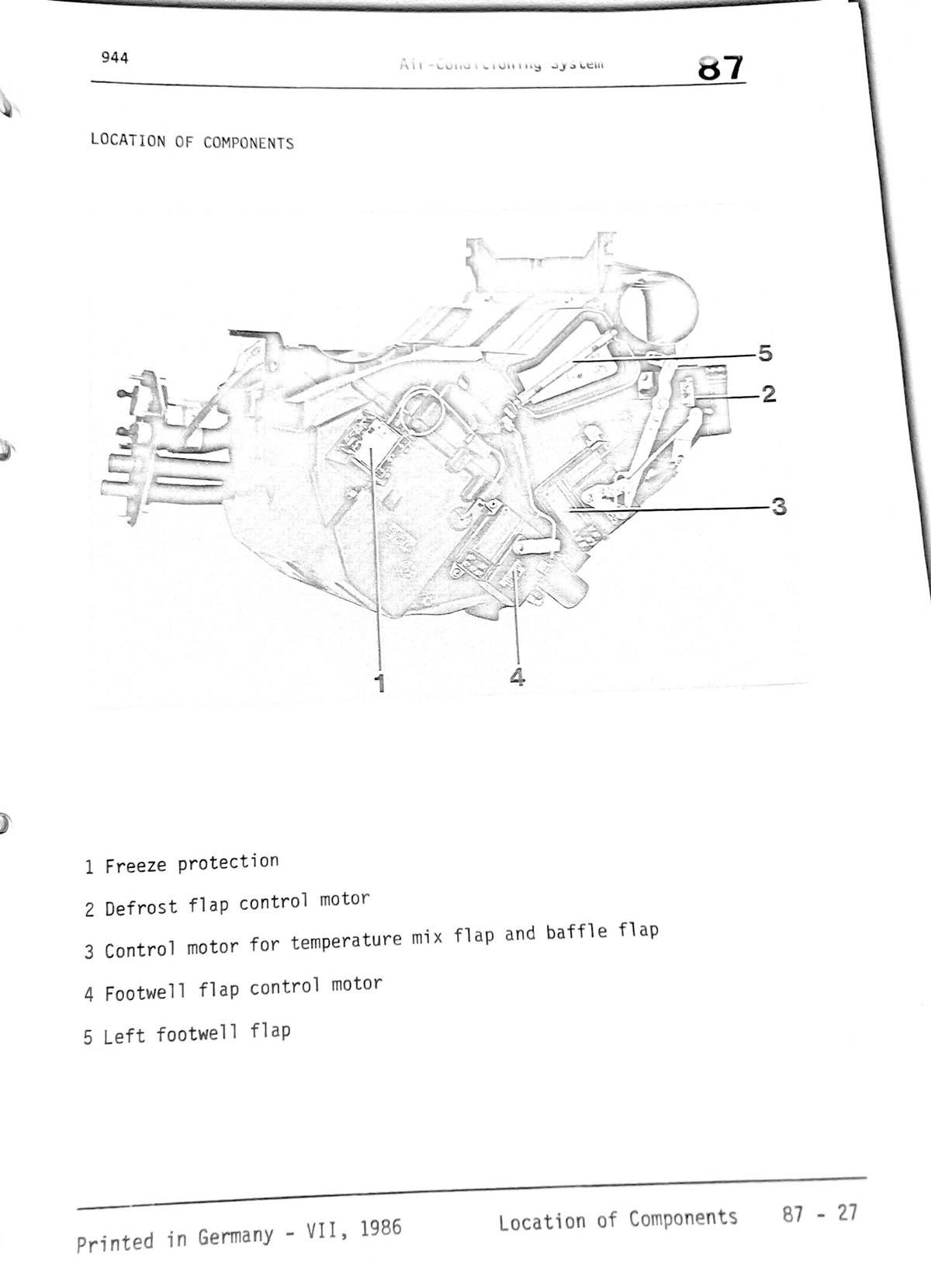

Just ran the test on the defroster flaps. I did not hear the flap move, but the resistance went from 2,150 ohms to around 90 ohms. Then back to 2150 ohms. I took a look at what I believe is the servo for the defroster flaps. Is this it? If so, it did not move.
I also noticed this lone connector in the CCU area. Not sure what it is, or what it would connect to.
The compressor is brand new, and I hear/feel it kicking on when I hit the AC button. I am putting off checking the vacuum lines for the heater valve since the valve itself is buried by the firewall. Frankly, I would know what to do to test it anyways.
Posts: 8982
Has thanked: 945 times
Been thanked: 4035 times
It's hard to get oriented to that picture but I think you circled the foot well flap servo. See diagram below. Odd that you didn't hear the motor move, yet the position sensor changed? Wonder if it's linkage has a broken clip, although I still think you'd hear it move. I'm not even sure that would create an always-hot situation, but if it's not working, then it would seem to be the leading clue. That connector is probably the cigarette lighter light bulb holder. See link below on that, along with another thread that gets deeper into the cc unit (or at least the version I'm used to seeing).
