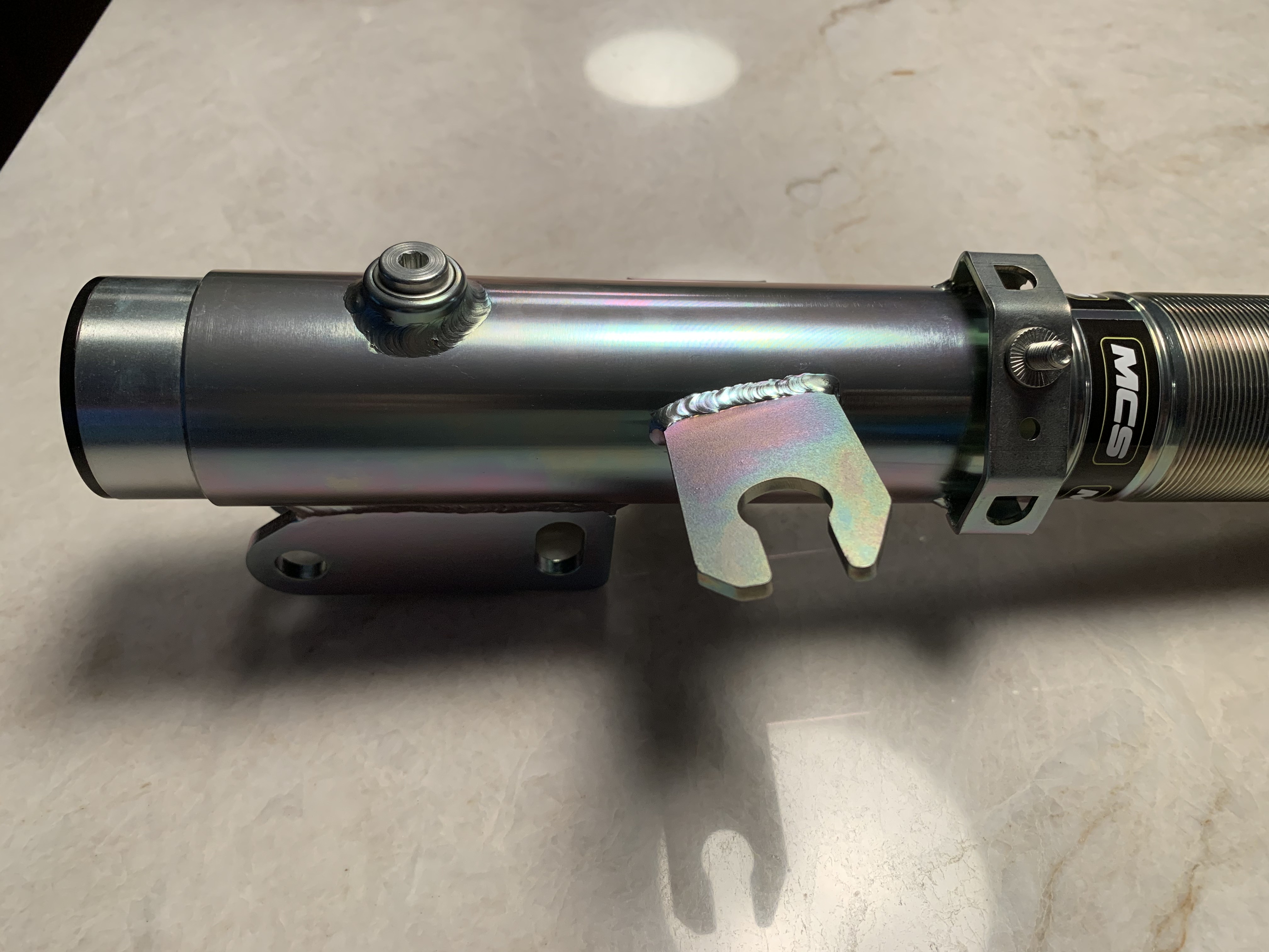

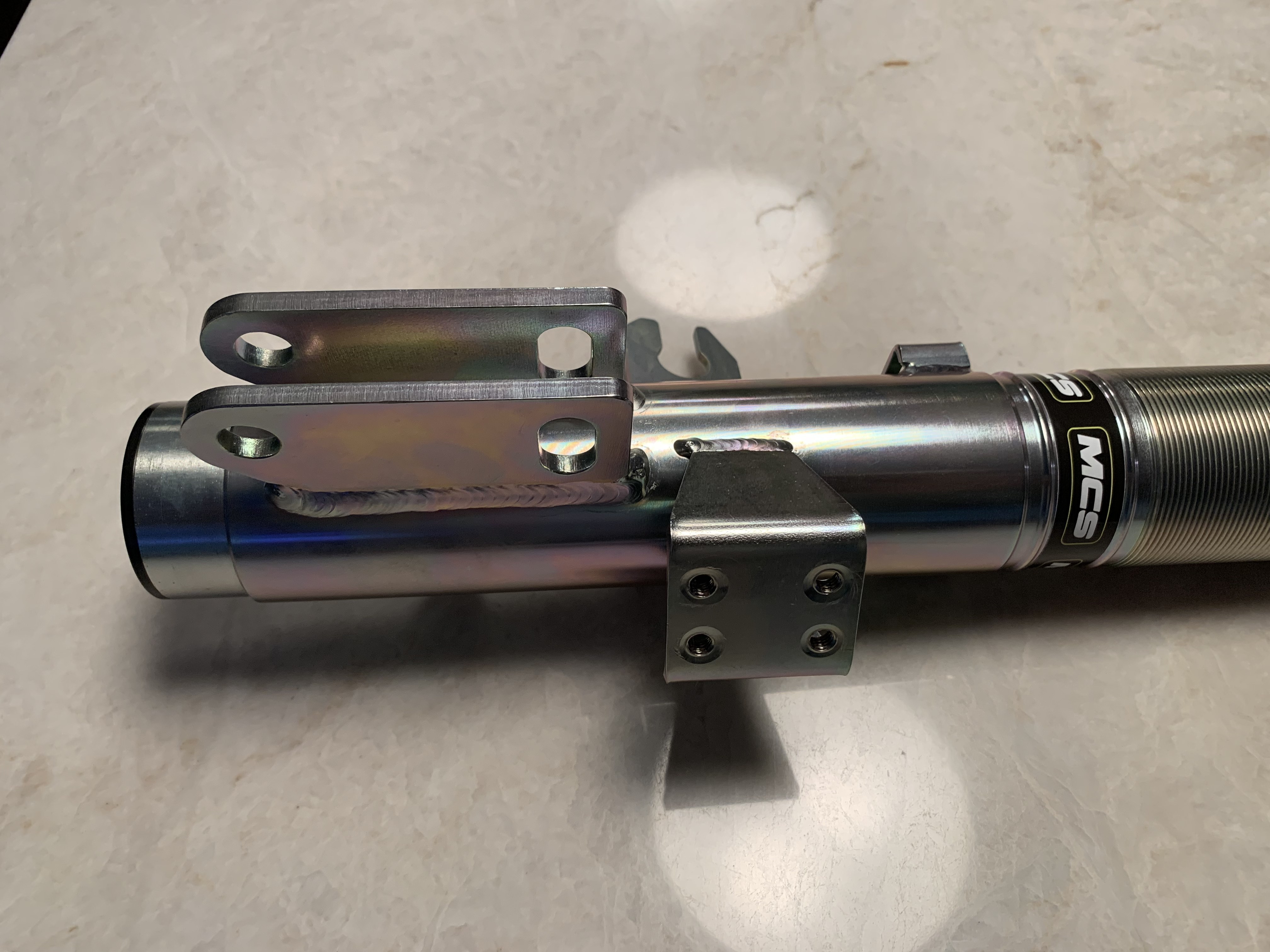

I have a full front/rear set of MCS double adjustable... but I haven't installed them yet. I've attached a couple of pictures of the struts to show they now come with all factory attachment points. These will replace the M030 on my 951. I'll be running 300#/in front springs, so the struts are valved for this setup. I've been told they will ride much better than the same rate springs on Koni double adjustable M030 type struts I have on my S2, and while the S2 is stiff I didn't find it to be that terrible when I drove it back and forth to work for years.crackership wrote: Mon Mar 06, 2023 1:52 pmI had completely forgotten about MCS, I'll have to look into them.AudiSport wrote: Mon Mar 06, 2023 12:49 pm If you're in the KWv3 price range, you can also consider MCS and Intrax.
Unfortunately, like most good things, the MCS is up there in pricing now. I purchased mine from Karl at Racer's Edge. I also have his camber plates on the S2 and a set for the 951. Those probably contribute most of the harshness with the spherical joints, but the handling is great.
The S2 also runs the 968 M030 30mm hollow front swaybar and adjustable rear 19mm bar; the 951 will have the new M030 solid bar in front and the same 19mm in the rear.
And both cars also have 18" wheels, so not your typical setup.
