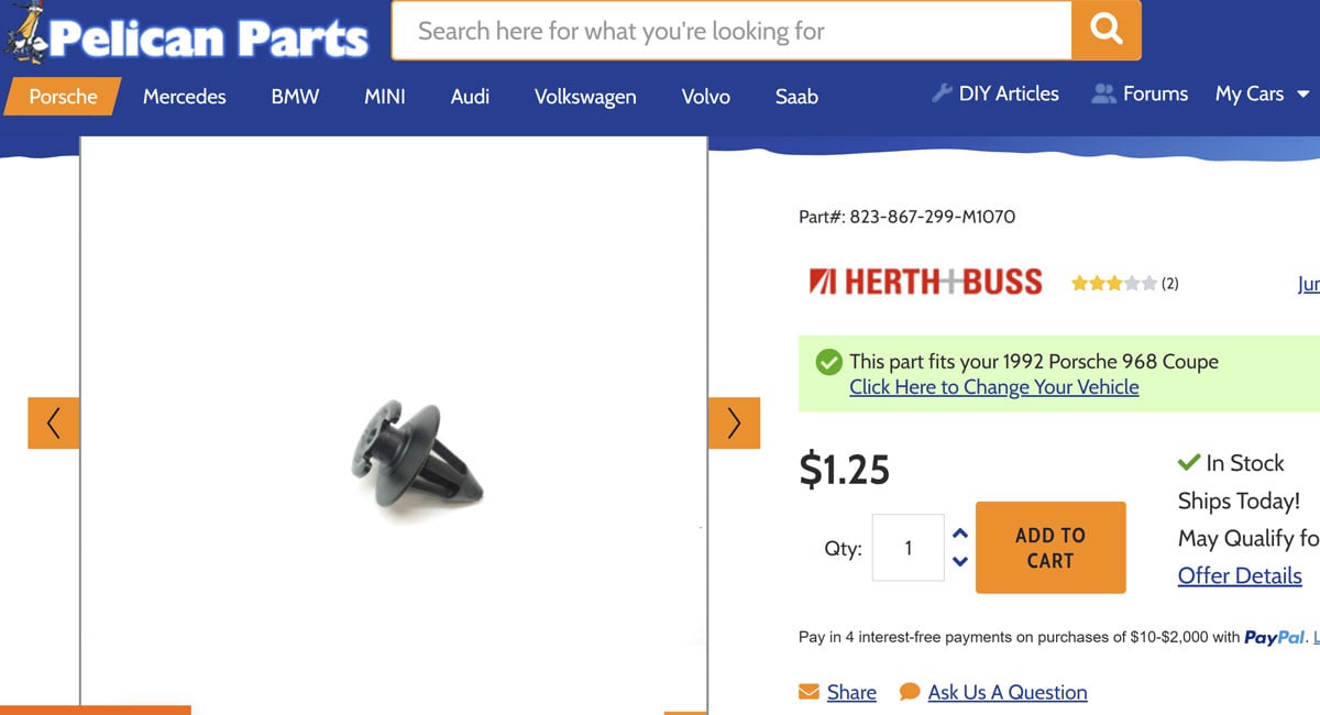

Meine44 wrote: Thu Jul 09, 2026 8:54 am Also, I would appreciate any help identifying two small pieces that I need to replace:
-The clip that holds the rear interior trim piece to the body of the car. Two are broken and one is missing. This clip holds the interior trim / leather side panel to the inside of the trunk.
-There is a hard-line clamp near the oil pressure sender that has disintegrated - the rubber is thrashed.
You can get those cushion clamps at a local hardware store, or amazon, though the ones Porsche sells are higher quality by a country mile (thicker rubber, thicker metal)... That panel clips are available, but you may need to re-secure them in the panels (JB Weld, etc.)... I 'think' your picture shows this style...
