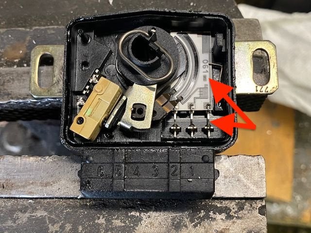

If the goal is to replicate the TPS... due in part to it being out of production and extreme cost etc... could we not just buy the more readily available units for BMW and others and transfer the inside parts into our original housings?
I am assuming of course that those printed boards are the same inside and the incompatibility lies with mounting or number of output pins etc

The trace board has a part number on it.. and there are only three connections to it? Perhaps one of the 3-pin connection TPSs have the same board (if any work as potentiometer like the 951s)
How about a call out to BMW and Bosch car owners from the 80s & 90s to open up their TPSs
And I suppose there is no way to re-plate those traces?
