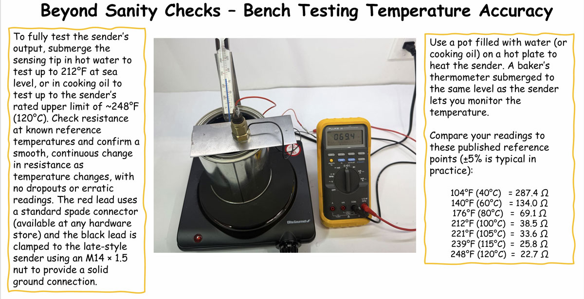

I'd strongly suggest you test the gauge sensor as shown below. This is the last page in out guide and the most accurate way to test it. If the sensor tests ok, then next we can show you how to test the accuracy of the gauge in the car. If they both check out, then at least you can have confidence in the actual temps and are not chasing ghosts. Based on your various comments, at least from this side of the internet screen, it seems like there is still uncertainty about your real temps. One the other hand, spitting up coolant and seeing steam is never good -- so I'd also want to pressure test your cooling system to test for any leaks, and look in the oil cap for any signs of mocha sludge.

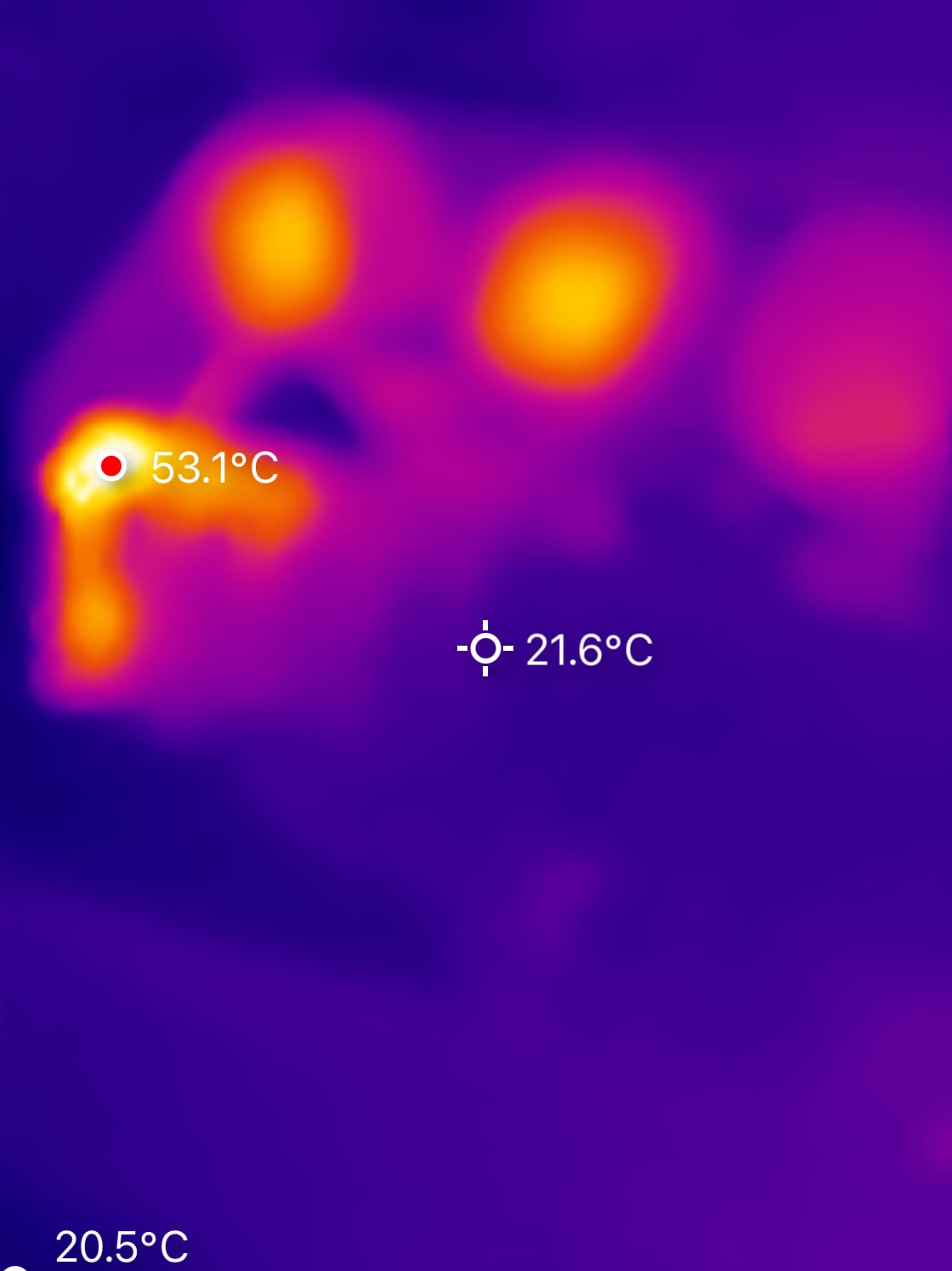

Have you checked actual temperatures at the sender, radiator inlet/out using an inrfrared temperature gun? These can be had for cheap---the inexpensive ones have limitations and one needs to be aware that different materials and colors can emit varying ranges in the IR spectrum, but one can establish a general trend by carefully tracing the cooling system according to the diagram in the link below.
http://www.clarks-garage.com/shop-manual/cool-10.htm
I have seen at my shop a couple of instances of slipping water pump impellers in 944/968 circa 20 years ago, we had a reliable rebuilder for a number of years, but that became less so . . . . have used only new pumps ever since (Laso and Geba brands have been good). But I would first be sure that the cooling system is truly bled. Is there hot from the dash vents with the heater valve open?
The advanced move would be an IR camera or attachment for your smartphone, I use this one several times a week at my shop:
https://www.oasisscientific.com/collect ... windows-pc
In addition to quickly establishing if there is cooling system flow, it can be used to detect a misfire on an engine with accessible exhaust manifold/headers (misfiring cylinder will have a much cooler exhaust port/runner), HVAC systems, and can also detect battery drains if the vehicle has been resting in a cool-ish shop. Check out the pic below of a '76 Porsche 930 fuse panel, I forgot to adjust the manual focus, but it shows how hot the single ceramic 25A fuel pump fuse contacts get from running both fuel pumps (can also see the round fuel pump relays above). To prevent forest fires and decrease voltage drop in the fuel pump circuit, I rewire this circuit to bypass the old fuse block and use heavy-duty inline blade fuse holders straight from the battery positive terminal to each of the fuel pump relay terminal 30 wires:
