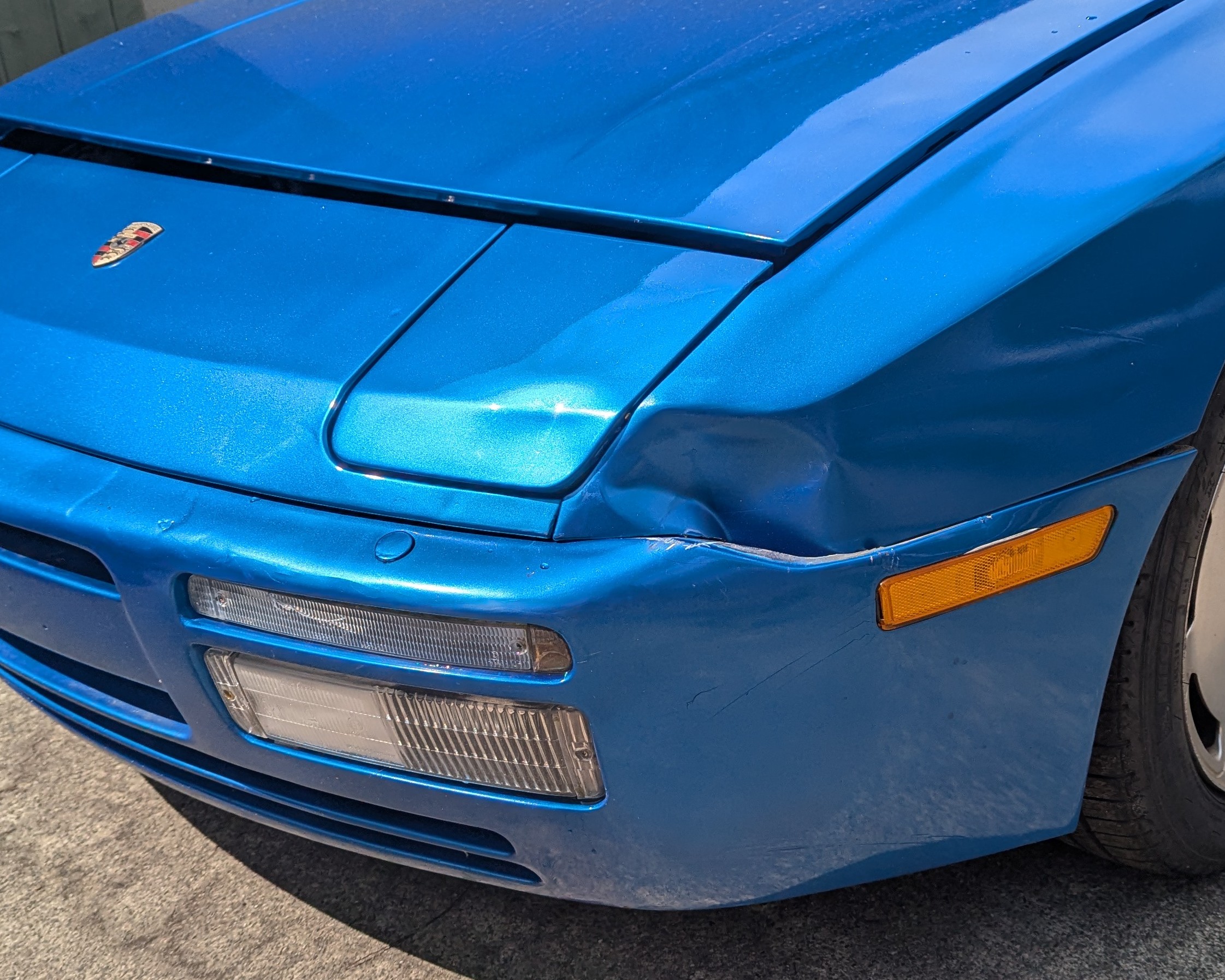

My neighbor/landlord struck my parked car in my driveway. The front corner is smushed, obviously.
That damage aside, I'm concerned about what happens when a car parked with the transmission in first gear is hit hard enough to roll the car back about two feet. It left no indication of skidding those two feet, so I'm assuming it rolled those two feet.
