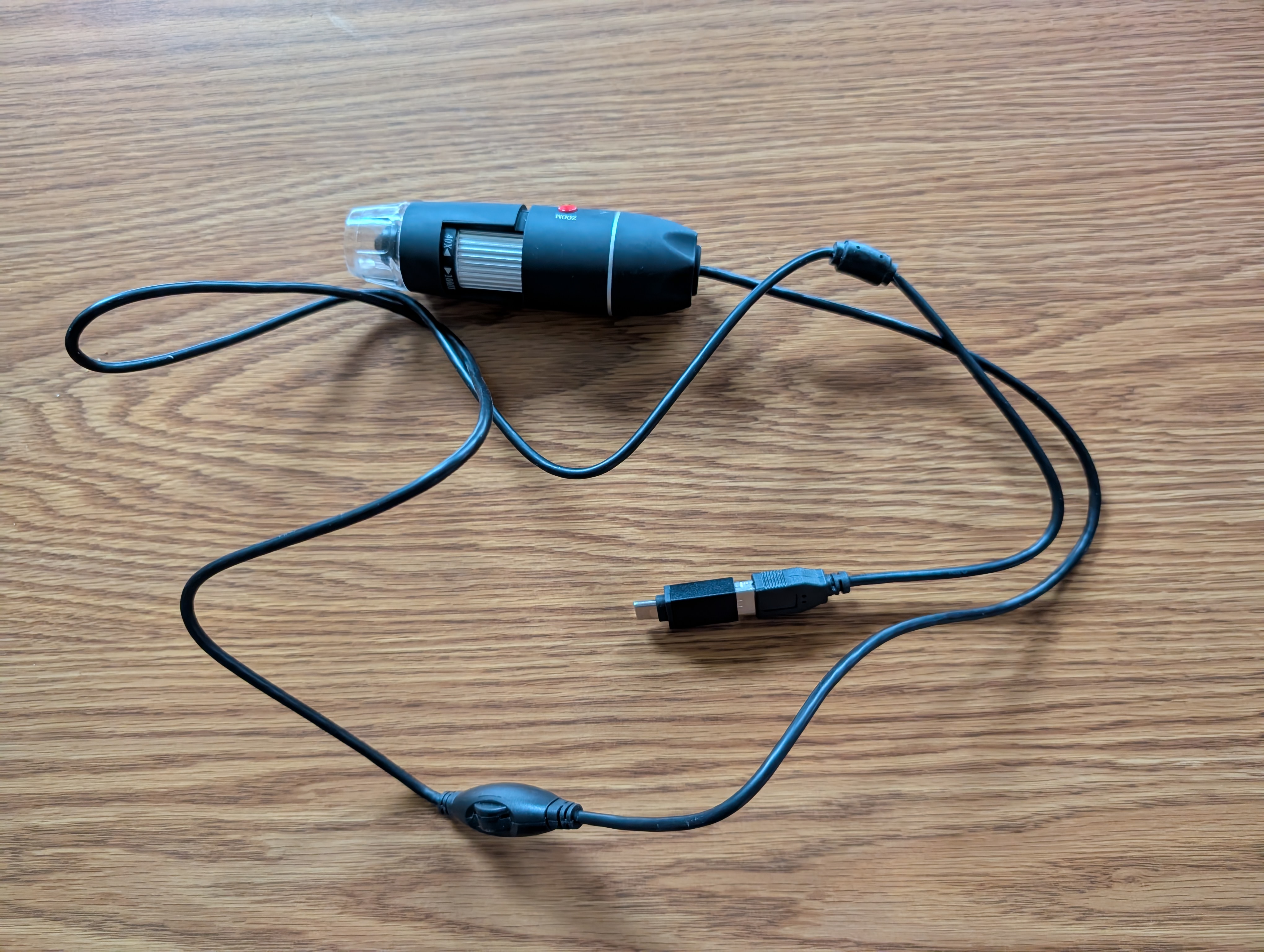

For those of you who are not familiar with dye penetrant testing, it involves spraying a special red dye on a metal surface to be tested, letting the dye remain on the surface for 20 to 30 minutes so it can penetrate into any cracks, wiping the surface clean of any dye, spraying the surface with a special developer which is white in color and designed to pull the dye out of the cracks, and then visually examining the surface. After about 5 minutes, cracks, if there are any, should show up as a distinct red line. For the microscopic examination, I used a handheld digital microscope (see photo) that will supposedly magnify 1000x. I don’t know if that is true, but I do believe I got at least 800x. This device is relatively inexpensive (if I remember right, it was less than $50), easy to use, and has been very useful throughout my rebuild.

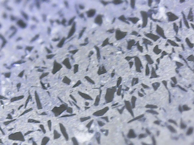

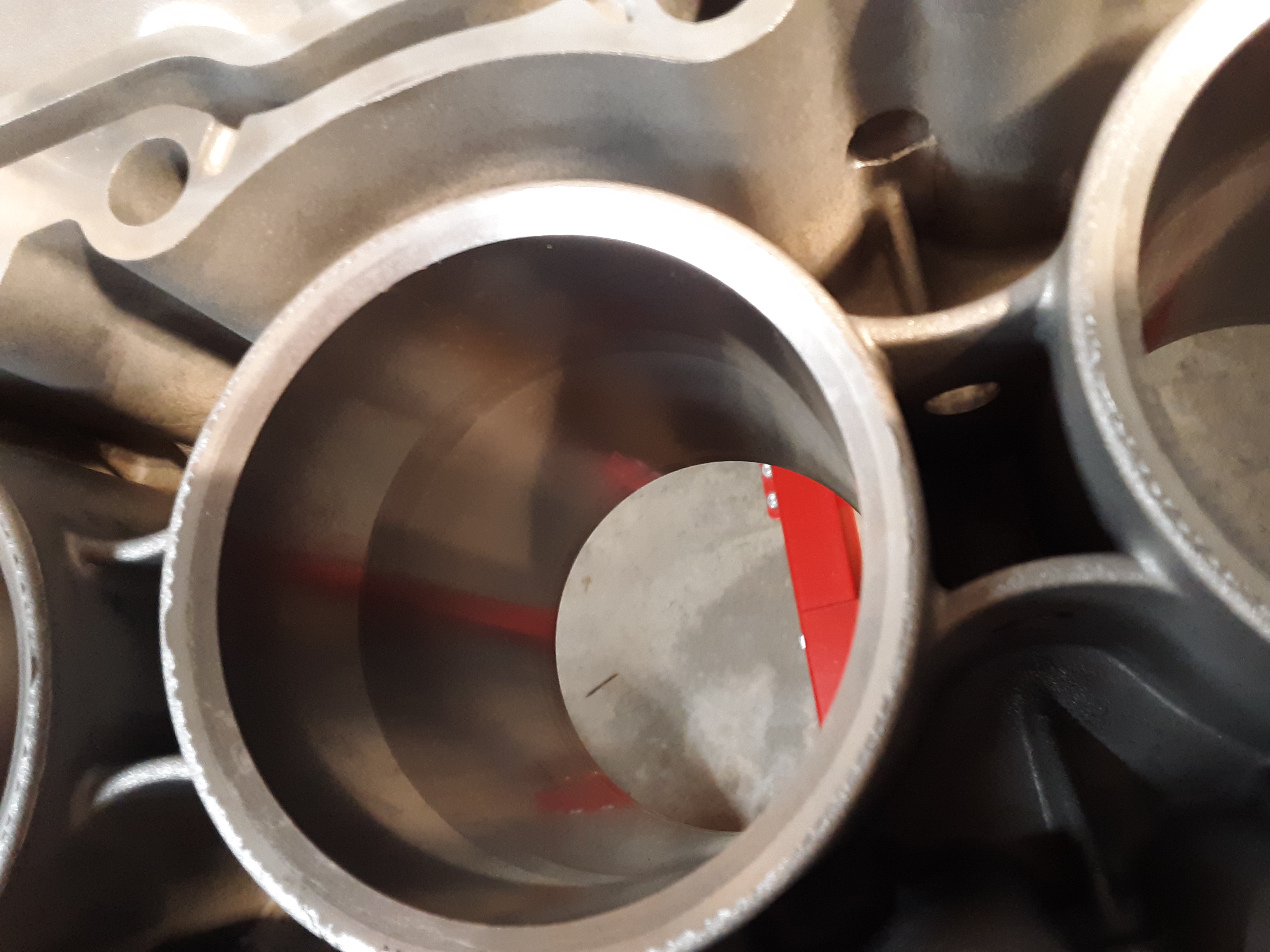

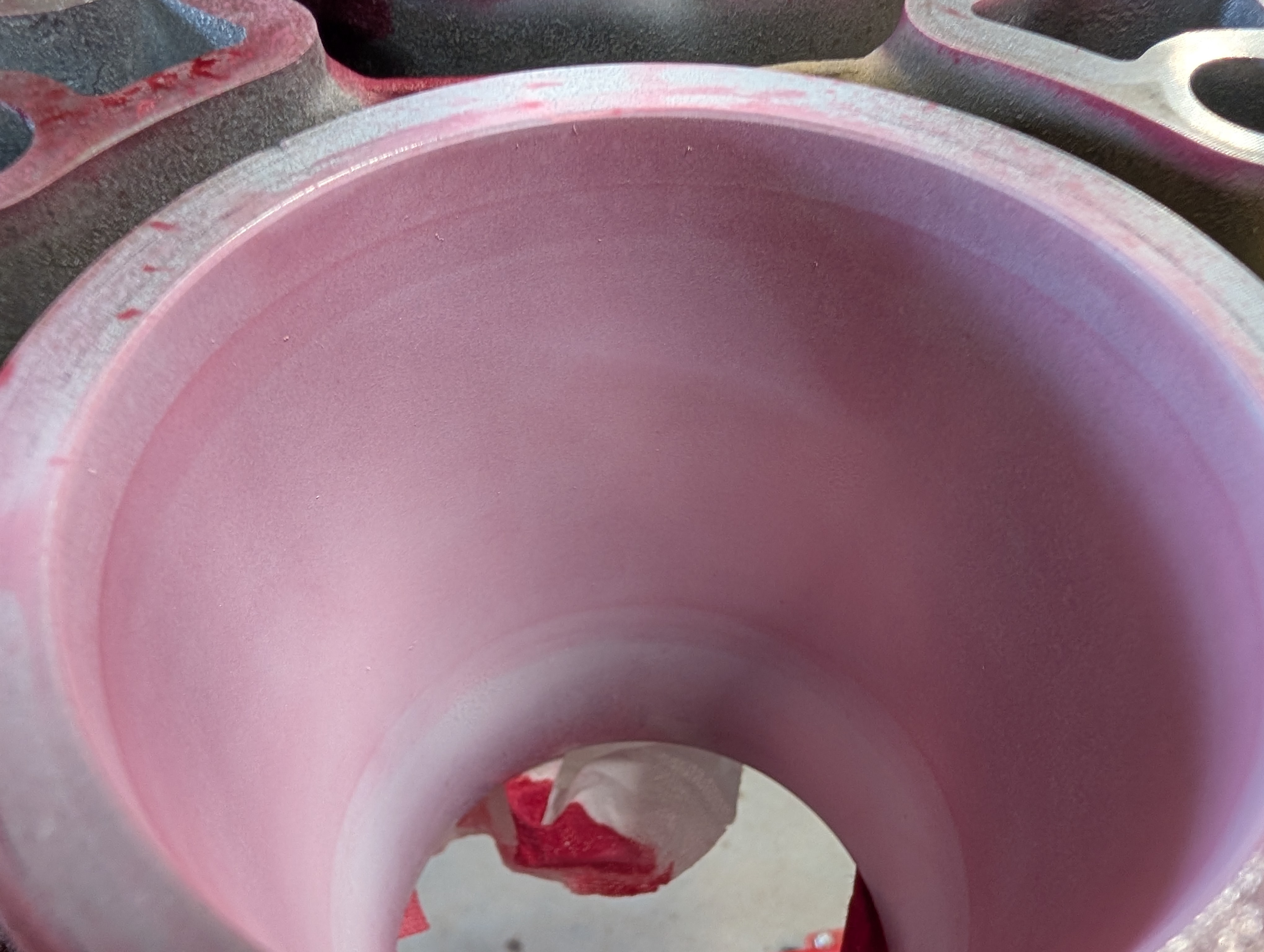

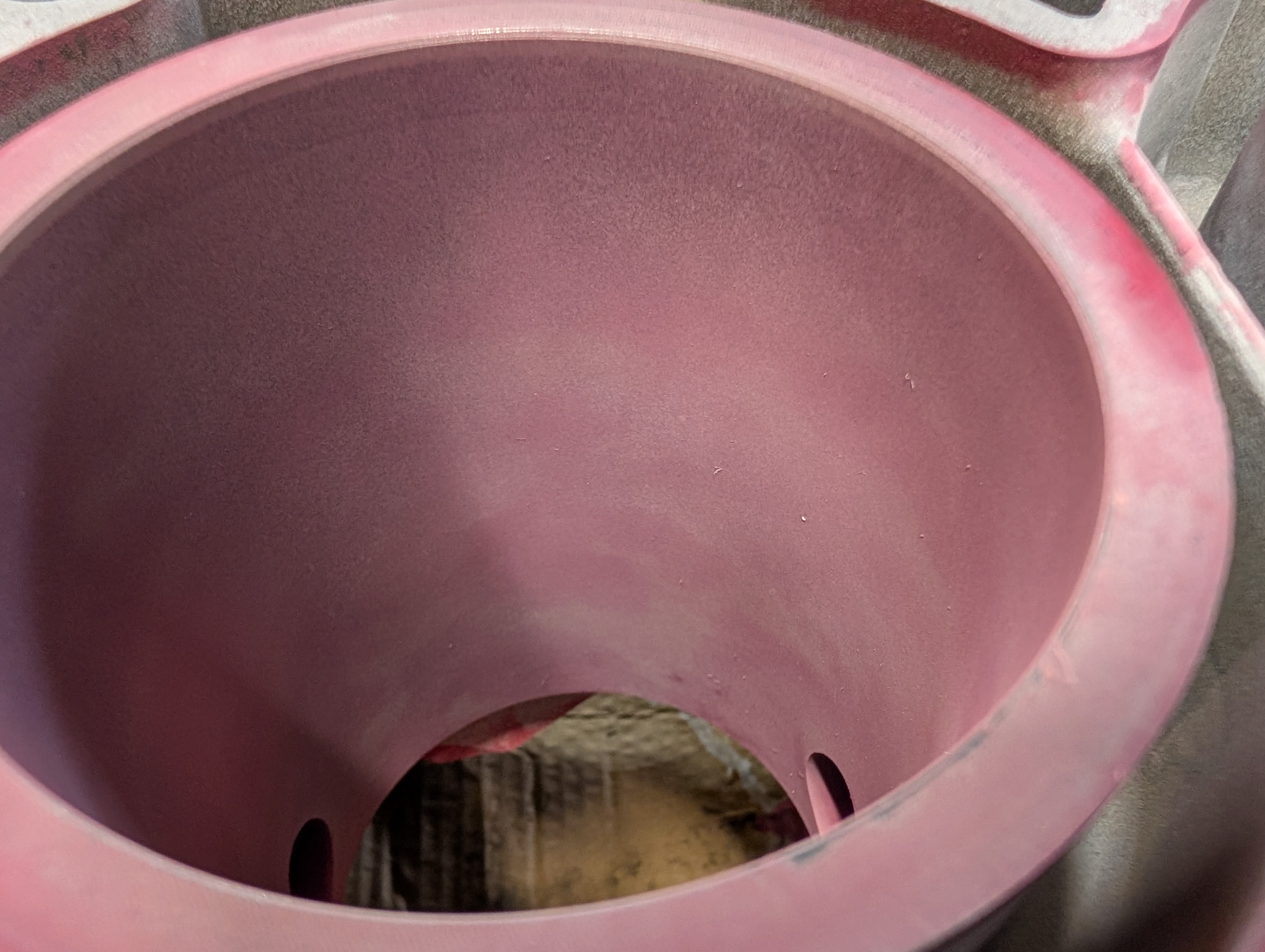

The next photo is of one of my typical cylinders after ultrasonic cleaning. There is no visible scoring, and my untrained eye thinks it looks pretty good for 80K miles. The next photo shows a typical cylinder after application of the dye penetrant test. I did not see any cracks. One cylinder, however, did show an anomaly (next photo). This photo shows two dots near the bottom of this cylinder. I was not very concerned about this because it clearly was not a crack and the anomaly was near the bottom of the cylinder, but I was curious. After cleaning the cylinder, I used the microscope to examine the area. I found nothing with the microscope, so I figured it was just a contamination of the process. The next photo shows what I see when I examine the cylinder wall with the microscope. I would think that if there were a significant crack in the cylinder wall, it would be visible with this magnification.

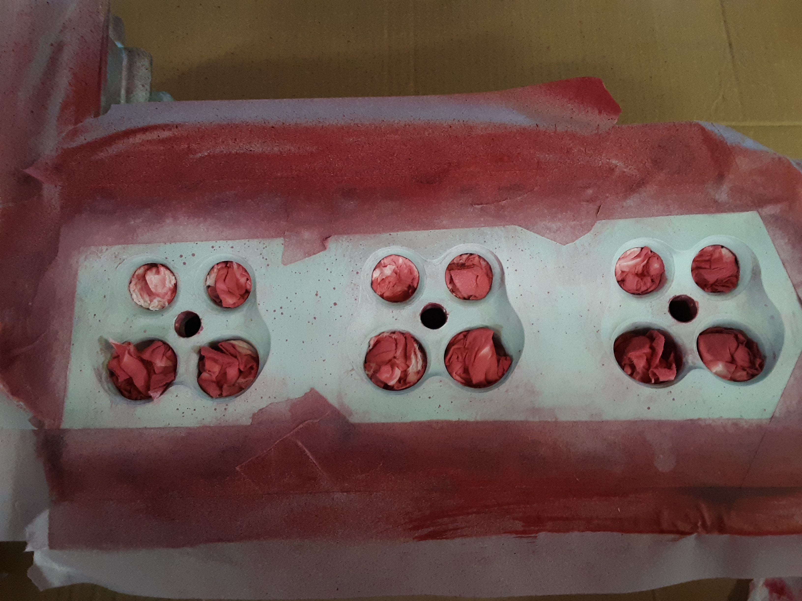

I also examined the heads, as shown in the next photo. I detected no cracks. I have read that these heads can experience micro-cracks. I do not, however, know if these tests can detect those cracks.

Handheld digital microscope
Typical cylinder after cleaning
Typical cylinder after dye penetrant test
Cylinder with dots showing near the bottom
Cylinder surface at approx 800x magnification

Dye penetrant test of head
