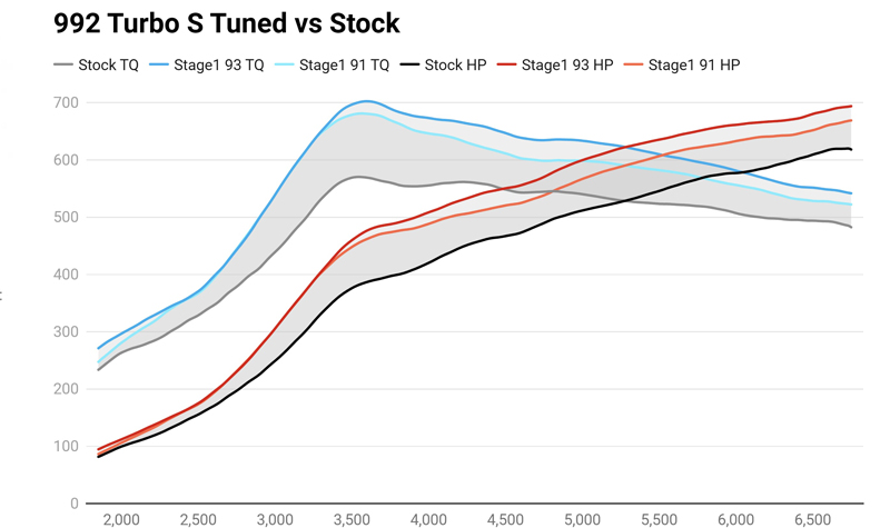

My 2021 will be coming off warranty next spring, and I'm starting to mull the idea of getting the Stage 1 (91 octane) Cobb tune for the car. Cobb seems pretty reputable and I have not heard of a lot of engines blowing up from their tunes. Cobb's tune is CARB approved, meaning it's smog legal in California, which is critical for me. I spoke to the Cobb rep at length at this summer's Werks Reunion and he pushed to get the 91 octane tune since that's what we have in California (despite living .9 miles from a gas station that sells 100 octane). The 91 octane tune is good for over 100 extra foot pounds of torque and almost 50hp.
Will it reduce resale value? Will I blow up my motor? Will it disrupt the balance of the car? Does any rational human need a car to be faster than a 992 Turbo S? Should I just wait until the next gen Turbo? Can the drivetrain handle it? My inner teenager loves the idea of adding 100 ft lbs., but my inner sexagenarian wonders if I'll black out if this car gets any faster.
Anyone here have any experience with Cobb?
Cobb Tune my Turbo S?
