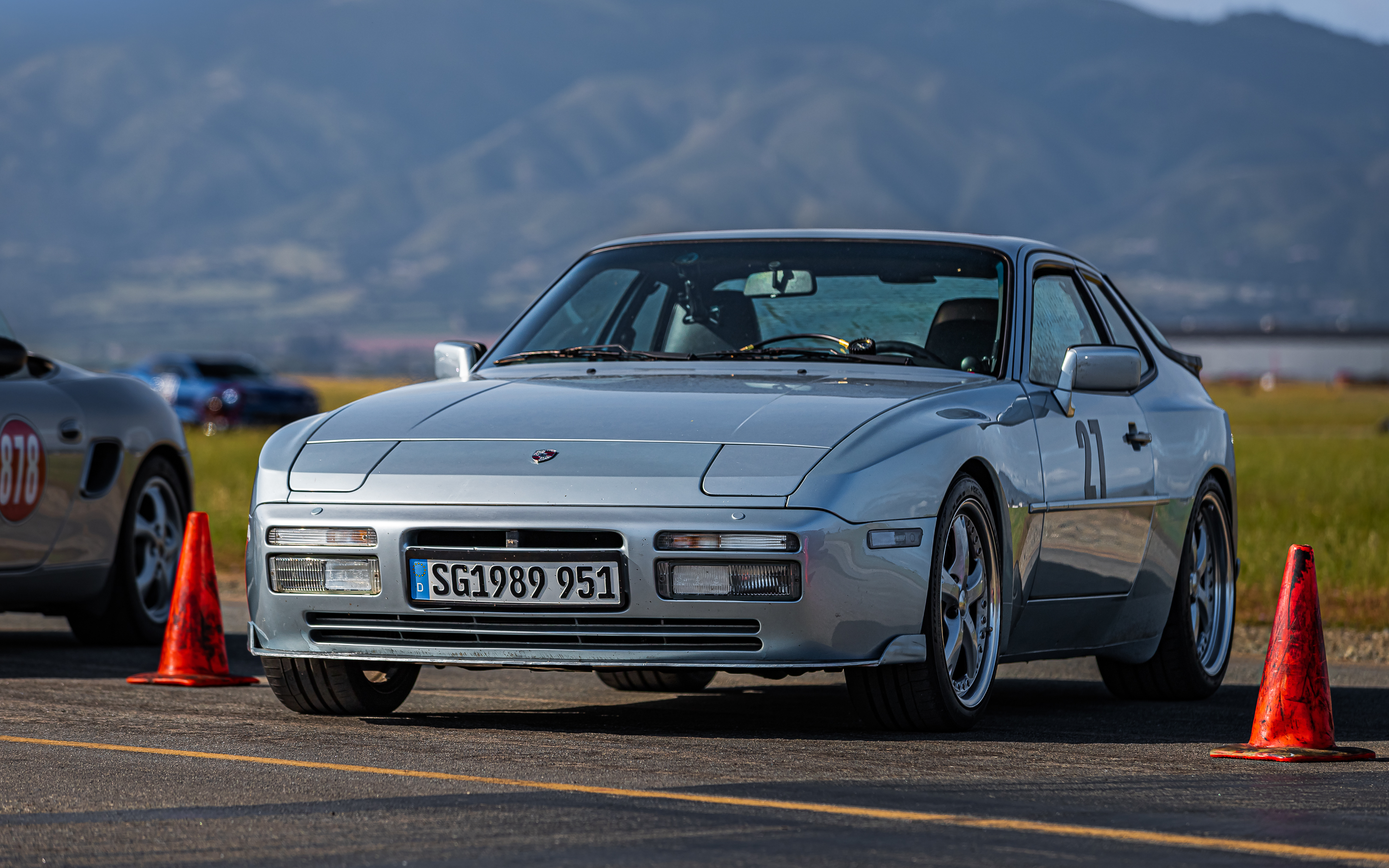

I have been occasionally autocrossing with my local PCA since 2008, usually 2-3 times per year just for fun. I currently have aftermarket OZ Racing 18x8.5 and 18x10 rims with Continental ECS 235 in front and 275 in rear. They're great tires for street use and are ok for autocross.
Here's my dilemma: I want to be more competitive this upcoming year and get a better tire setup for autocross and I am debating these two options because cost is a concern.
1) Use my stock club sport forged rims- 16x7 and 16x9, and then get the ONLY tire option available, Yokohama Advan A052 in the stock 225/245 sizes for around $1k.
2) Find some used 17" rims and then have more tire options, but overall spend more money.
Money is a constraint because I AM a married high school teacher!
So, I am asking for opinions because I keep going back and forth between the two. Especially because of looking for used 17" Porsche wheels that are cheap...
Autocross: stock rims + tires or new rims+tires?
