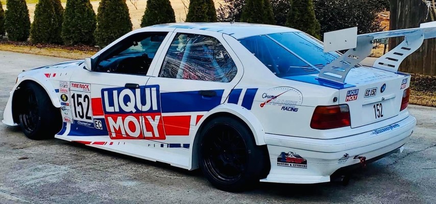

We had a bit of sponsorship from LiquiMoly when we were running WRL & ChampCar. They were good to us and great to work with.
