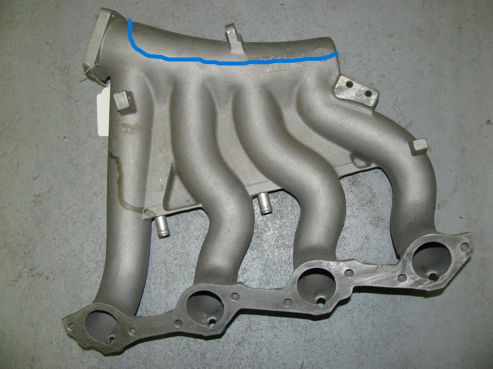

Here's another thing I did on a few 951 intake manifolds which seemed to work well: I'd cut the 951 plenum in half to access the individual inlets. I'd rework the inlets to give them a more radiused entry, then weld the plenum back together. Admittedly, I never did a back to back test, but these engines made good power with tuning.

michaelmount123 wrote: Wed Jun 26, 2024 4:23 pm Here's another thing I did on a few 951 intake manifolds which seemed to work well: I'd cut the 951 plenum in half to access the individual inlets. I'd rework the inlets to give them a more radiused entry, then weld the plenum back together. Admittedly, I never did a back to back test, but these engines made good power with tuning.
I've seen that done where they take a big section of the top off, leaving the throttle body flange in place. That apparently gives enough room to open up the ports. Have any pictures of where you cut?

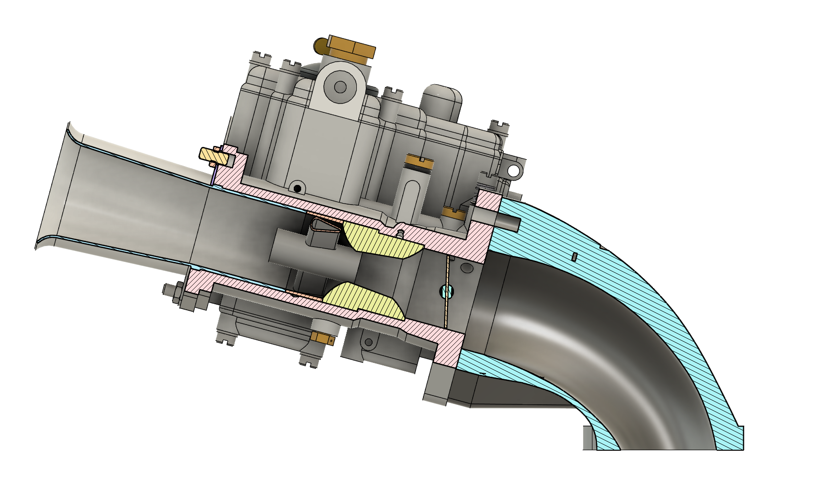

Here's what's going on in New Zealand. The intake will be CNC machined to fit an ultra modern fuel/air mixing device that uses no electronic control. Currently finalizing design detail. The mismatch at the intake entry will be addressed.

"Ultra modern fuel/air mixing device that uses no electronic control" Almost sounds like a carburetor Michael. Glad to see someone is working with your design and developing it. Our neighbours do some good stuff across the ditch.

Tom wrote: Wed Jun 26, 2024 6:50 pm
This is approximately where I cut, Tom. I didn't disturb the TB flange.
