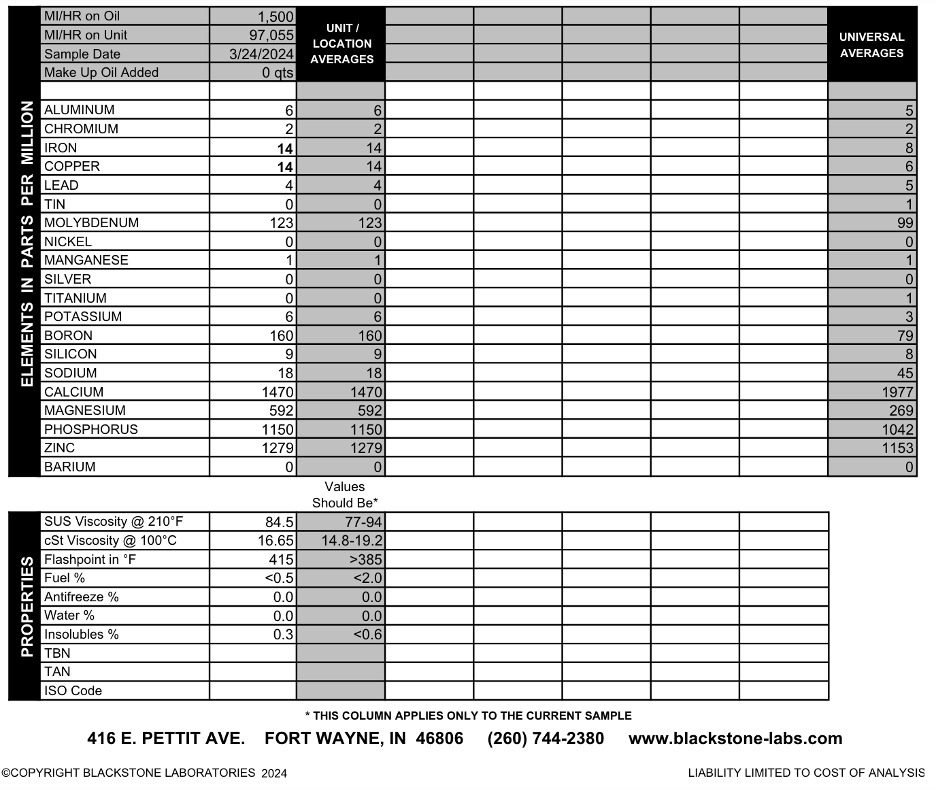

Hey folks - just to add more info to the thread and not leave it open-ended, I received the oil analysis results from Blackstone Labs. Here is the summary:
The first sample out of your Porsche 2.5L features a bit more iron and copper than typical of this
engine type. Compare against the averages on the far right. Those are based on around 2,500 miles on the
oil. Iron comes from steel parts like cylinders/shafts. Copper could show a little extra wear from
brass/bronze parts like bearings/bushings. The rest of the wear metals read within fairly normal ranges, and
these levels aren't so high that we'd immediately assume a problem. No contamination found. If the engine
runs well, just resample to monitor wear.
